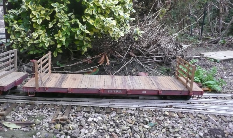

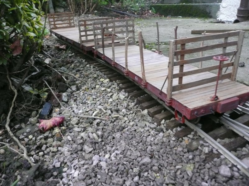

Thought you guys might want to see too. Models of EBT flat cars. #63 is a 29.6ft and #88 is longer 33.4ft. Both these featured end gate for transporting paperwood. Pete did a much more detailed version than me a while back. So did Kevin, Kevin provided me with the info of lengths for these cars and numbers. Bruce’s very neat wooden hoppers inpired me to do someting in wood. I used the Wayne Spence drawings for #63 and drawing posted here by Jon for the #88.
The frame was a lengthened plastic one
Steps were cut-out and drilled
Painted and weathered
Stan Cedarleaf did the decals and they seem to blend in nicely. The wooden top was a very difficult to do. I used wire wool and vinegar, at first is turned the wood green! So it took lots of goes to get it to look decent. I don’t think I left enough time for the rust to form before applying. The planking- coffee stirrers were a pain too, warped, different sizes, ect. I tried to fill the gaps with Titebond glue. but the rust mixture made the glue darker brown, despite me sanding! The couplers will be installed soon hopefully. Alec.
Excellent work Alec. Those look real good.
Nice build Alec. Those coffee stirs look like they came out pretty good in spite of what trouble you had with them.
Nice job, Alec.
The coffee stirrers are cheap. So I sort through them to find equal sizes and toss the warped ones.
Thanks- yeah I do have to sort them out, but they always seem to get through when I am trying to glue them!
Alec.
Alec they look great. I usually weather my wood using a wash of the acrylic paints mixed with water. Just brush it on until you get the look you want. I even add a brown wash with the black. It looks fine with were the wood is seperated. It gives it a more worn look.
2 beautiful freight cars… :slight_smile:
Very nice ! Glad the plans were of use.
Thanks for the kind words!
Shawn, I used water and acrylics for the painted wood, but not on the deck- another idea to try!
