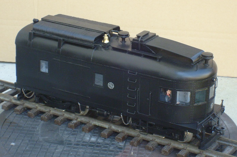

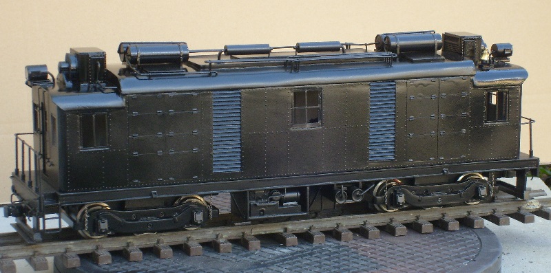

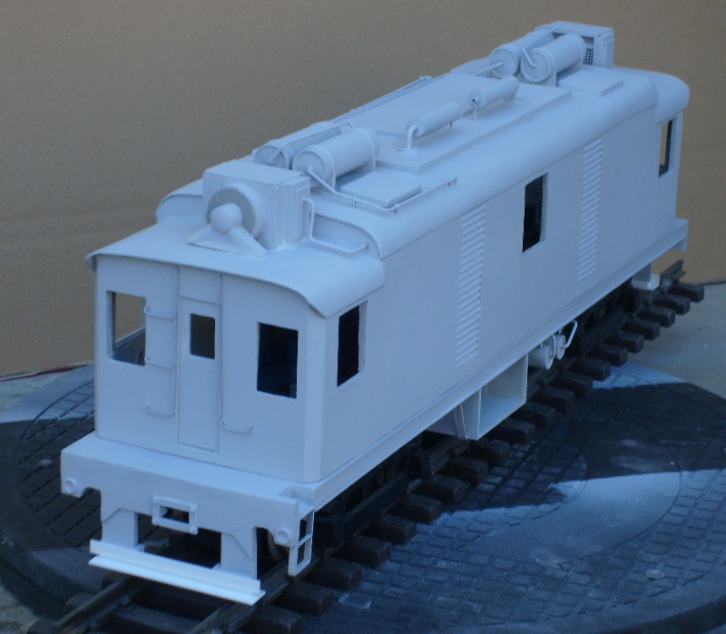

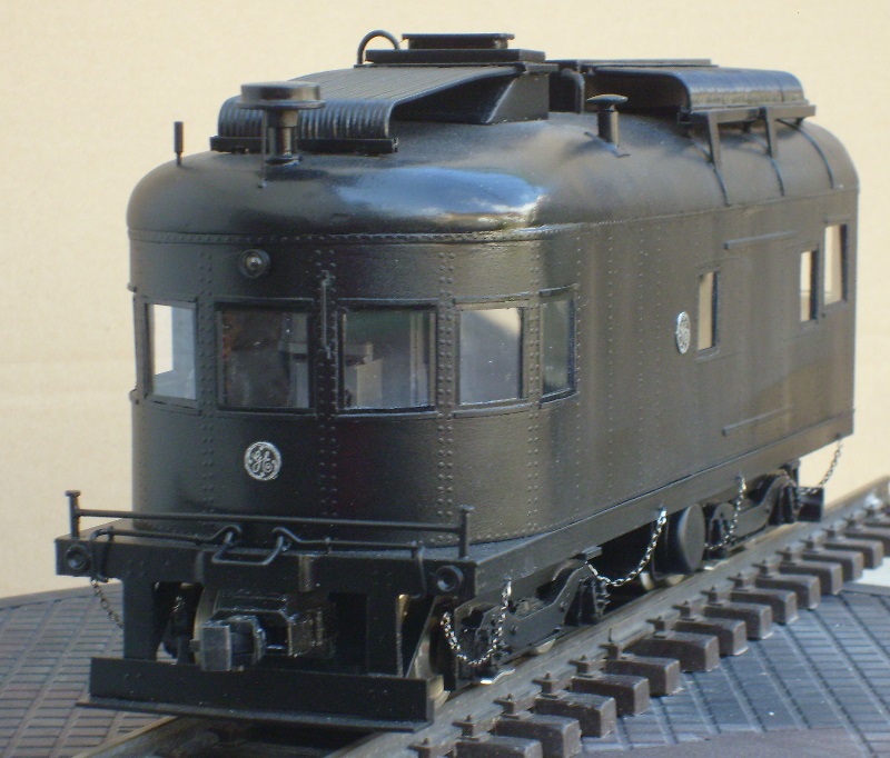

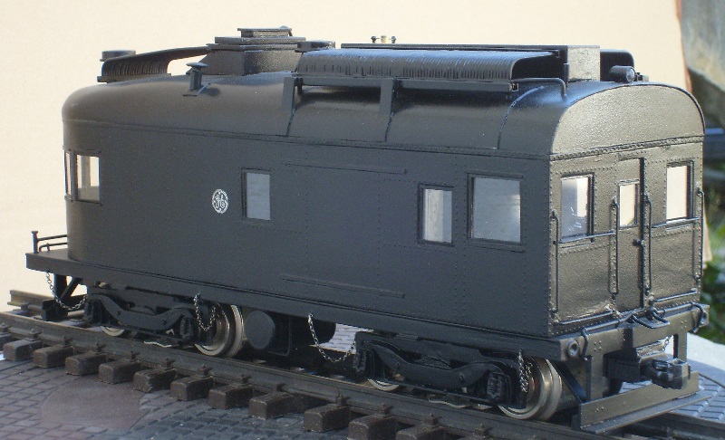

Some progress on #8835
Meanwhile I’ve removed the added side panels - I followed a wrong interpretation of the photos.
Regard
Norman
Regard
Norman

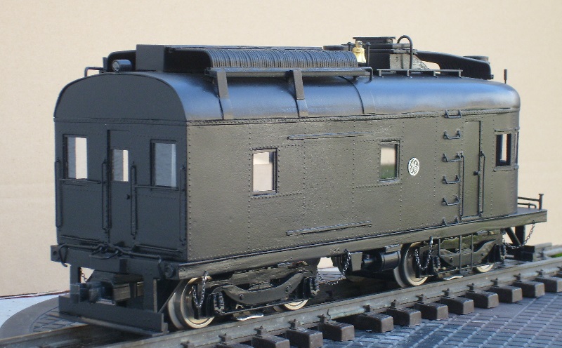

More amazing work!!! How did you do those radiator tubes?
Hi Bruce,
The tubes are made from 1/16" brass wire - inserted and soldered into a slot in a H-shaped section of brass.
Regards
Norman
Hi Bruce,
The tubes are made from 1/16" brass wire - inserted and soldered into a slot in a H-shaped brass section shape.
Regards
Norman
Oh yeah…nothing to it, right? (https://www.largescalecentral.com/externals/tinymce/plugins/emoticons/img/smiley-foot-in-mouth.gif)
They sure do look good. Nice job.

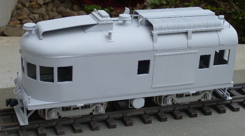

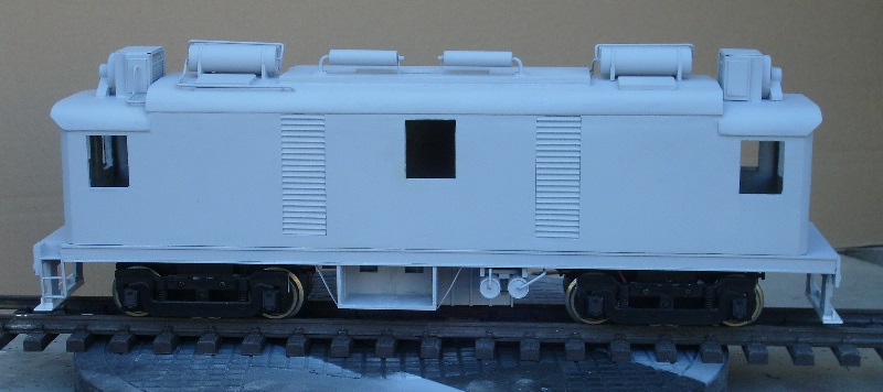

Some news on the several diesel projects:
GE-demonstrator
RI #10000
Started with one of MILW’s shop-built motor cars #5900 / #5901
Meanwhile RP-210 is in the paint-shop

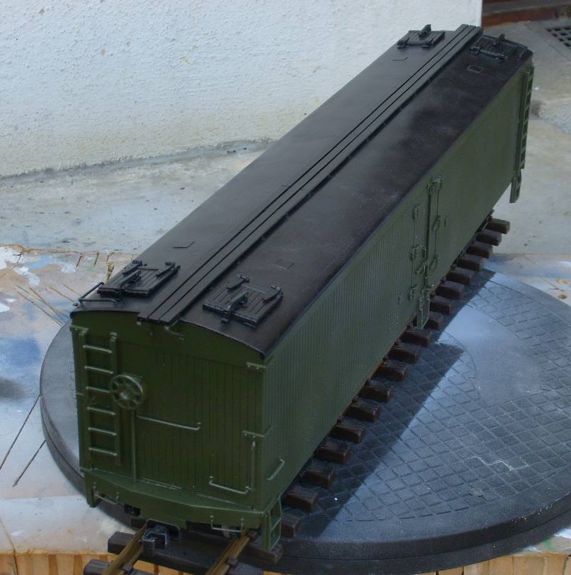

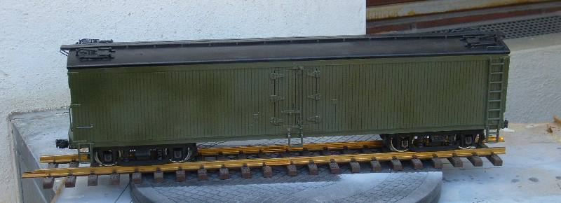

As a quick interlude built a 53’ wood express reefer for additional head-end traffic
Regards
Norman
OMGram …![]()
I wouldn’t consider it an highlight in streamline-styling - the nose looks really like an ugly bulldog. MILW should rather have spent some money for a professional designer than to try it doing by themselves.
Probably its uglyness is the reason that none of the brass builders ever made one.
I built the shell from joined FA/FB-shell - however, the trucks give me some headaches since they are of an A-1-A type with a rather small wheelbase of 13’ or so (and rather unusual positions of springs).
Regards
Norman
