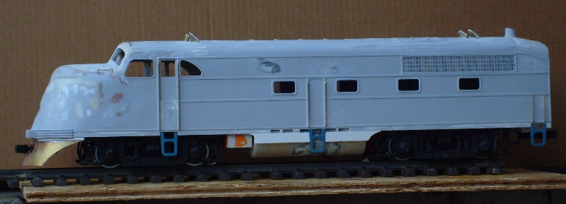

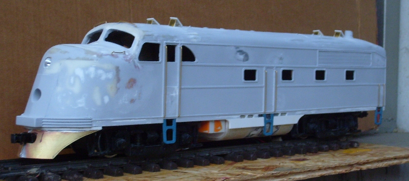

Said this, here’s my current locomotive project - a late Rock Island TA (mid 50’s). Main modifications in comparison to the delivered design are removela of the trucks’s skirts, a fixed front coupler applied, additional air intake scoops on the roof and a modified / simplified paint scheme (the latter will become significant in the far future).
As a starting poin t I used an Aristo FA (a basket case from eb…)
Here the modified front is applied (styrene subconstruction - was coverd with glassfibers&resin later on
Current status
The TA is very close to Greg’s favoured Santa Fe E1…after proving that such a nose modification isn’t that difficult I may tackle this next (and yes, an ALCO DL 109 is on my ‘wish-list’, too).
