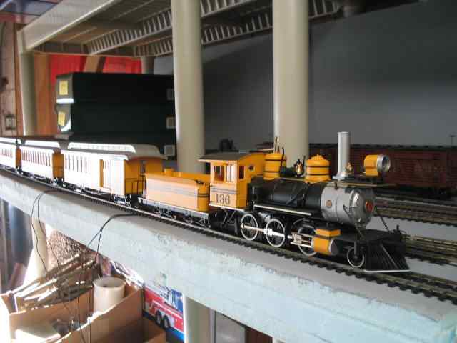

The 0n30 runs on HO gauge track.
(http://www.trainweb.org/rgs/0n30_01.jpg)

On3 it the correct gauge. On30 is the fudged gauge. What’s the difference? Less than 3 mm. If you’re a prototype rivet counter that’s a big difference. If you’re like most of us than its not.
Lots On30 locos are upscaled HO or based on HO power trucks plus the Bachmann offerings. Peco makes On30 track.
