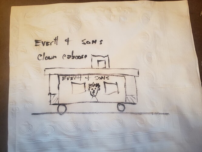

Devon's 2026 MIK Everett and Sons clown caboose
This will be a continuation of the 2025 MIK where I built the first car in a circus train for my grandson. Since its a whimsical theme what could be more whimsical than a crazy clown caboose.
I haven’t quite decided if it will be a kitbash of a bobber or a scratch build. Leaning toward a full scratch build.

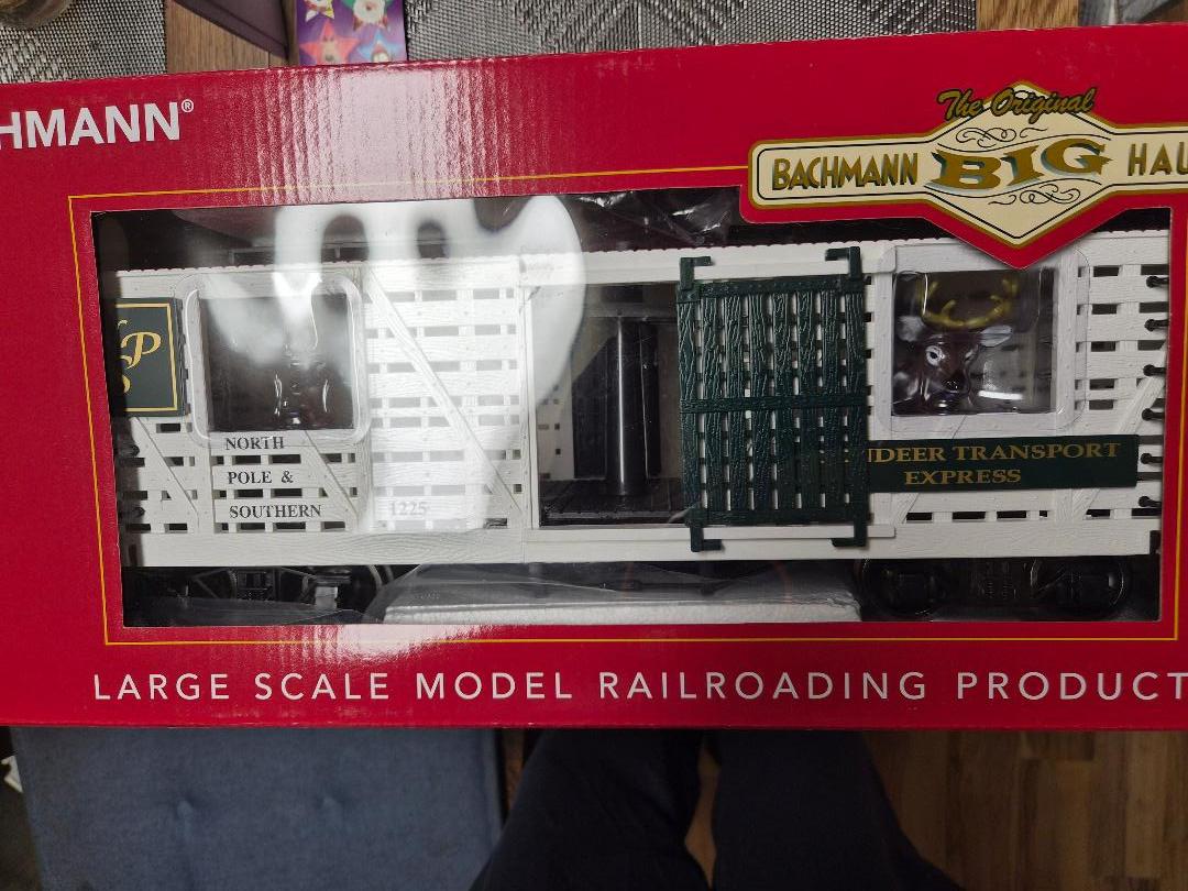

So Bachmann has a few animated cars. This one, Christmas car, has 4 Reindeer mounted on a floating pivot arm. When it moves down the track, the Reindeer bob in and out of the windows.
4 clowns bobbing in and out of the windows?
Interesting idea and goes along with one animation i already have in mind which im keeping a secret for now. But it could be incorporated if I can figure out how to do it. I’ve never done anything quite like that.
buy one
investigate it
break it
replace it by home made copy…
(but that might be above the budged)
Looking forward to the clown caboose build, Devon. You’ve set a high bar for yourself, I’m not sure you can get a bigger smile than the one on Everett’s face with the boxcar from last year :wink:
There is no special drive, just a plastic arm mounted on a pivot in the middle of the car. The arm is balanced, so the rocking of the moving car, the animals/clowns move in and out of the windows.

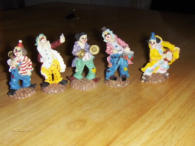

Devon, maybe you can swing something like this for the figures, and focus on the car stuff?
Cliff that would be more durable than sculpy
Not exactly what I’d call extensive progress. However, the side frames will probably be the part that takes the longest to make. I am taking 12 gauge romex wire and stripping out each solid wire. Then hammering it flat. I have some brass stock that I will use for the journals, and then some flat copper sheet material for the journal “plates”(???) Not sure what those pieces of cast iron are that the journal rides up and down on and also bolts to the wood frame. But at any rate this will be all fabricated out of brass and copper I have on hand and soldered together. Then attached to the wooden frame.
Really wish I had made that resistance soldierer about now. Gonna be tough to get it all attached. Without loosing pieces already attached. I think I have a plane to hold it all down with clamps and soldier it all at once. Unless someone has another idea on how to soldier a bunch of pieces together without melting the soldier already attaching other pieces.
Devon, no clue about the soldering, but, for the figures, hit EBAY and look for PLAYMOBIL circus stuff. Some of it, like LGB, has collector prices. Others go in reasonable lots. The stuff lasts forever, and it is fun for kids, too!
