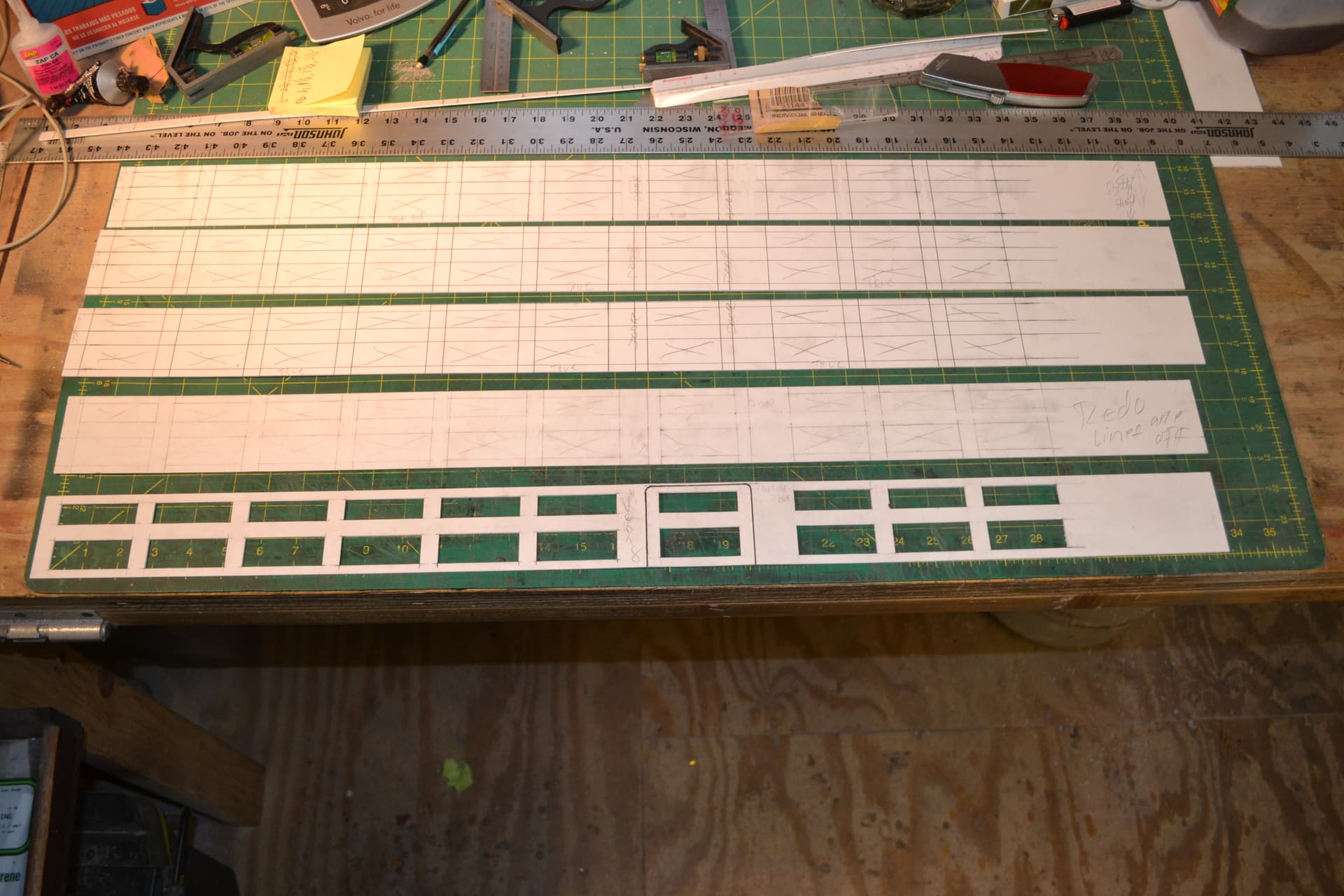

How does every body cut strips in plastic accurately ? I am cutting 1-3mm sheet. Measuring and marking does not work well for me. I mark and use a straight edge and sharp utility knife to cut it. I could use my table saw but that wastes a lot when I am cutting 1/4" strips. I have an idea and am going to make something today and will share it later, just looking to see what every body else uses.

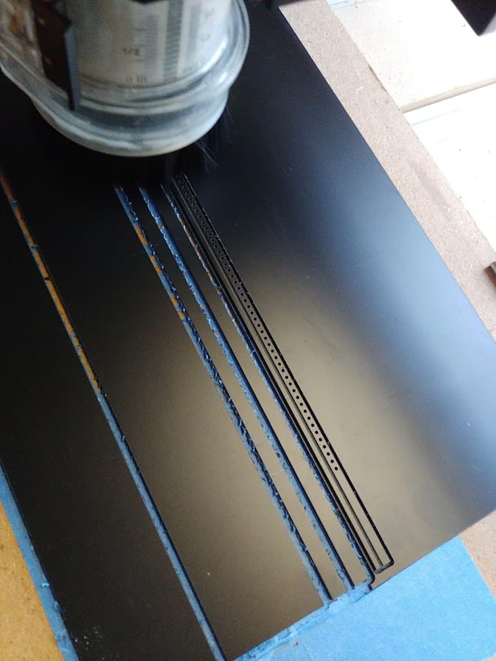

I use a CNC router. uniform parts with nice square edges every time! :smiley:

Haha. sort of. I apply painters tape to the bed and the bottom of the workpiece, super glue to the painters tape and press the workpiece to it. Works great for holding lightweight stock when you’d like to be able to cut close to the edge. Removes cleanly. Well, actually not so clean when you set the depth a bit low and chew into the first layer of tape as shown in the pic I posted :slightly_frowning_face:

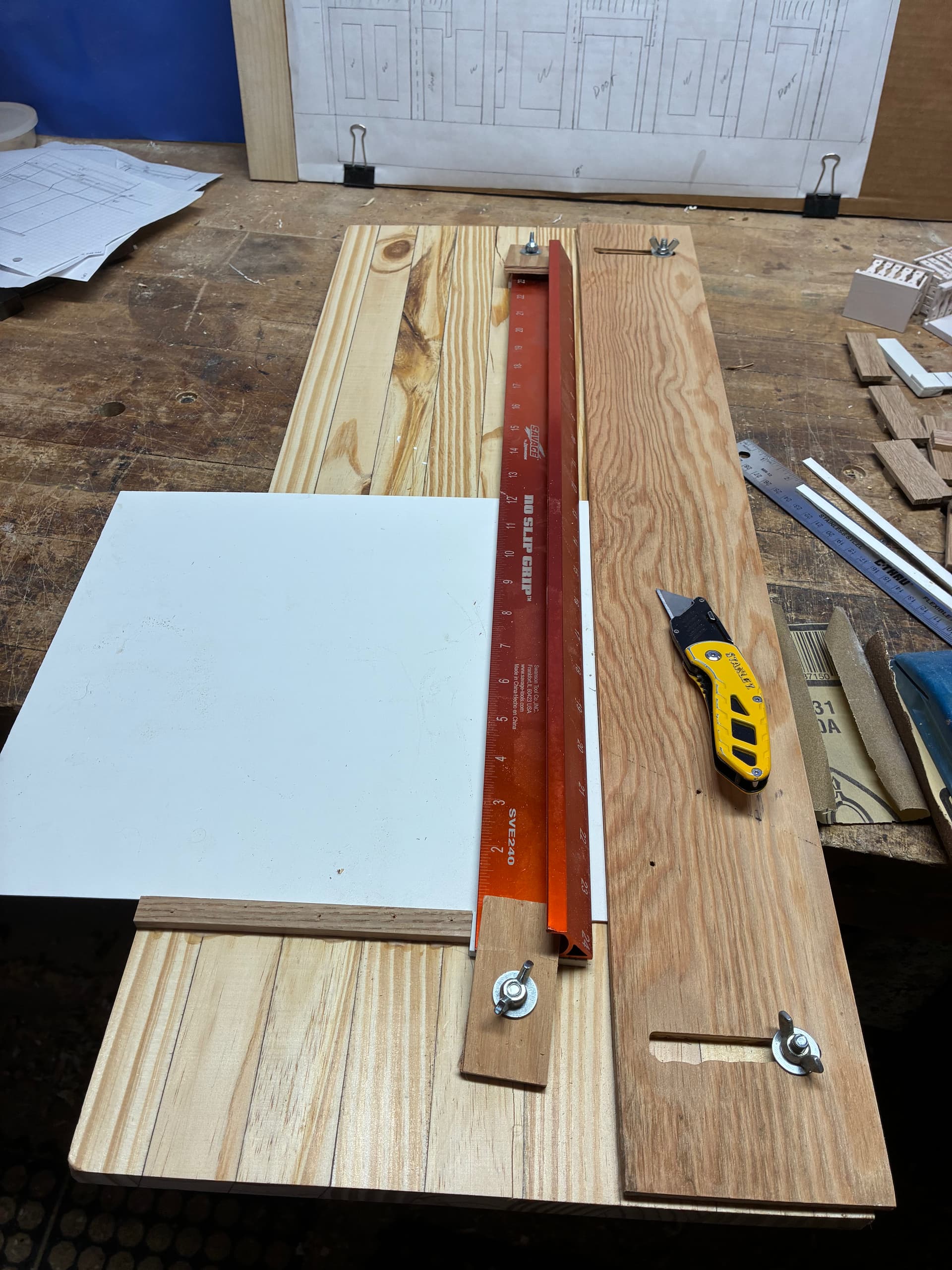

This is what I came up with, the straight edge is raised up to clear the plastic and the fence is adjustable. Works better then marking and cutting.
Pretty much the same idea Mark. However the only thing is I didn’t like that way is the sheet sometimes tended to bow up just a little while cutting. That is why I use the block to slide it flat first while cutting. Now mind you I was cutting 3’ lengths. I do cut the 3mm and above on the 12" compound miter all the time though.
I’m sure that works for rigid material but not economical for what I do as I would need to lay down a bunch of strips. The styrene and pvc 5mm or less tends to bow if not fully affixed. I use the 3" wide blue tape most.
