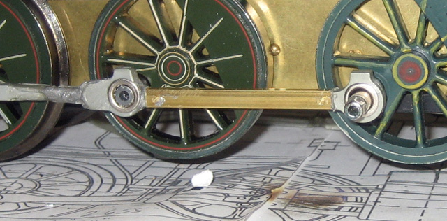

I once made a 2-8-0 out of B’mann 4-6-0 parts with a new brass chassis. I had to extend the side rods, so I used brass rectangular tube to connect the old bearings. A small 00-90 (?) bolt at each end held it together.

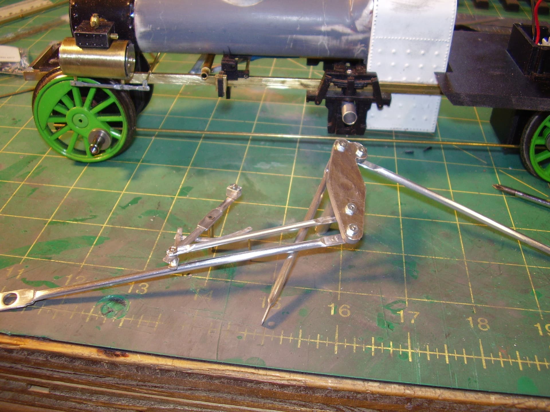

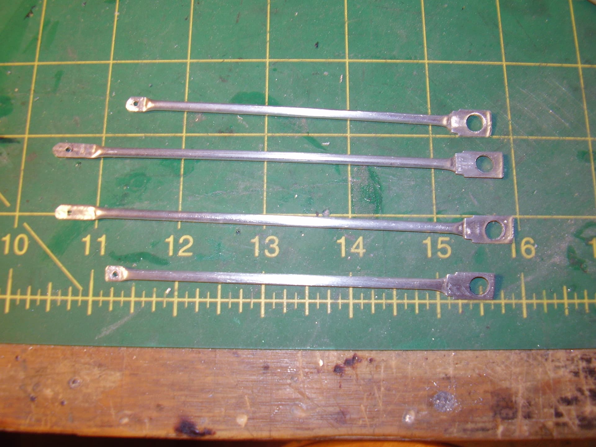

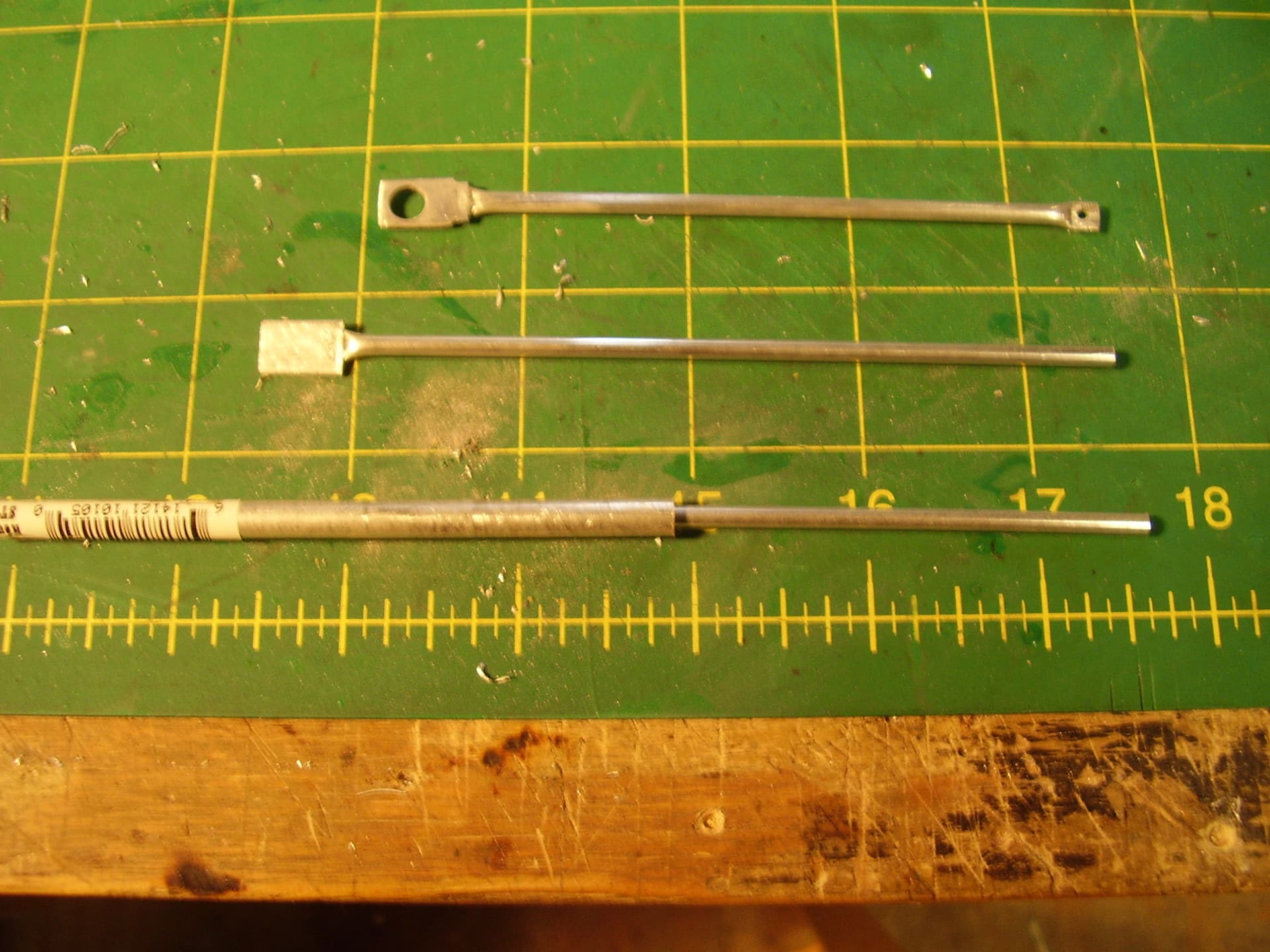

Hey Travis good to hear from ya’ and hope all is well. When I did the model of Utility I used simple aluminum tube which was drop forged with a vise, a hammer and some modeling adhesive.
Now Utility does run, however it probably has a maximum of 1/2 hr run time so I don’t know how long the aluminum would last. So with that said I think if your planning on a constant runner I would go with brass and solder together.
Sounds nice and rugged. And not very hard to do.
