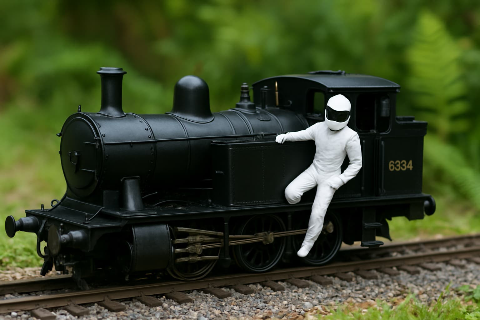

Dave I found I could get even more speed out of my garden engine if I replaced the engineer with another figurine. No special gearing or voltage changes required.
Richard, you might want to re-think the super-elevation on the curve if you use this technique, though. It will automatically run your loco in ”Top Gear”. :stuck_out_tongue_winking_eye:
Cliff, I am happy to send the figurine so you can test your trestles in real world conditions.
I want one, where did you find a Stig, or a racer I can make a Stig!
