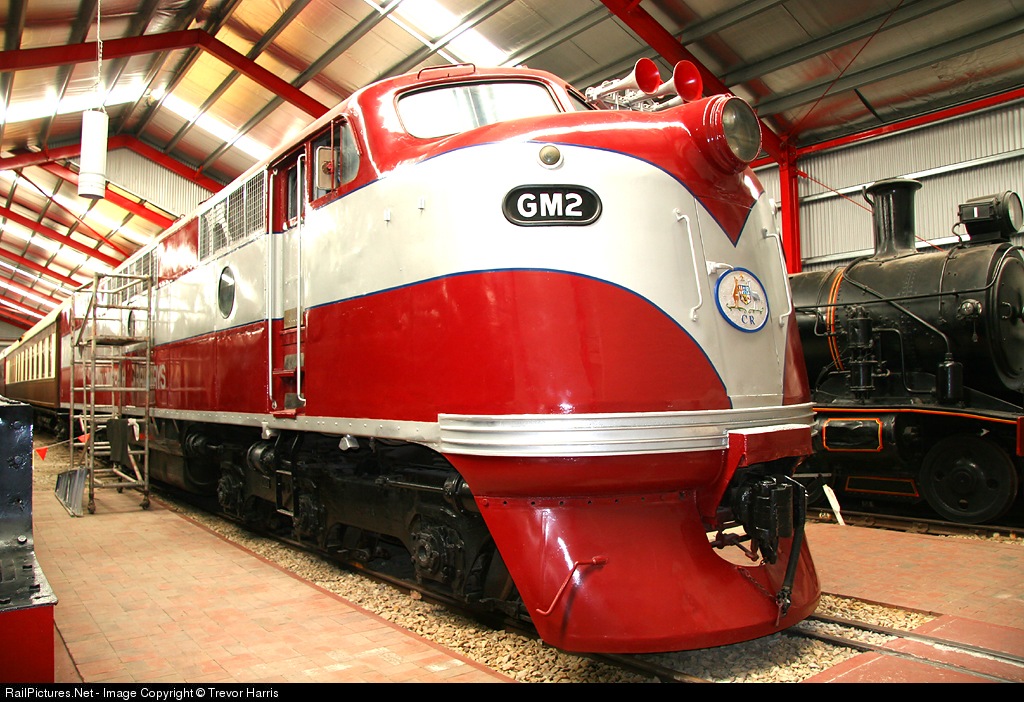

For a time, the horns on the B class Clydes were mounted on the nose, right above the headlight. It didn’t seam to cause any issues with the light. The engineer’s hearing and visibility are a different story.

Oh, and here’s the specific HLW Mack in question.
Last night I finally felt up to working on trains again and got the molded on headlight fittings sawn off.
