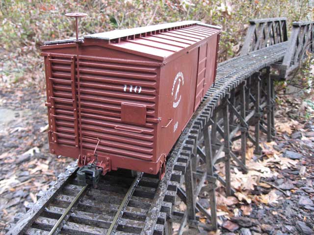

Cool. Looks like I need to make about 20 pair, from what I’ve got emails and all from.
Here’s what it looks like painted. I’m very pleased with how it turned out.
I’m planning on at least five more of these…
Heynow, thats pretty neat lookin! Love it!

Since it decided to become winter here all of a sudden, its too cold to paint, but I figure I should show progress on my first composite car. I need to get some 1/8 rod for the ladders. These are 3/16 and it doesnt look right.
I have to agree with you on the ladder. The whole thing looks too big…even the sides. I also think it needs one more rung on it. Those look too far spaced. Otherwise a really neat looking car…
It does look nice! But, thinner rod would be nice. I ended up using .040 brass as it’s pretty easy to work with, but it’s probably too thin. I’m not sure what the scale width is.

Bob Bruce they look great can you tell me what you are useing for the top door slide? is that a piece of z streyne and what sizeare you using
I just used some angle for mine…but I don’t recall the size.
I agree with Warren. More rungs. The ladders on the EBT’s wood and composite cars had rungs spaced at 14". The steel cars grab irons were spaced at 18".
