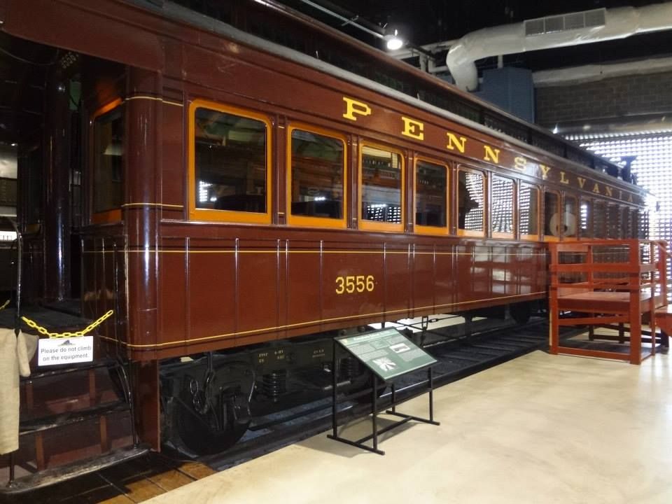

Todd here are some pictures of the real things, we took these in March at the Strasburgh Railroad & PRR Museum.

Pennsy and the N&W (and a bunch of other eastern coal roads) used Tuscan Red for their passenger cars…its sort of a brownish maroon color that railfan modelers have been trying desperately to duplicate for years Rustoleum has a burgandy thats kinda OK for it…

Vincent we visited the Strasburg RR last year and they sure have some gorgeous equipment. Their red is very nice. I knew I had seen a brown Pennsy car and there it was at the museum.
