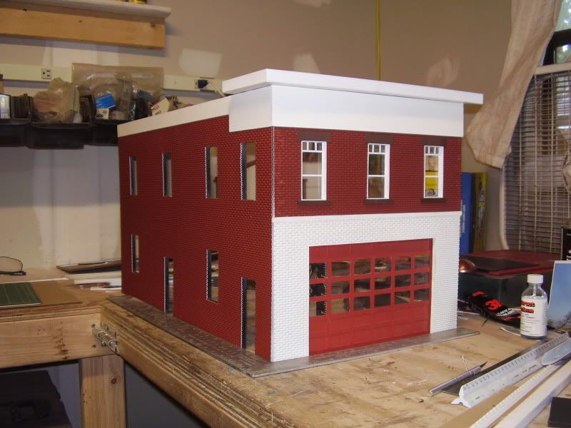

I used Krylon Red Oxide primer on my firehouse build. It can be scuffed for a dull finish or clear coated for a shiny finish
