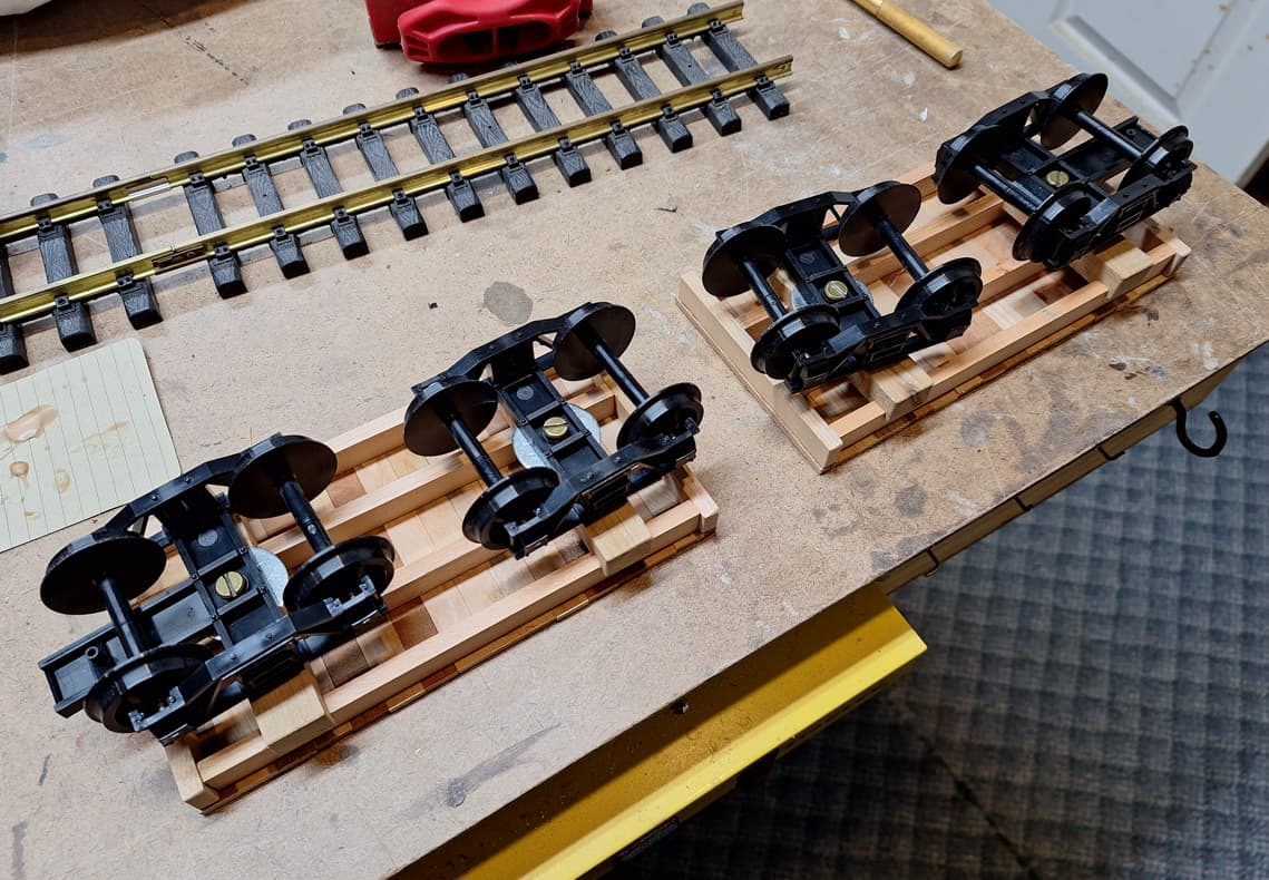

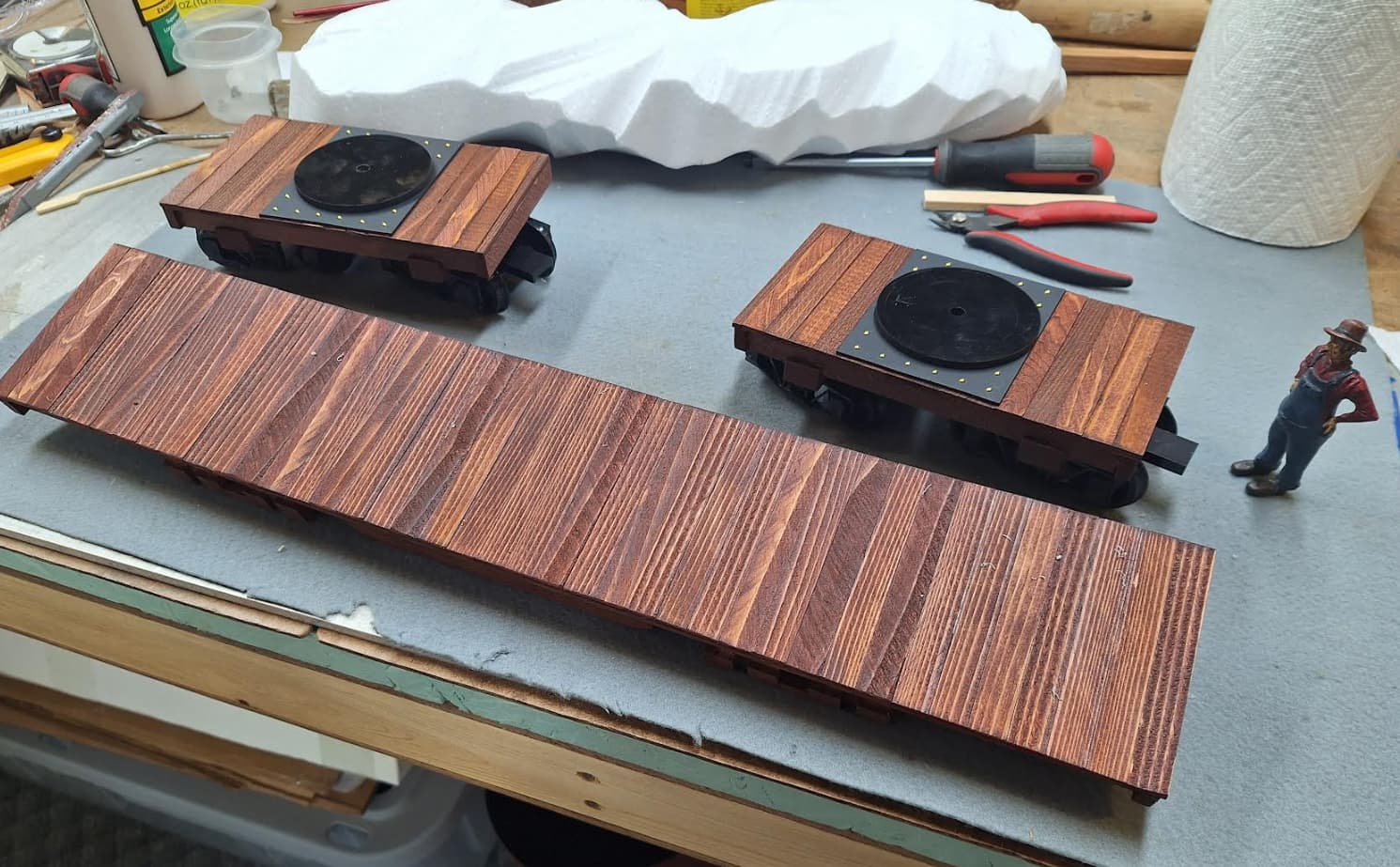

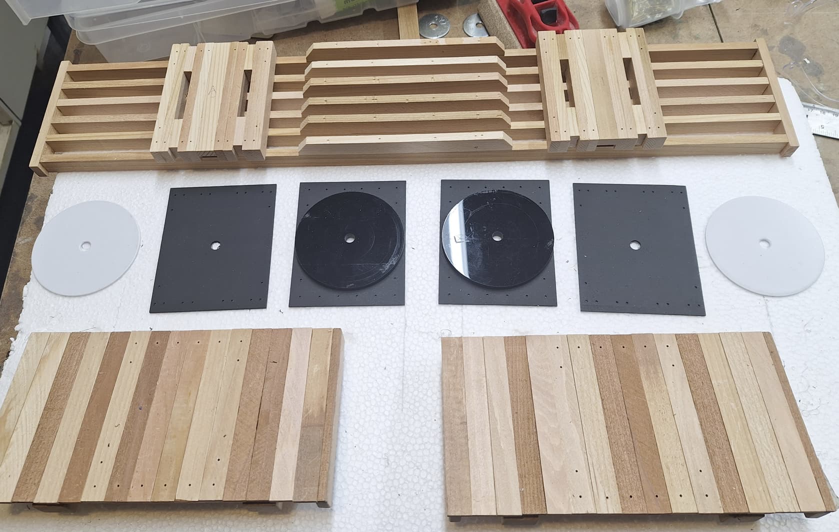

Finally got moving today, starting with the bearings between the trucks and body bolsters. I used “sex bolts”, fender washers, and some nylon tubing around the shank of the female sex bolt to work with the hole size of the truck. Lots of fiddling, but I’m grateful it’s only one car, and not supposed to be historical.

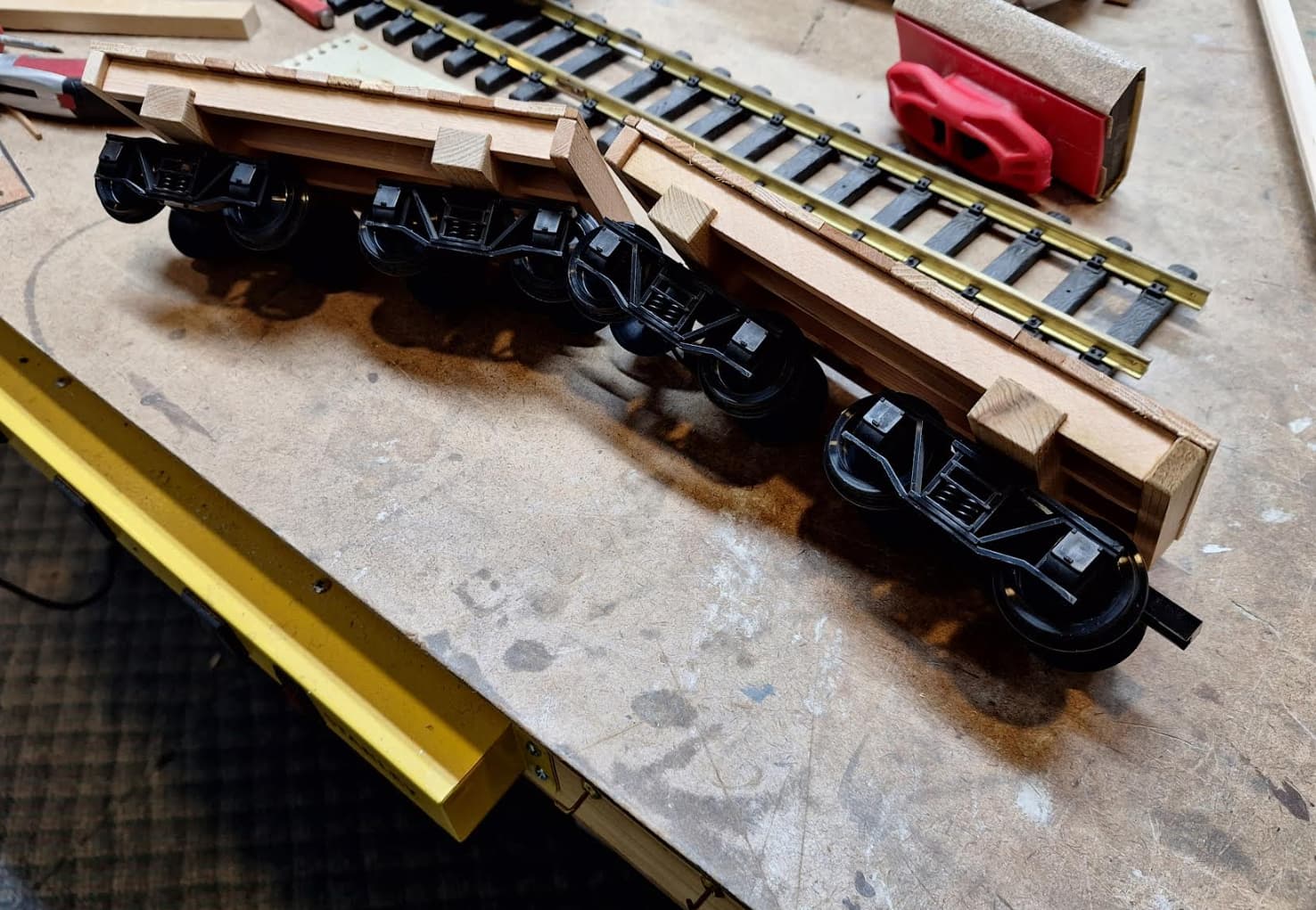

After that, I worked on framing up the two… sub-cars?
The big slew bearings won’t be very impressive, because they’re hidden anyway. But that’s the next step in this layer cake.

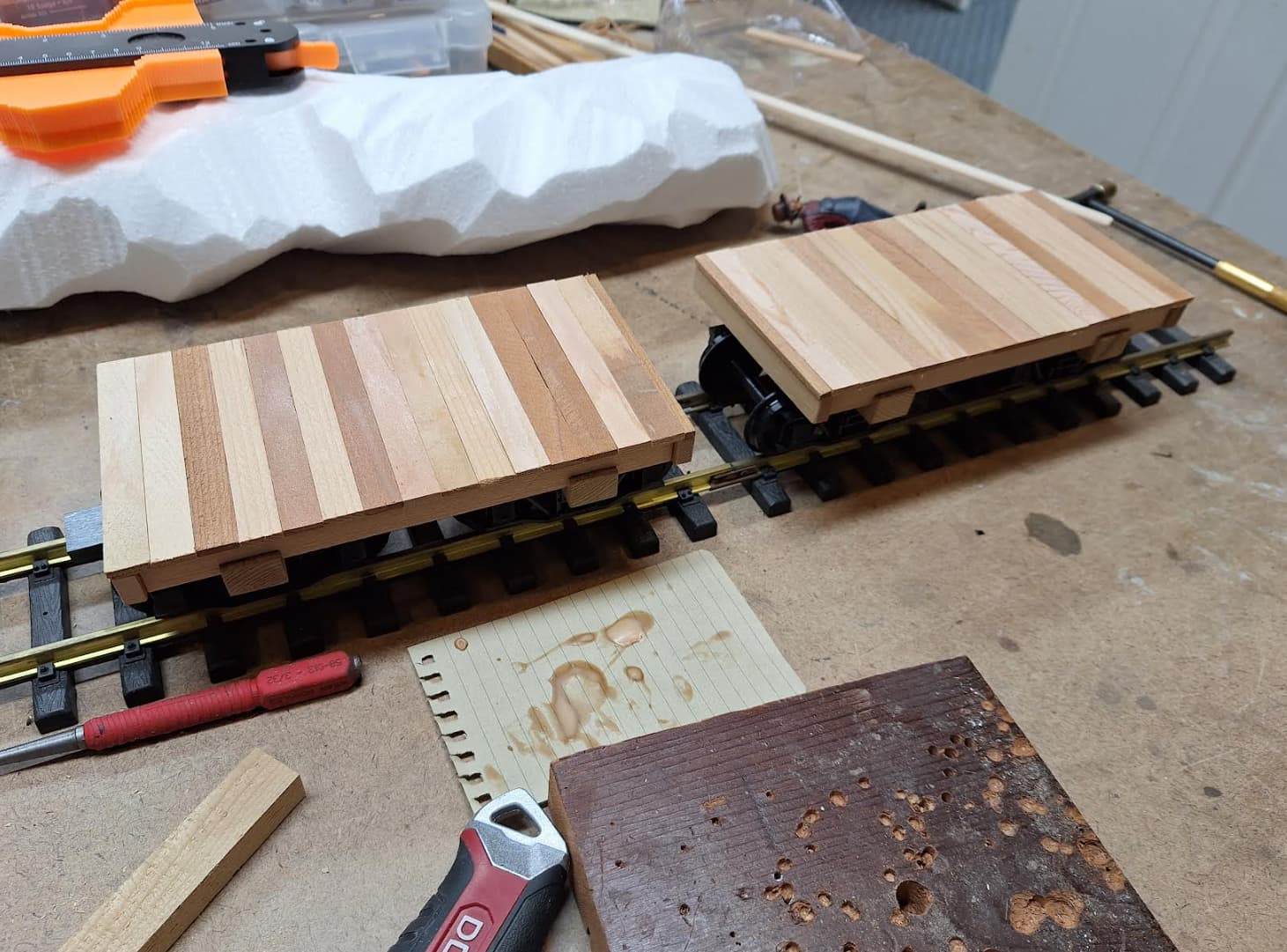

The above pic shows a contour tool which I bought to measure the nugget braces. With tax, it cost $26.49. Not sure if tool costs count, but if so, that’s my expense on this project.

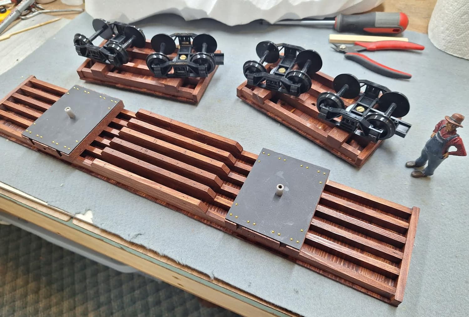

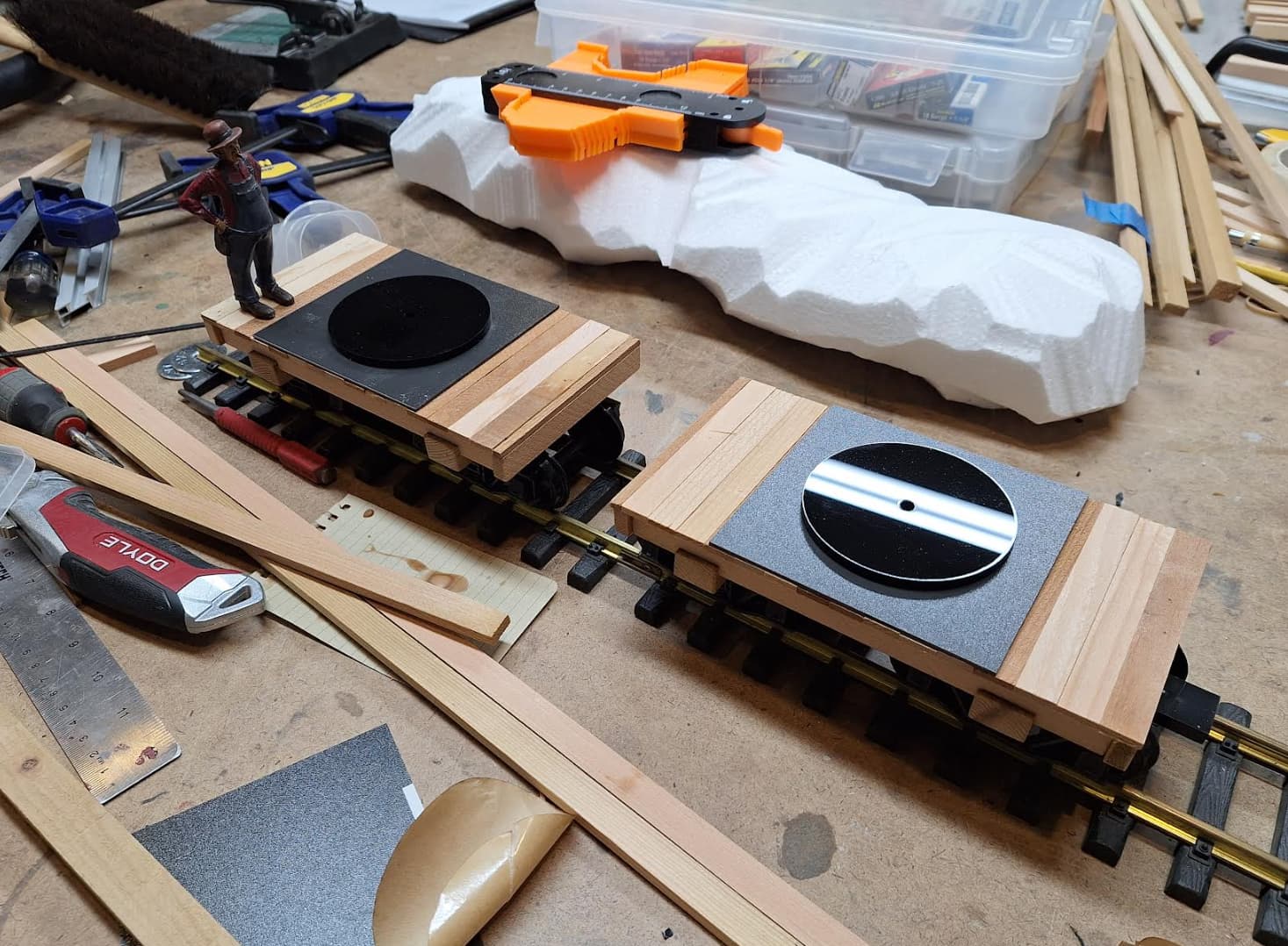

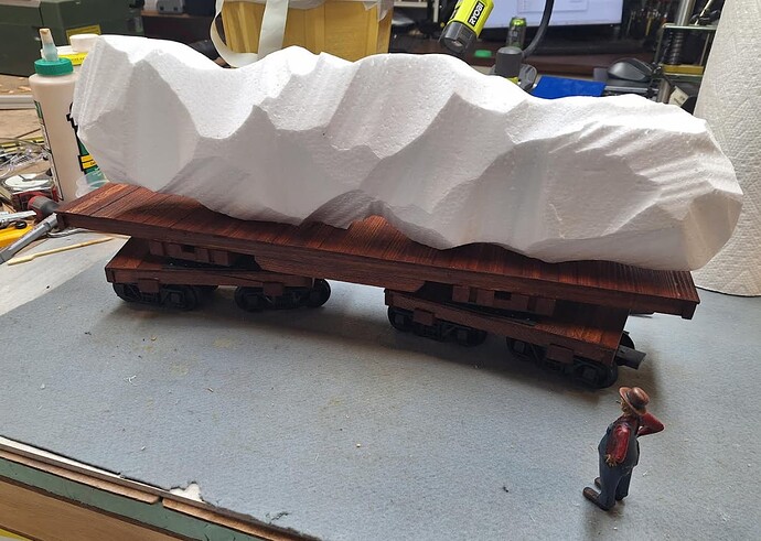

Yesterday and this afternoon I’ve been working on the slew bearings and the main car body. So far, all seems to be working ok.
The nugget is too tall now, I’ll have to rethink that.
Beyond the nugget, next steps involve detailing, not sure how far I’ll go with that, we’ll see.
maybe, your lucky '49ers excavated a whole gold-vein ? (that would be flatter)
don’t forget - it is a challenge and a whimsy one.
how about train robbers? one with a pickaxe, animated like the New Bright christmas cars?
True, it would be flatter… hmm.
Great idea! But I think the static details will take awhile… and I’d like to wrap this soon and get back to the loco transfer car before more home improvement stuff hits.
