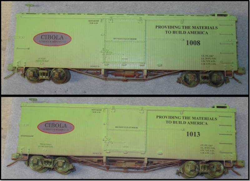

I have two different paint schemes in use. They reflect box cars painted pre-merger and post-merger with the mining company.
The older cars are repainted Bachmann Spectrum wood roofs.
Black primer then Cibola green. The markings are a combination of masking using vinyl adhesive letters and ink jet printed decals. The paint is then sanded down for ageing.

The post-merger cars are Accucraft with murphy roof. The lettering and logo are laser printed decals.
boxcar1
boxcar2
boxcar3
This last car was done by Bart Salmons for his layout. I gave him the car and decals. Don’t know what became of it but it is the only car lettered for my railroad that I do not have possession of.

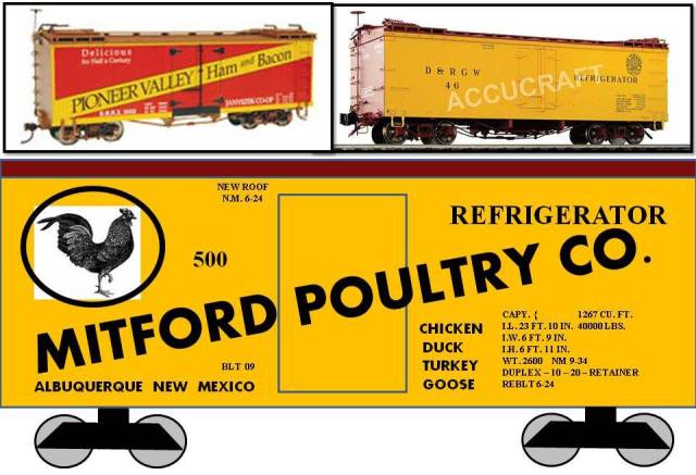

The second reefer is owned by a cattle company and meat packer. Someday I will add a poultry car to their fleet.

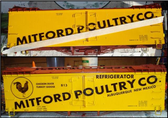

Livestock cars
A simple repaint of two Accucraft stock cars. A base coat of black primer followed by white primer and then canary yellow. Masking with vinyl letters
Mitford Livestock Shippers. A wholly owned subsidiary of Mitford Poultry.

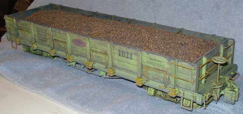

Dropside Gondola
Repainted Spectrum gondola. Green over black with inkjet decals.
The car had to be completely disassembled then painted and weathered in pieces to get around all the detail parts.
gon1
gon2
gon3
gon4
gon5

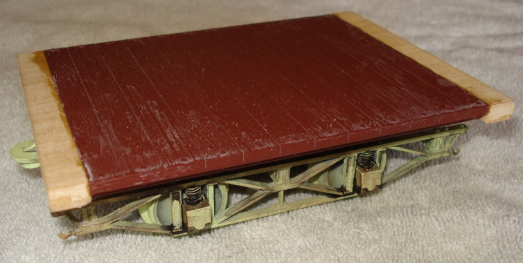

gon6
Once it was back together a Styrofoam block filler was glued in with a second mound shaped piece. Black primer to help hide the ugly truth. The ore load is medium ground cork mixed with black wash and white glue. I shaped it over the mound with a spoon. Once it dried I gave it a wash of gray.
gon7
gon8
All done.

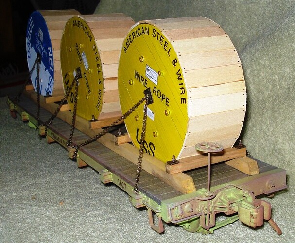

Standard flat with cable drum load.
Another project where the load is an intense level of construction.
After considerable research I decided on wooden closed cable drums. These are made from Popsicle sticks with a Styrofoam core. After being glued together. They were cut on the band-saw to insure alignment of the sides.

The lettering is masked with adhesive vinyl letters. The labels are inkjet printed on bond paper.
To hold them in place I made a temporary rack from basswood to attach to the flat car.

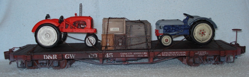

DRGW Flat with tractor load.
Accucraft car factory painted and lettered with some basic weathering.
The tractors are 1/20 scale epoxy kits. They were given to me by a fellow trainiac here in NM. I have no idea who the manufacturer is. The crates are assorted a mixture of LGB, Prieser and Woodland Scenics products.

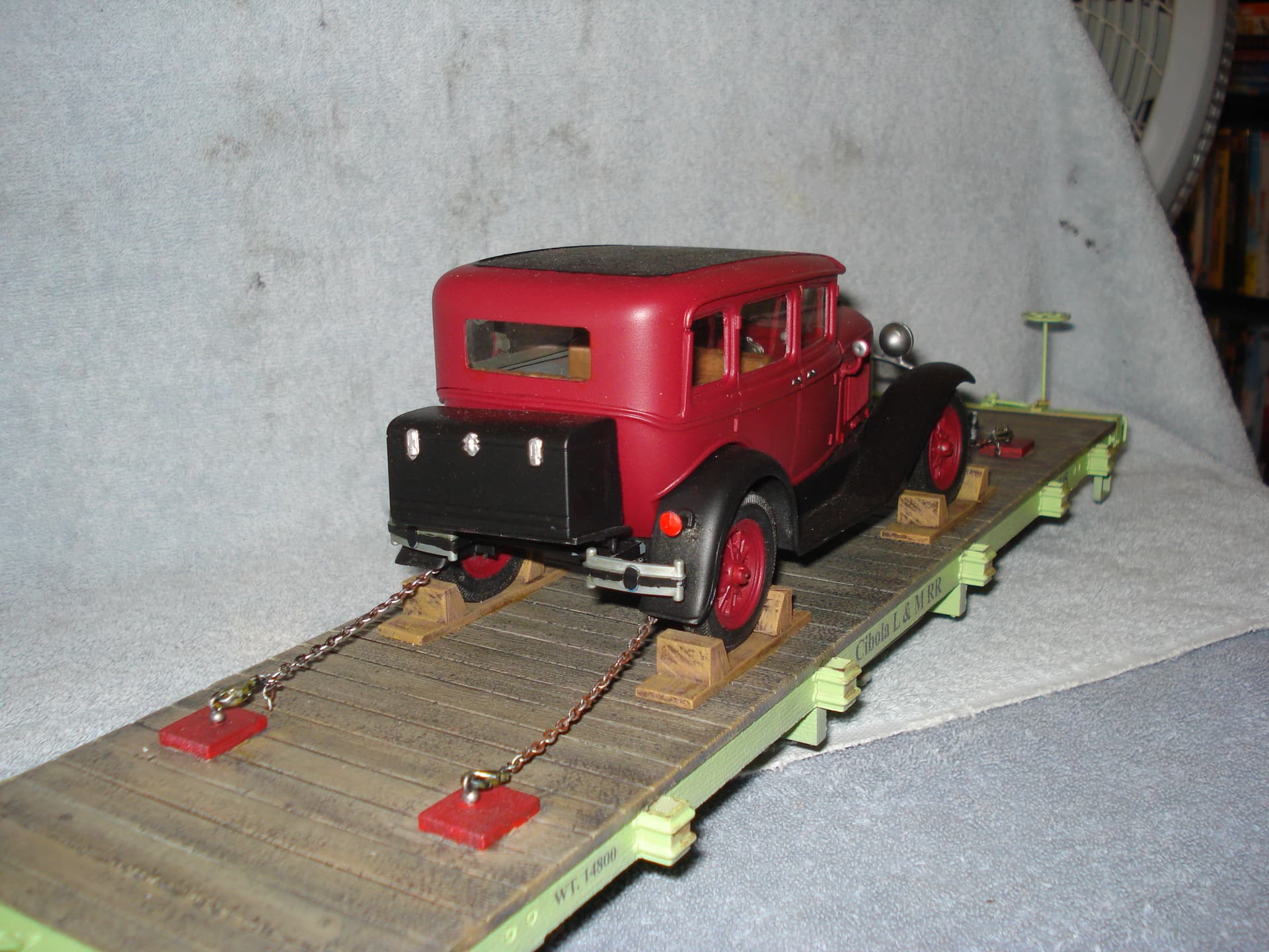

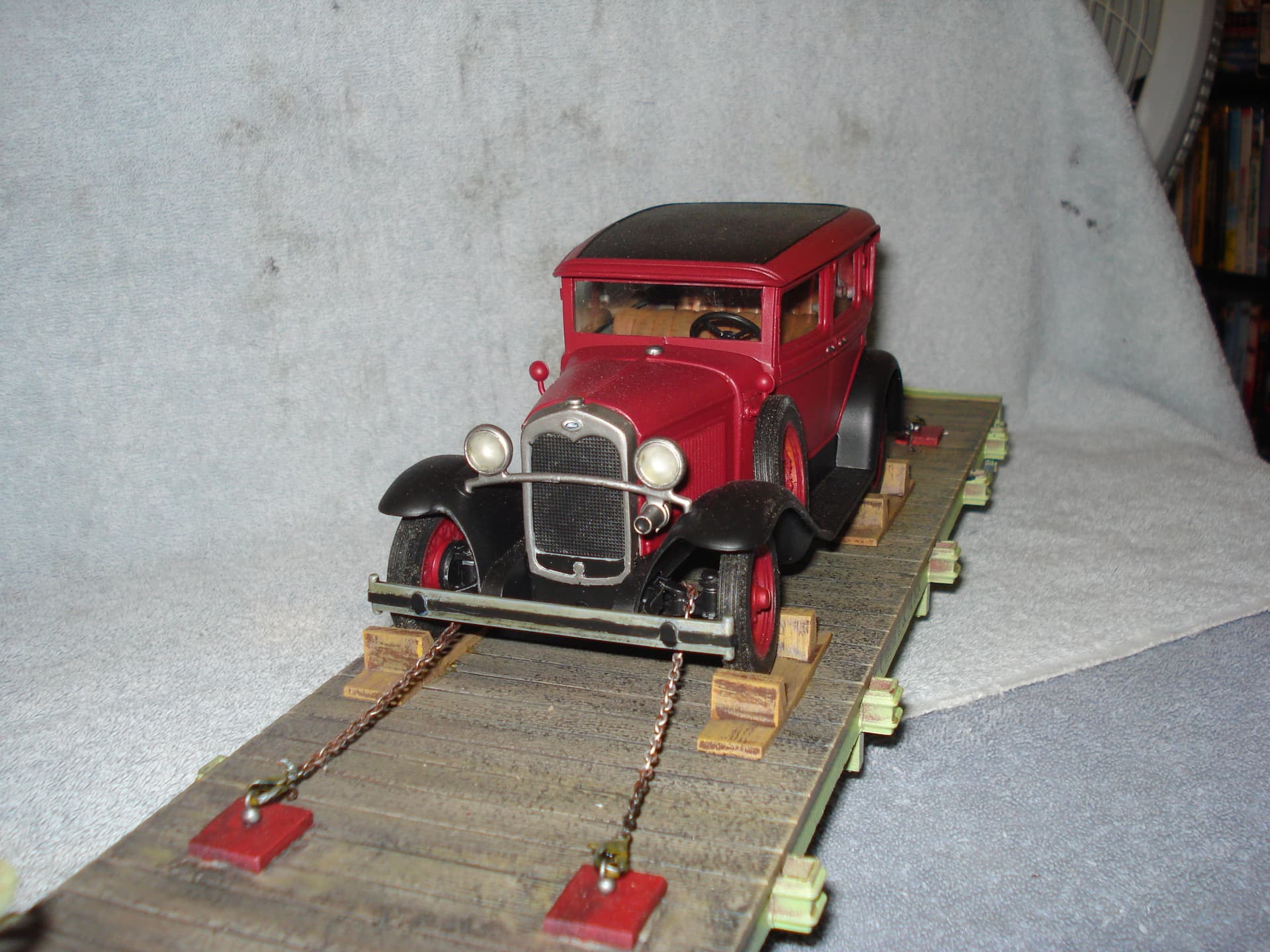

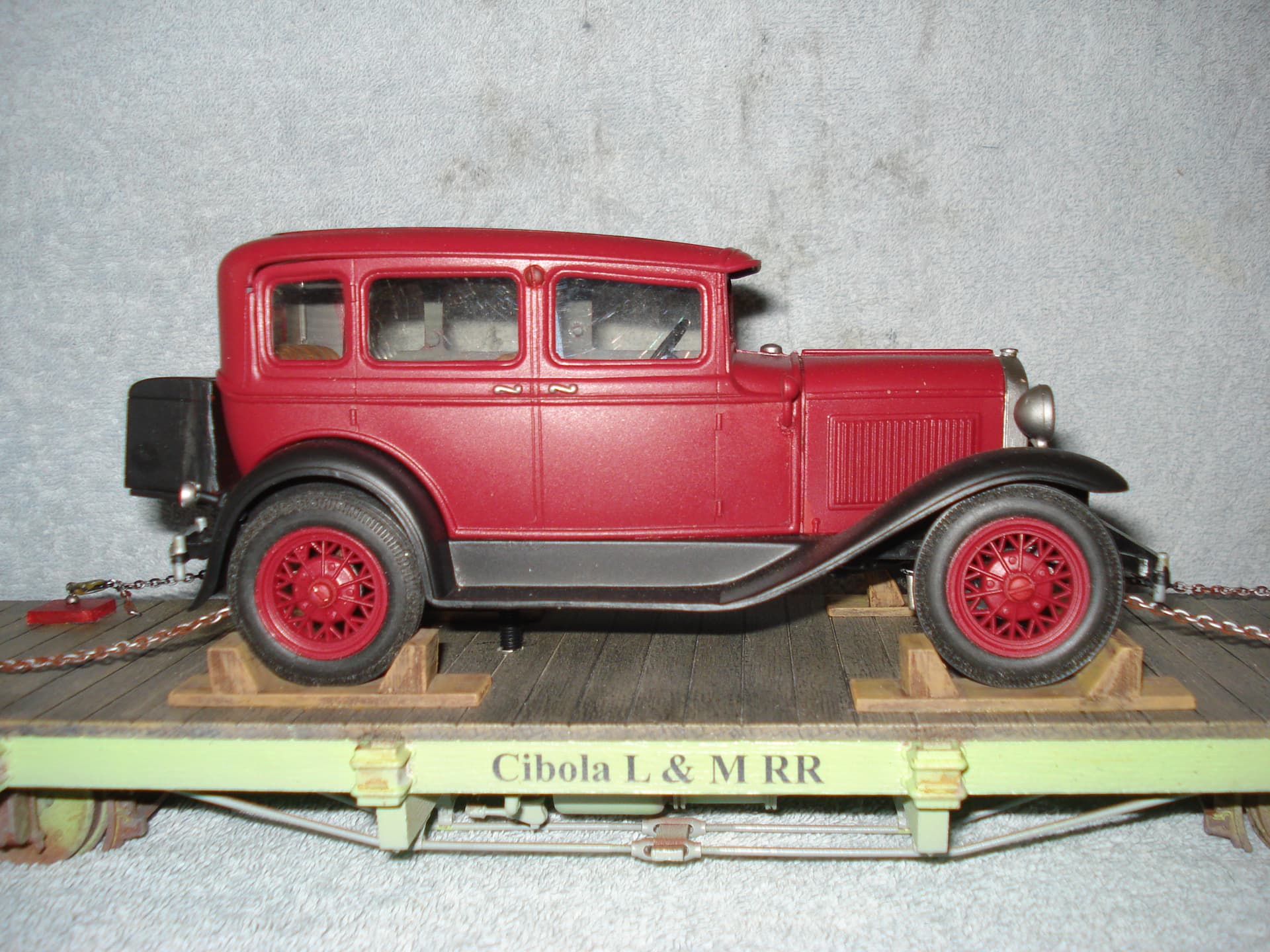

This flat is caring a Hubley, Model A Ford Sedan. The towns of Cibola and Broken Wheel are both close enough to Albuquerque that most people would take the train down and drive their new car back. Maybe someone with more money than time had this one shipped in from Oklahoma City or Dallas and then cross loaded to the narrow gauge.
