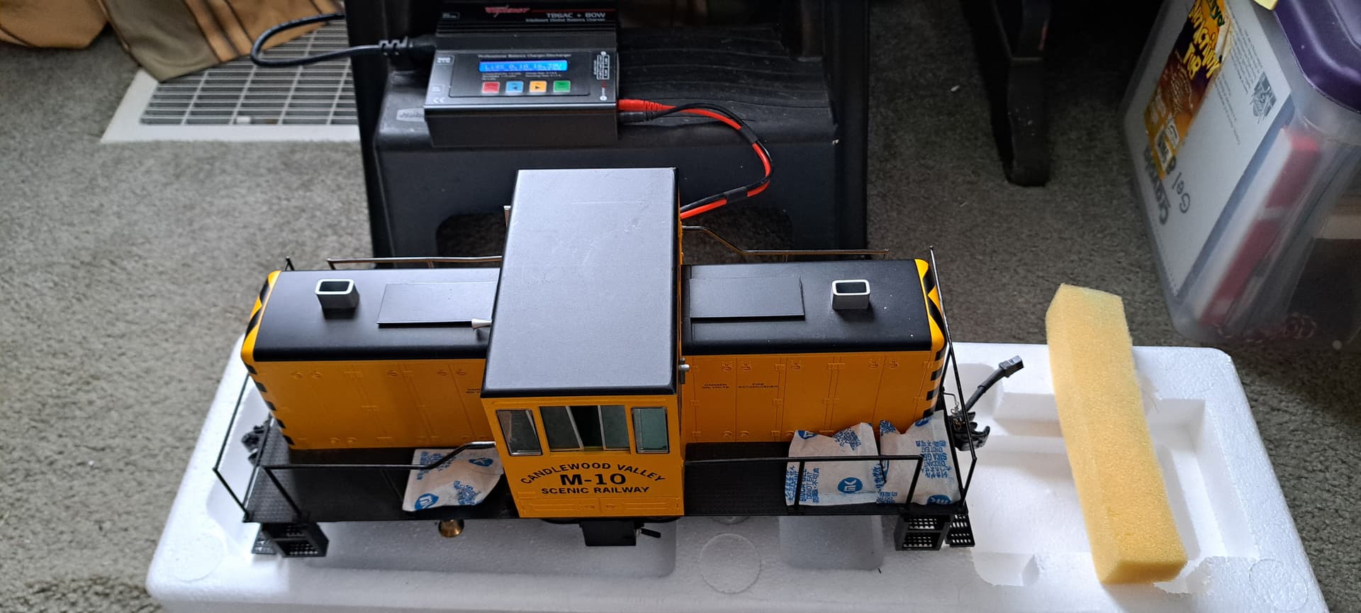

Since you all love pictures so much, here is M-10 taking some fuel…
Great to see you breaking the trains out Jon.
Not quite broken out yet.
Yeah but at least you took it out of the box and set it on the carpet… Well, you set the styrofoam on the carpet… Sort of counts.
