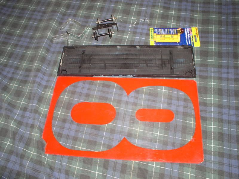

I finally got started today…
I’ll leave you fellers to try to puzzle out where I’m going with this pile of miscellaneous crap.

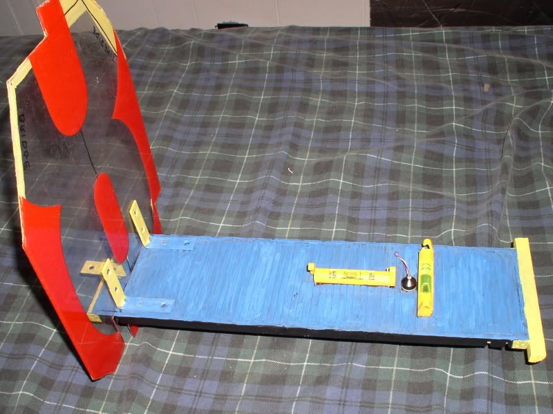

OK, I admit, this thing looks REALLY, REAALLLY goofy… BUT As you push it along the track with a single finger, it checks for: level, cross level, dead power spots, high wing and closing rails, stones in the flangeway, mis-alignments and other in-gauge obstructions, locates small twists and dips, and verifies all proper clearances… What more could you ask for? No, it doesn’t make toast. Sorry. Perpendicular levels and a simple GoW bulb wired to one axle. The car is built very light so it will derail if there’s anything obstructing the flangeway.

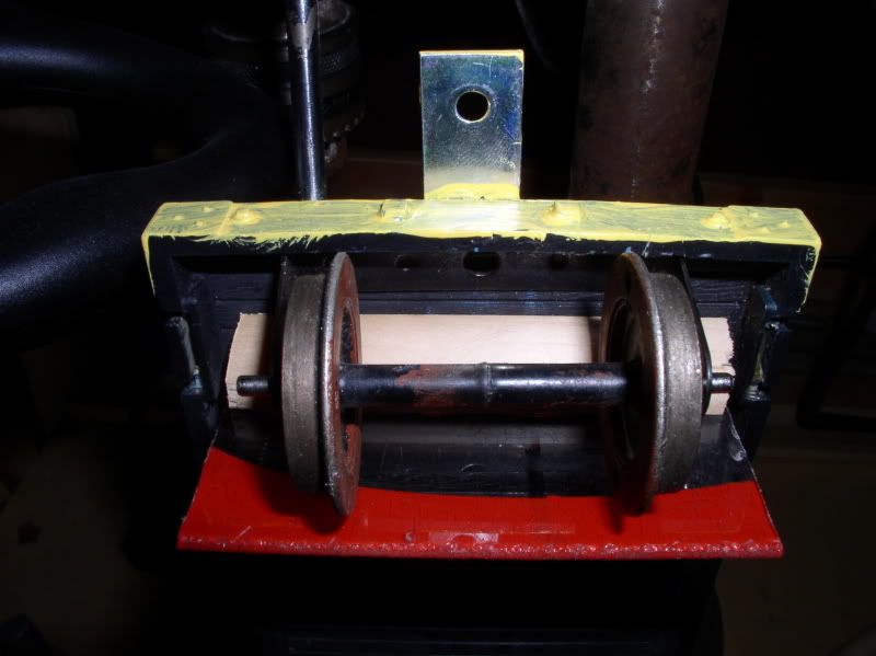

It has a rigid 4 wheel suspension, if it rocks you have a dip or high spot. One end has the exact same width and overhang as my c-16’s pilot plow. The other end has the wheelset nearly flush with the end of the car, and has a drag bar that skims just above the rail head to help detect obstructions.

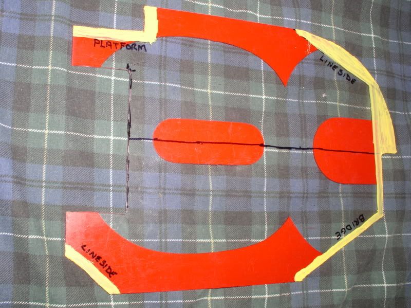

Clearance template, thanks to Matthew OV and Vance Bass
