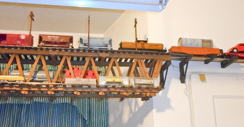

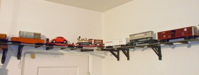

Here’s what I came up with. I run an 0-27 around my shop room, but it could easily be used for “G”.

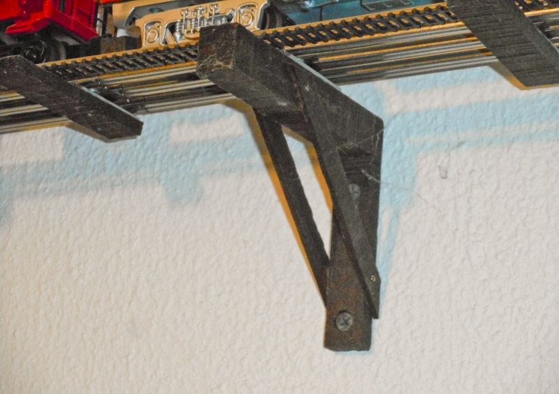

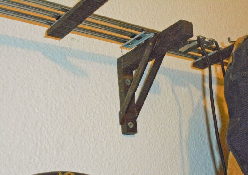

I built a number of “L” type brackets from rough cut wood, added a pair bracing diagonals. Stained them to look like creosoted timbers. They are mounted to the lath and plaster wall with 2 thru screws into little plastic wall anchors.

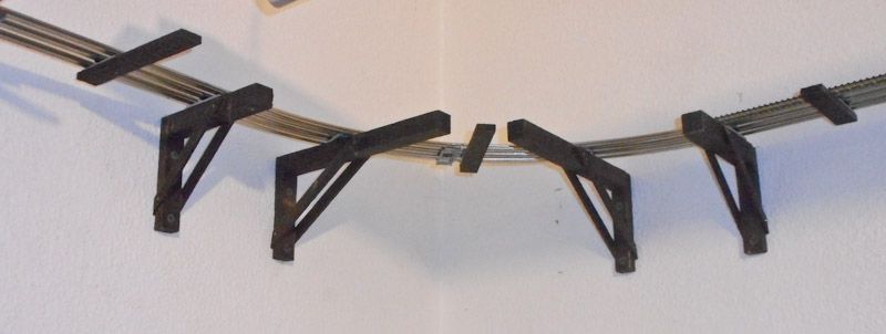

A corner section.
The basic construction is like this:
In the corner area where the track is farther from the wall, I made longer reach ones.
