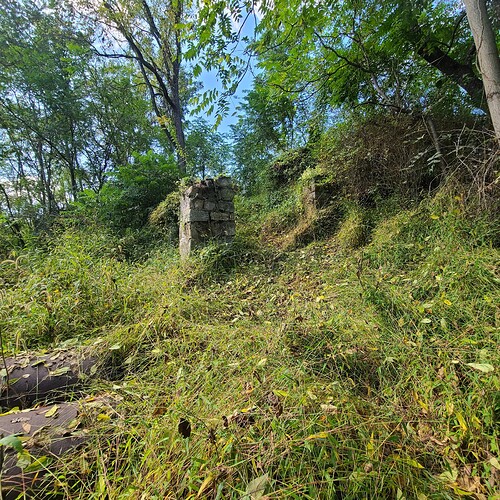

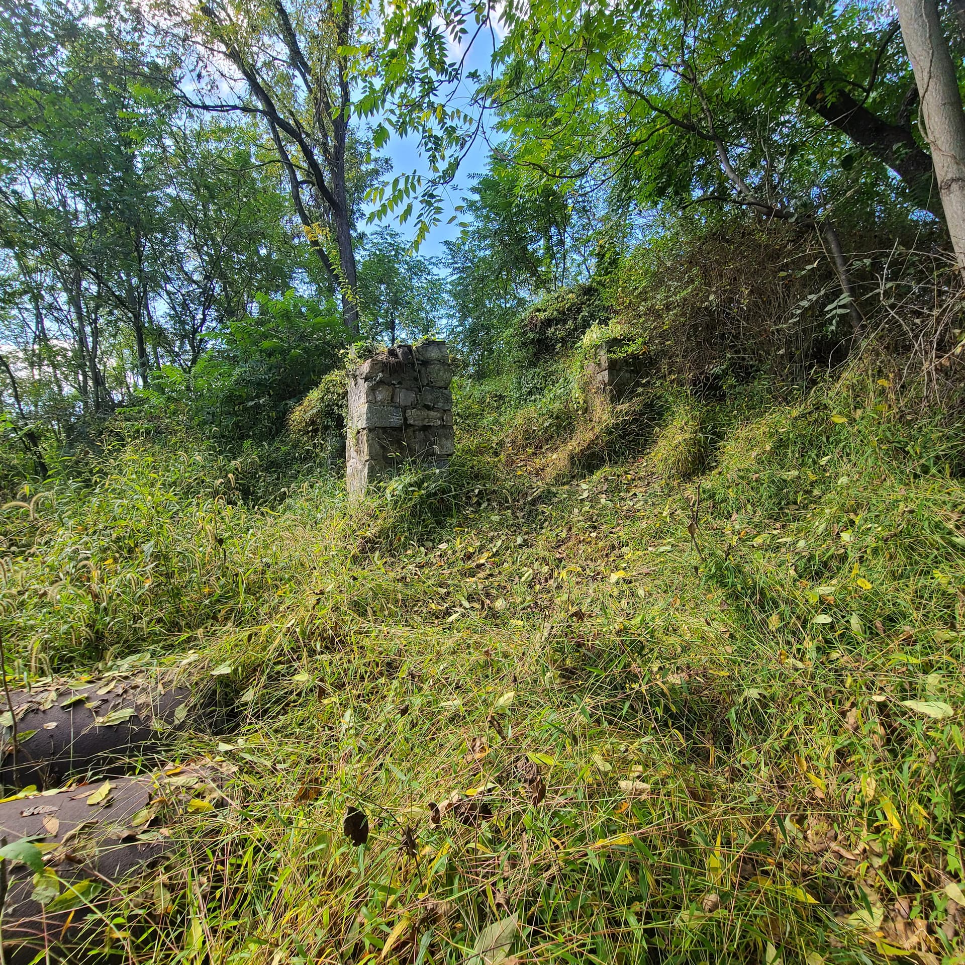

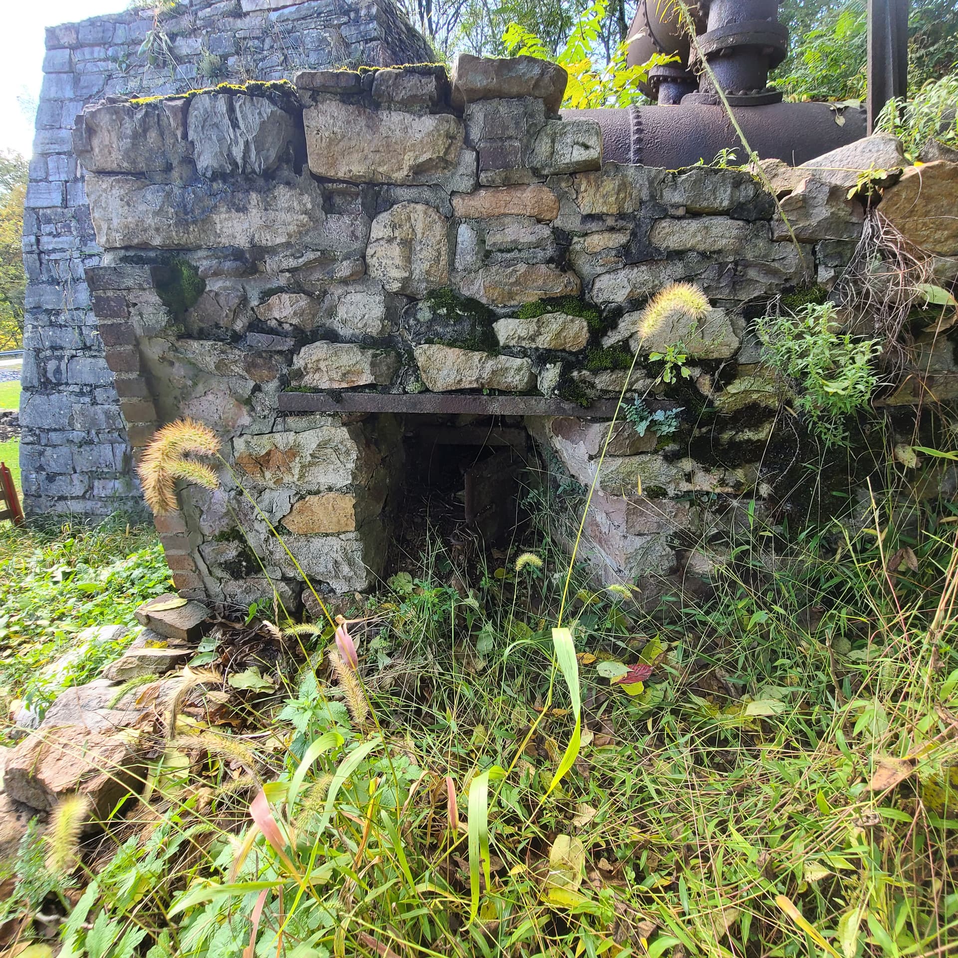

As promised…I was there today with Hollywood however I didn’t take detail pics ( but Hollywood did) only measurements …More to come and a possible napkin drawing just to see how close you are by measuring a brick as I did with Lemo back in the day in the hood!

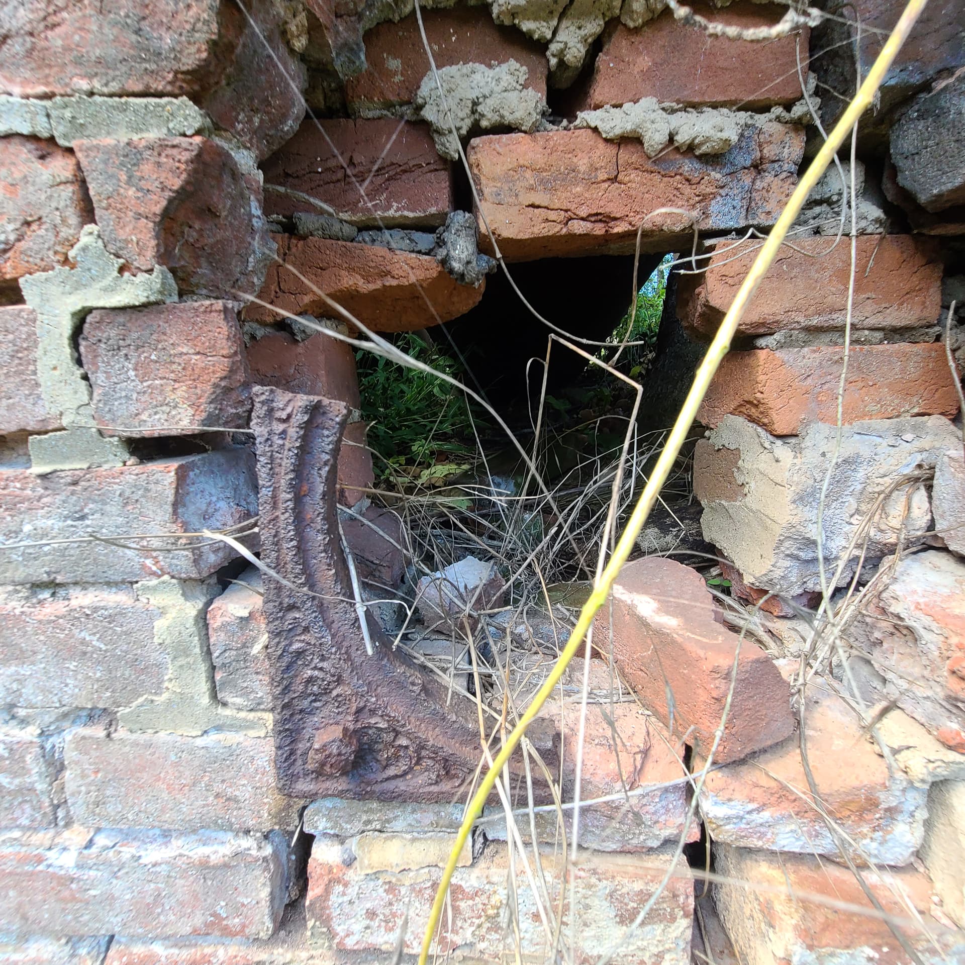

There are two access doors the one you can see and a second just behind the taller patch of growth in the center of the pic. Seem to be for feeding the fire.

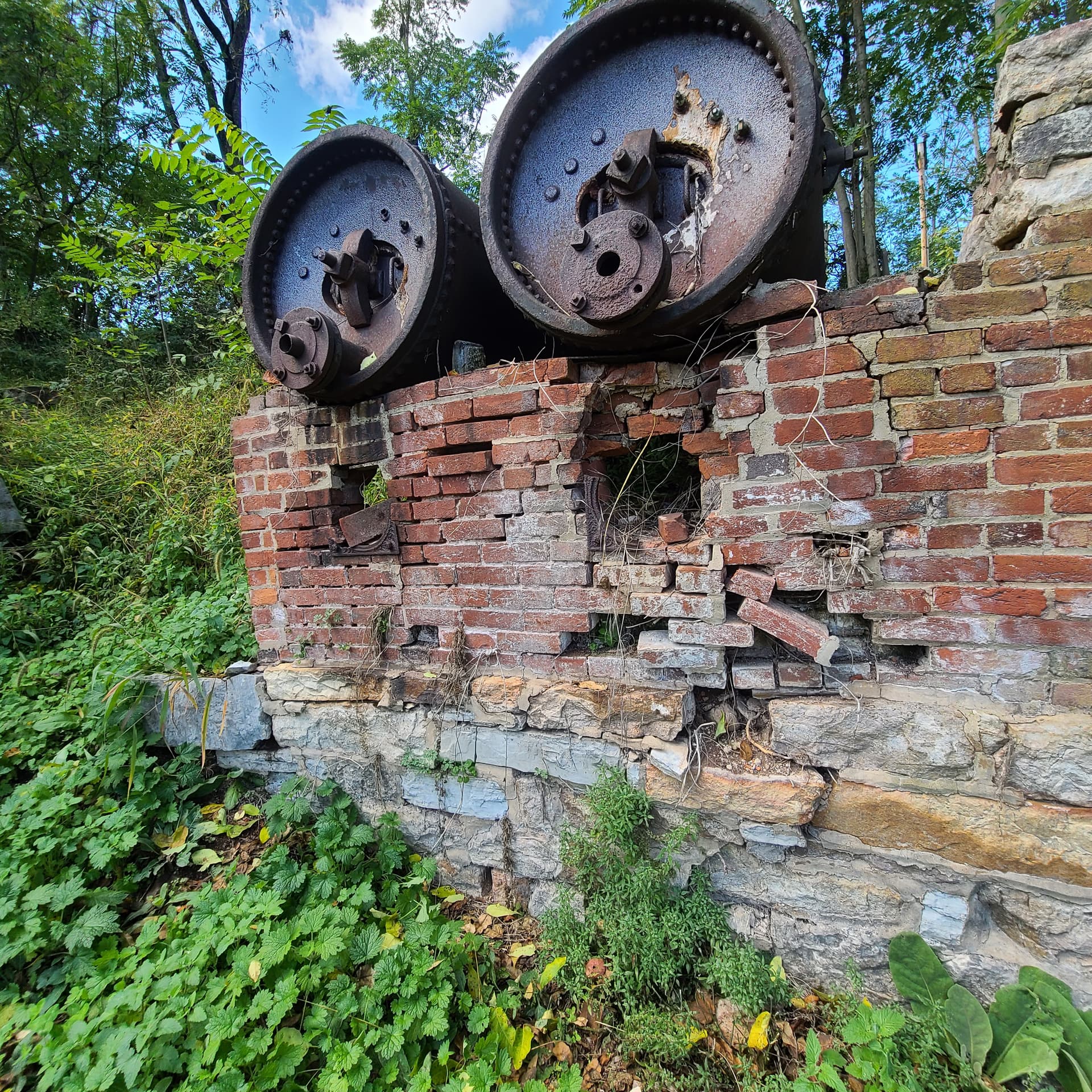

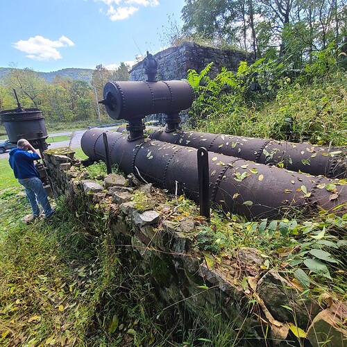

Upper pic shows pillars for another part of the whole works. These are uphill from the two horizontal tanks located somewhat inline with the main furnace structure.
Lower pic shows the tank structure and the two upright metal bars for what every they where needed for.

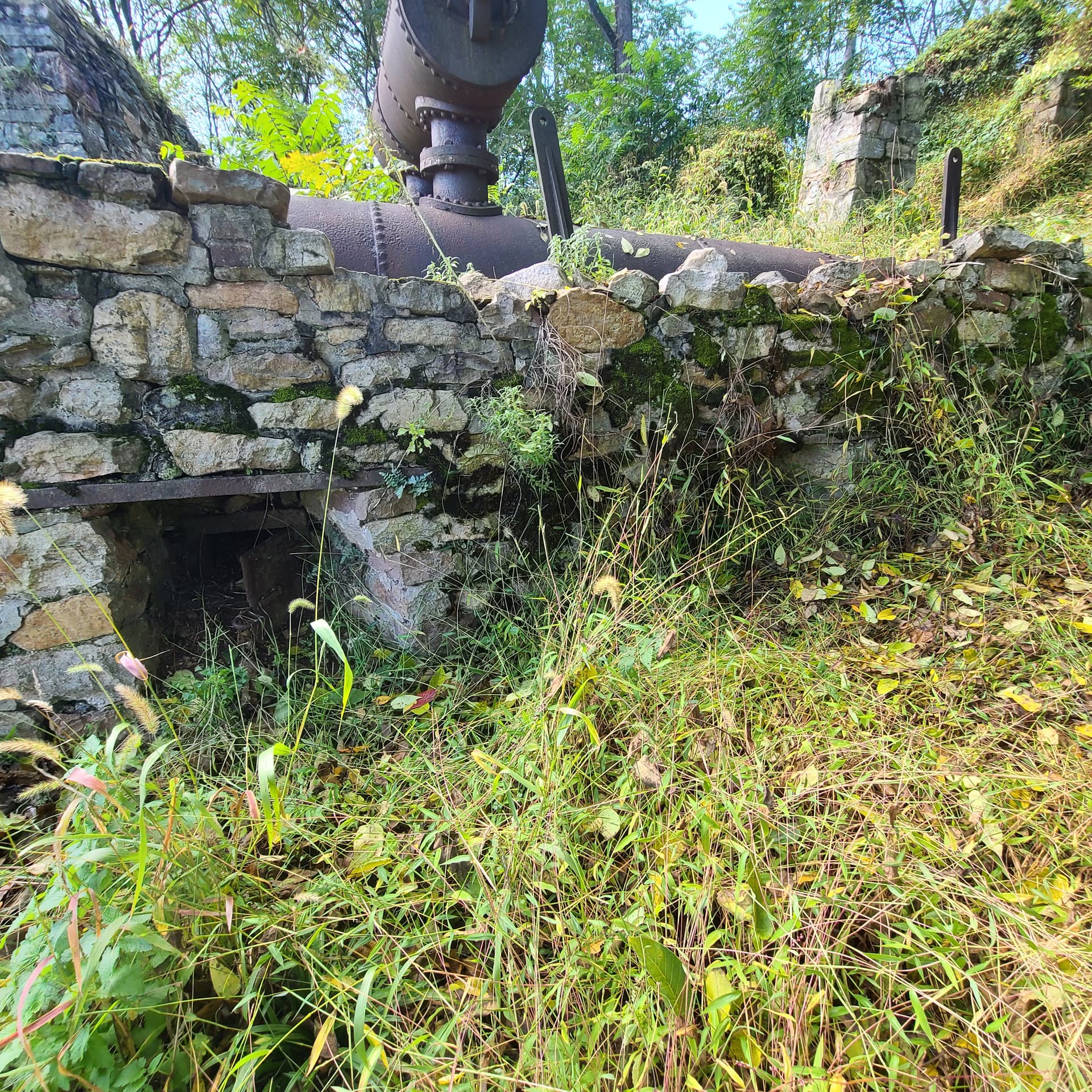

Upper pic from the front and rear of the piston support structure.
Lower pic is a close up of the two outlet holes just below the horizontal boiler tanks.

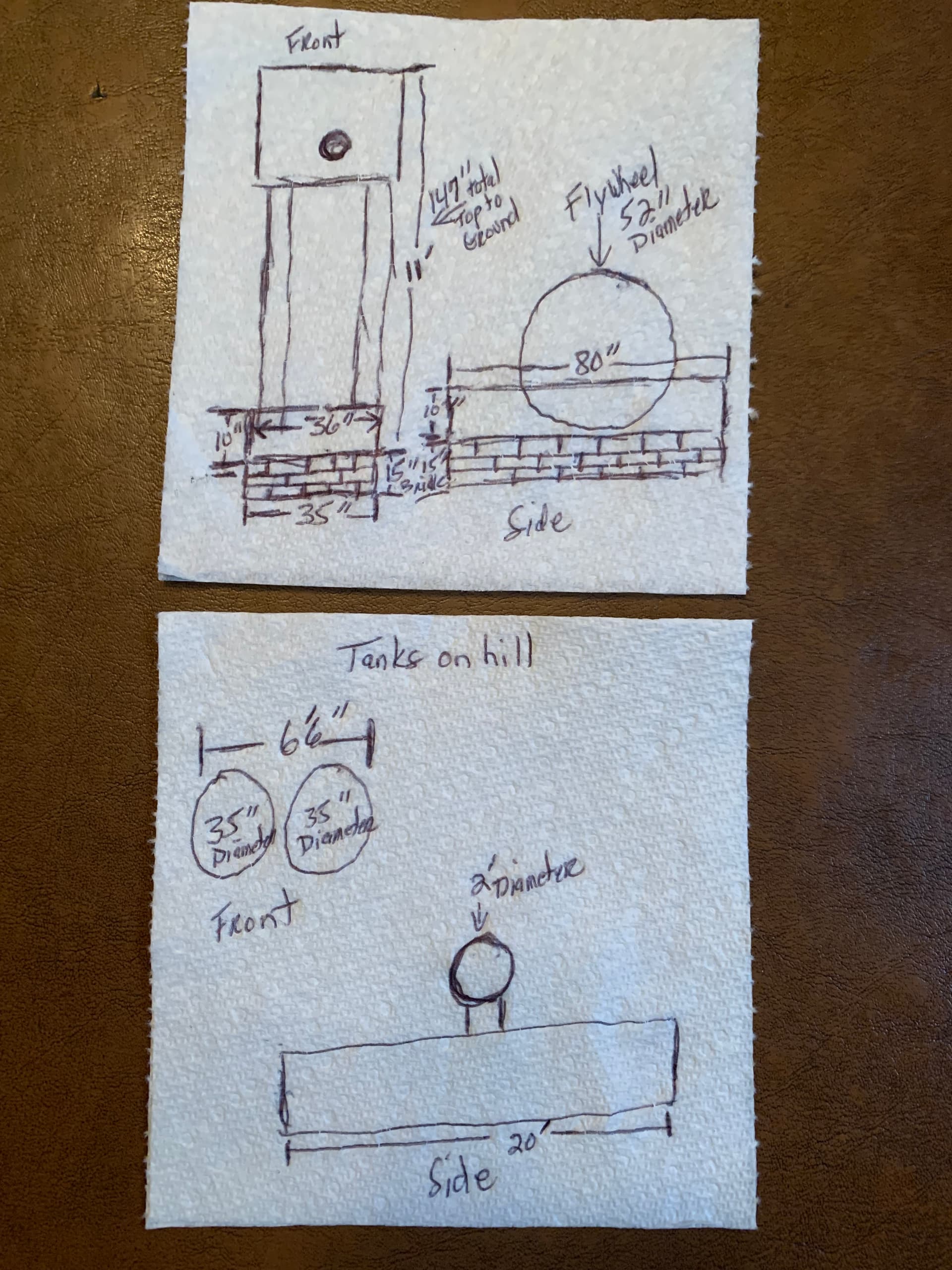

A pair of napkin drawings. Measurements should be pretty close as it wasn’t the easiest thing to measure in the field like that.

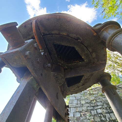

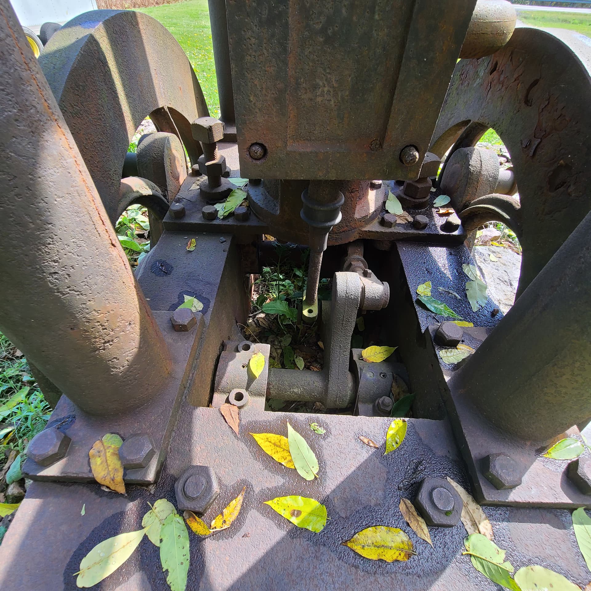

Looking up into the base of cylinder in first pic. Note that only the center rod and possibly the center ring move into the upper cylinder hard to be sure
And wouldn’t the mounts on the cross beam be for the connecting rods to the fly wheels And as a note to Devon, on close inspection both drive rods turn as one so the center cross member is pushed or pulled equally.

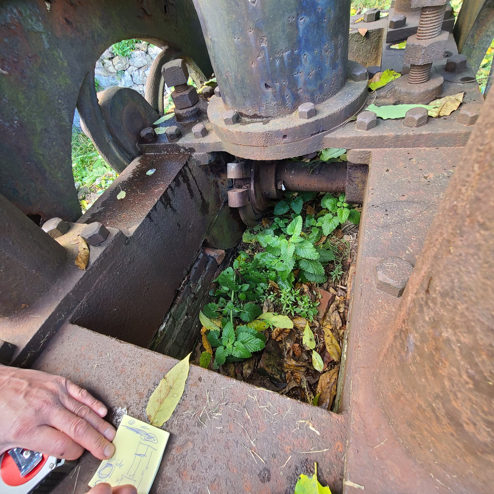

Second is looking into the base from the rear
third is into the base from front

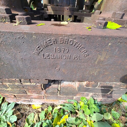

First showing the two pipe outlets from the horizontal tanks out to the piston
