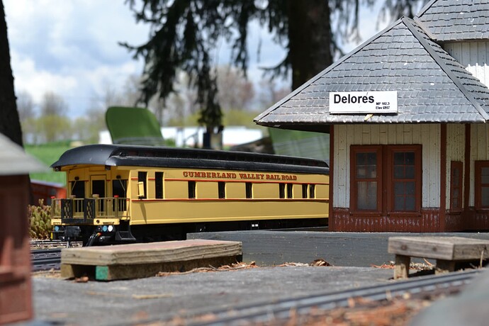

Was just digging around blocking out the real world (actually looking for pics of Dan so he can owe me $20) but I found these and thought you might want to grab them.
