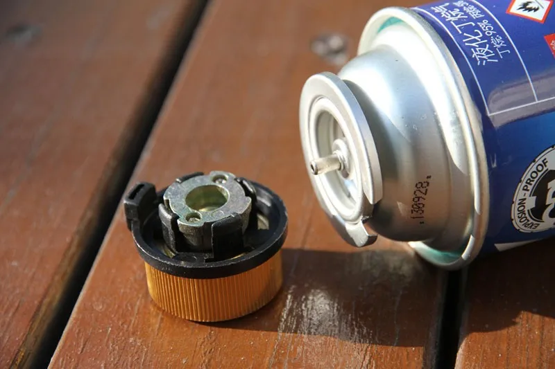

There are two pieces of each adapter, sometimes three. One fits on the gas can to make it look like a propane tank. The other screws on a propane tank to adapt it to filling a gas cigarette lighter. [First time I bought some, they were sold as ‘Dunhill Lighter’ adaptors. Not today - guess dunhill lighters are defunct.]

These twist onto the can:
And to use it, you just push down on the filler to open both the valve on the can and the valve on the gas tank.
