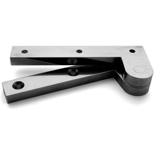

There are offset hinges that basically move the track apart before lifting.
You need to use those and then the hinge can be below the rails enough not to hit anything.
I think thereās several threads on this, Iād google āoffset hingeā

Thanks Greg. I was looking at them and was thinking they wouldnāt work because I was trying to mount them under the 2X8. But on top of the 2X8 and under the track never crossed my mind. I even have some in the garage. This was basically my original plan but couldnāt figure on how to make it work. Thatās what I get for trying to reinvent the wheel.
After looking at your link that is totally different than what I am thinking. I am thinking offset cabinet hinges which I think will work.
Or if i could find this
