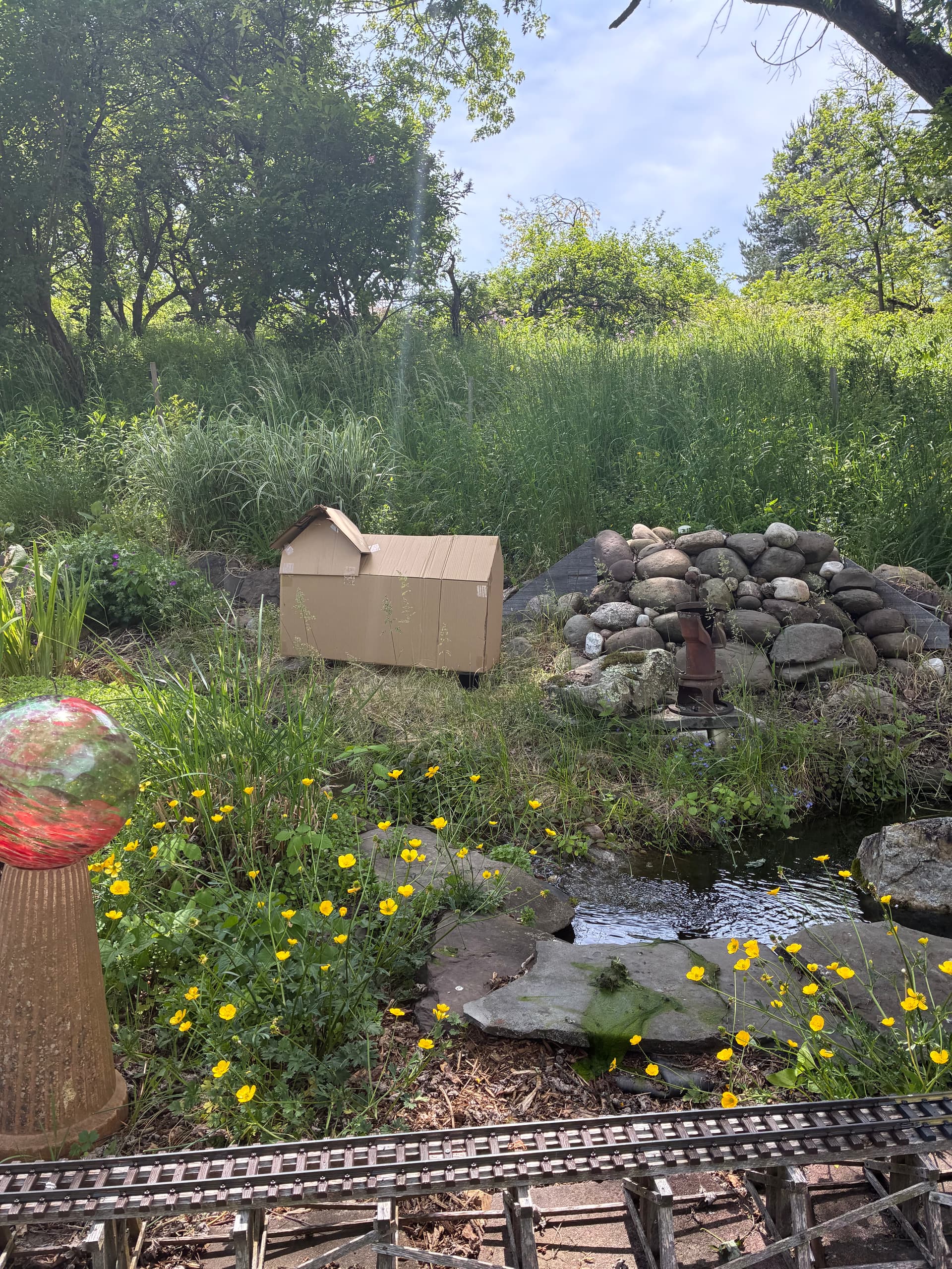

P.S. Why not just make a flat and not focus heavily on scale then? You could do a CAD mock up CAD being Cardboard Assisted Drawing then cut it out and play with it on the layout. CAD with duct tape is way cheaper than wood.
Hope that makes sense.
:rooster:
I am thinking about making it smaller not sure how that will look.
CAD is a good idea I think i will try that, I already draw every thing the size I am going to build it to make sure I like the proportions.

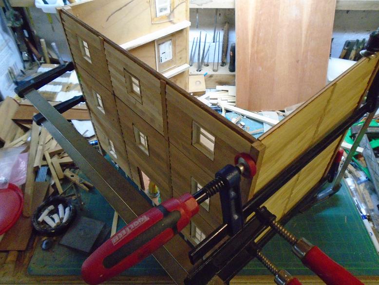

oh, building something big is no problem - just a question of time.
this here i started 15 years ago:

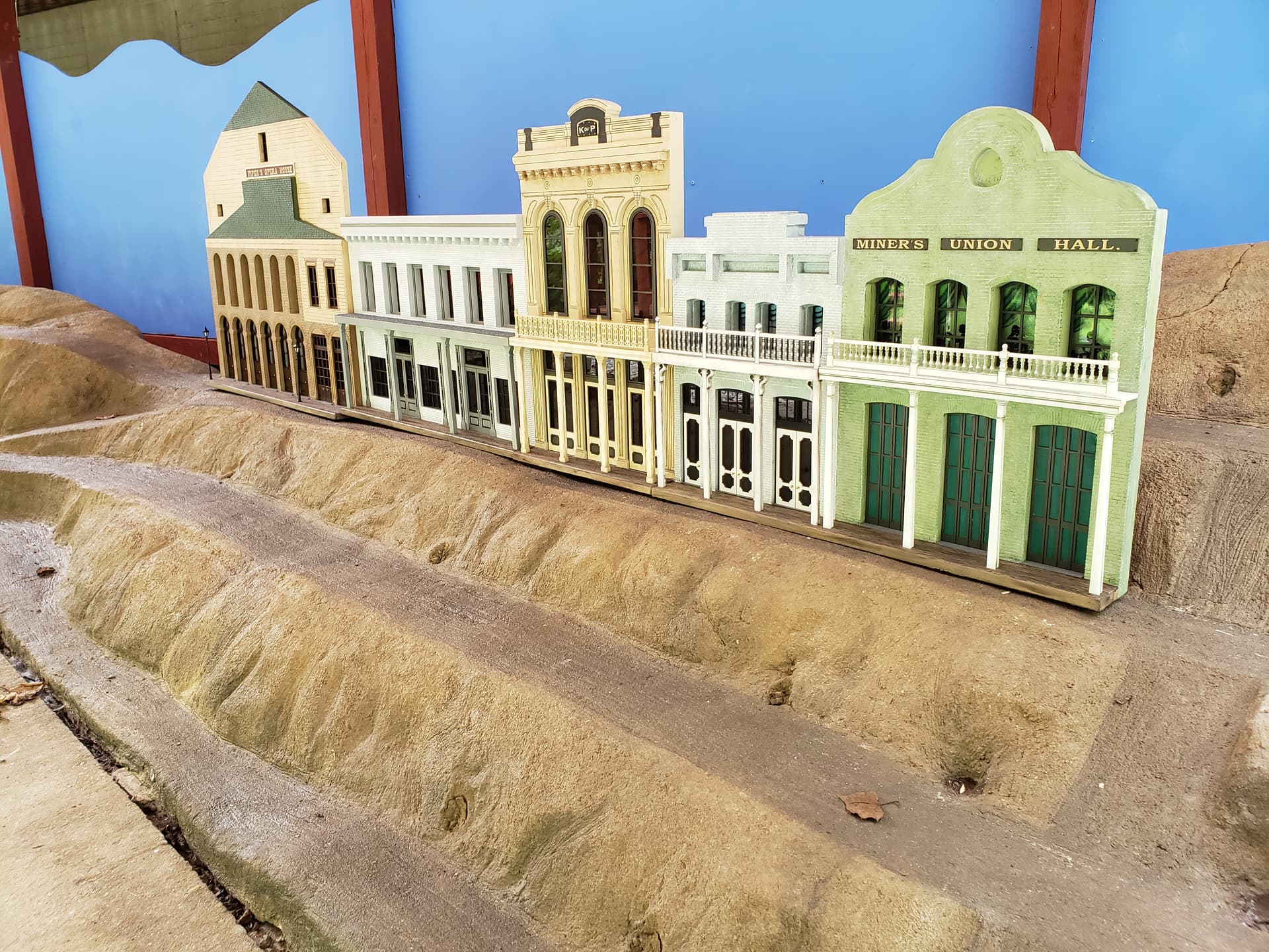

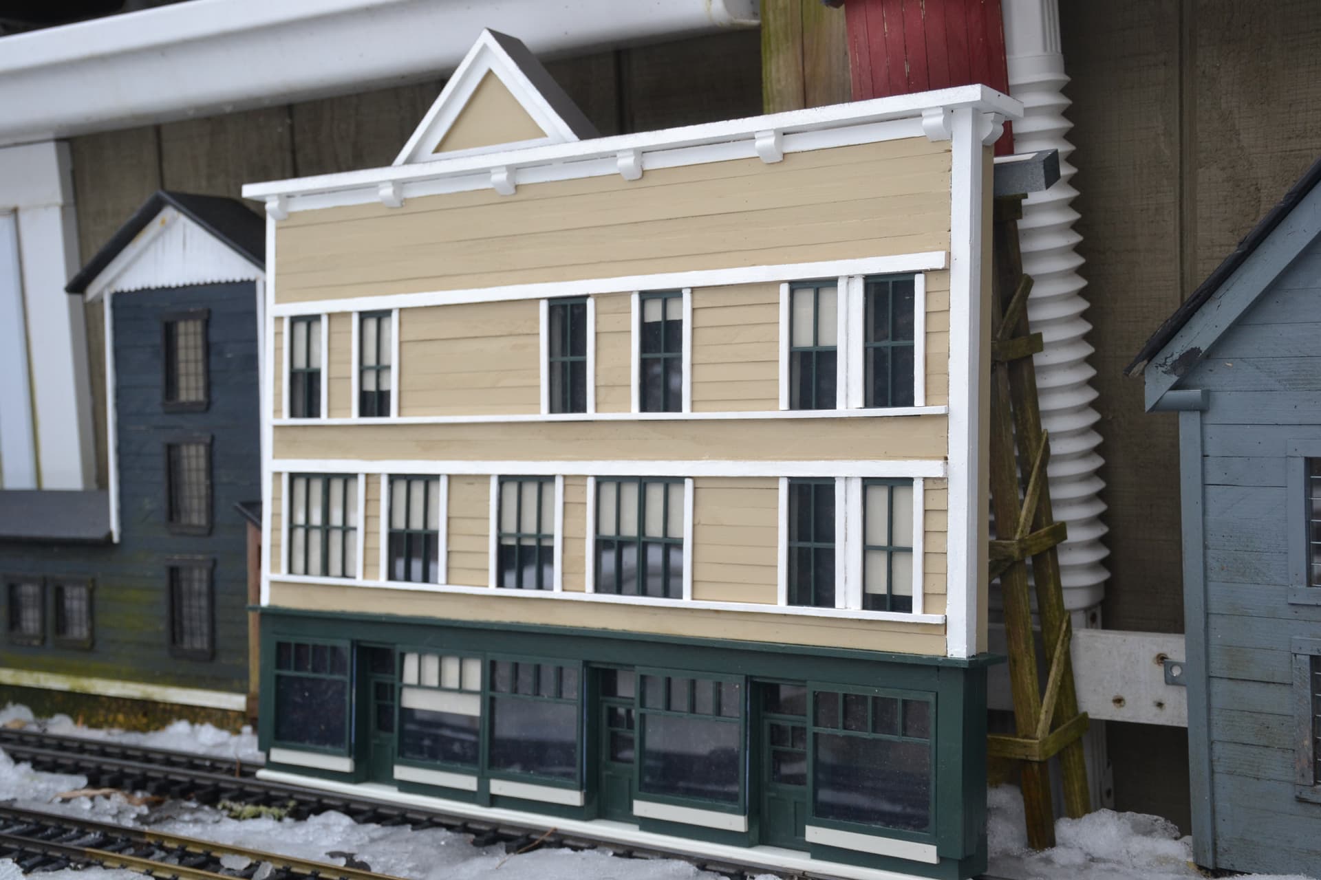

I gotta go with Todd on this. Here’s some flats / facades I did a few years back, based on historical buildings in Virginia City NV.

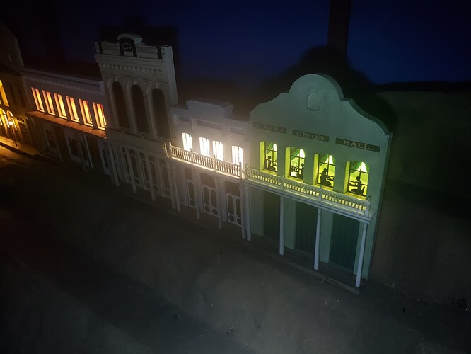

You can also install lights if you want.
To Bill’s point, I should have scaled these down a bunch, at least by a 1/3 if not 1/2. I scaled them 1/24 and they feel too big for something that’s supposed to be a bit distant.
You can get away with a lot of things, for background buildings. For big foregrond buildings I’ve eliminated doors, windows, even an entore floor.
Your cardboard mockups will definitely help you decide though.

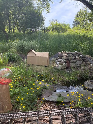

I have been doing 1:24 scale with my buildings, this is 1:32 and I cut the length in half from the original building. It kind of fits there but it makes my mountain look small. Not sure I want to do it in a smaller scale or what. It will be a winter project any way, so I have the summer to decide.
Nice use of the CAD!
However once again I would probably go 1:48 ( or higher) and put it on the mountain (perhaps make the mountain bigger with rock plants like creepers or herbs. Then light it up like a 24hr liquor store in Vegas.
Just my thoughts
