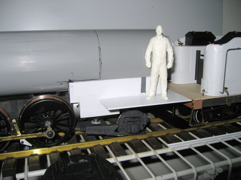

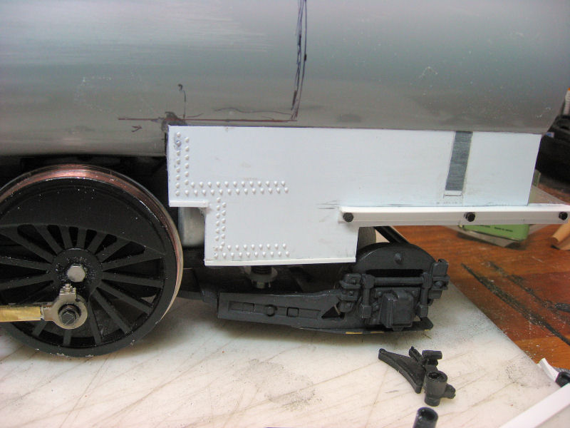

The mounting works well.
I was able to frame the nut so the boiler is easily removable. Next up is making it look half way decent. I cut some styrene to fit and added some rivets. The angle piece will be supporting the floor of the cab. I added some bolts for support as the tender draw bar will be attached to this and I want to make sure it stays in place. The line on the boiler indicates the forward edge of the cab. I didn’t add more rivets as the ones under the cab will be covered by an air tank.
I didn’t like the brakes that came with the Pacific, so I thought I’d make my own out of styrene and brass.
(http://www.jbrr.com/Pics/Locomotives/EBT/Locomotive/IMG_6695.JPG)
I don’t like the mounting right now, so I’ve ordered some longer bolts. I’ll use some brass tubes to hold the brakes away from the frame. I got the other side of the firebox done and mounted the floor of the cab in place.

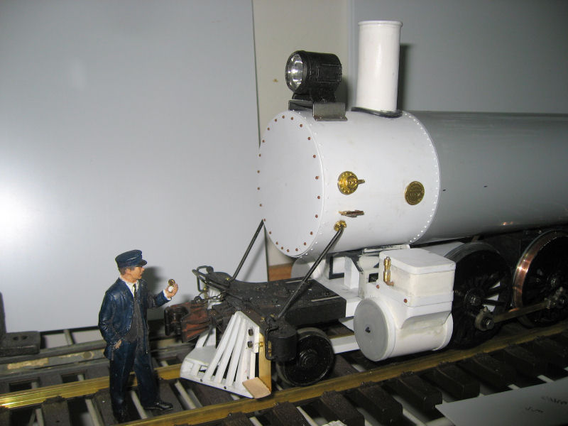

I also got a start on the front of the smoke box. I cut styrene to shape and added some plastic NBW that I got from somewhere. I still need to work on the door. Then I have to figure out a way to mount it so it’s removable.

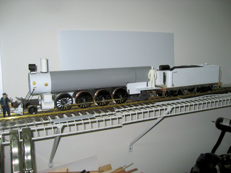

This thing is going to be BIG. Good thing I have large curves on my layout.
It’s going to be a bit longer than #15. The wheelbase of the Pacific adds about 1 1/2 feet to the overall length.

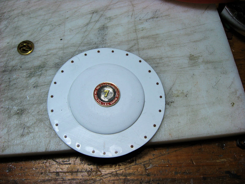

That looks more like EBT #12 with the straight running board. Mine will only be sort of close to all of them. I worked on the smoke box a bit today. I put the “door” in a chuck and smoothed it out. I have an old tie tack for a number plate, but it was for #5. I ground that down. I have a 7 from Trackside Details and tried that out - nothing is glued yet. I still need the smoke box dogs and some hinges. I’m thinking of getting the dogs from Ozark and building the hinges.

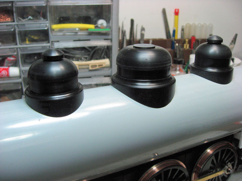

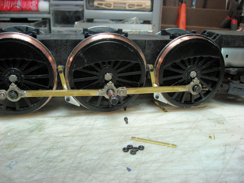

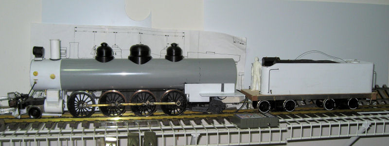

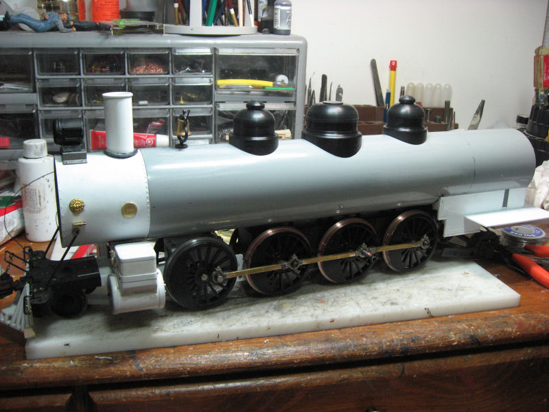

I’m sure learning a lot myself. I’ve spent some time trying to get the quartering right. I’m getting closer, but still some small binds. The wheels won’t turn without the motor, so I can’t freewheel it and check for binding. It’s a long process for me. But, today I got a great package in the mail - from Gary Buchanan. He had offered to make some appropriate domes for me; I had thought about using some Accucraft domes, but they’d have to be cut down. So, I sent some drawings to Gary and he turned out some absolutely gorgeous domes. When I saw the package had arrived, I immediately cut it open and took them out. Rushed up to show them to Jean. I don’t think she was nearly as excited as I was.
Gary had tapped each dome with a screw; I quickly removed them and placed the domes on the boiler. Sweet!
So, I did some measurements; I had to change the spacing a bit since my boiler is about 1 1/2 feet longer than the one on #14 and #15, but I think I got it right. I drilled the holes on the top of the boiler for each of the mounting screws. Next, I drilled larger holes on the bottom of the boiler - this allows me to insert the screw on top of a screw driver and connect it to each dome. I also drill a hole and used a bell from an Annie.
The domes fit perfectly. The sand dome lids are separate pieces and are not yet fixed in place. I’m thinking of using some dress maker pins to hold them in place and act as the handle on the lid.
Thanks again to Gary. Perfect.

What are you doing for weight? Did you use the weights from the Pacific?
I am considering using the weight from the Pacific. It’s big and heavy, but it should still fit OK in the boiler. I will need to drill some mounting screws to make sure it doesn’t shift. I also have some weights from a couple of Annies, so there’s a few options. I probably will wait until I’m almost done. Still a LOT to do.
