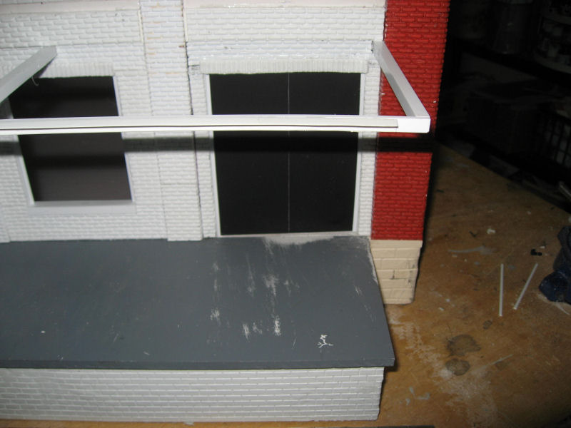

This is my second attempt at the cover for the loading dock; the first one was eaten up by the E-6000 cement. This time I used 3M Spray Adhesive. Still no word from USPS on my missing styrene. Though they did send me a customer satisfaction survey to complete.

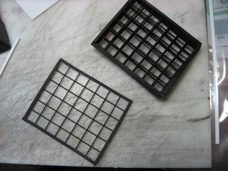

My second order of parts was actually delivered! Time to get some work done. Here’s a shot of the windows after being framed and painted.

I was going to build a fancy door for the loading dock, until I realized that I’d never really see it. Instead I scribed a line on a piece of foamed PVC and painted it black. I still need to add some escutcheon pins for doorknobs. But at least it was easy to make.

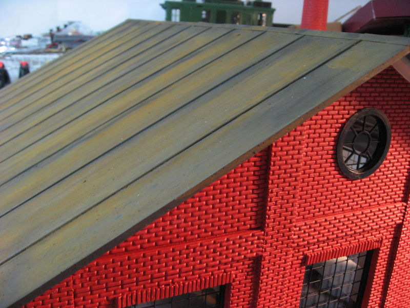

The roof is done using Sophisticated Finishes product. I use the iron surfacer first, followed by a couple of coats of their rust. Each coat has to take 24 hours to dry.
(http://jbrr.com/Pics/IMG_8966.JPG)
I debated adding another coat of the rust stuff, but I like the look; not sure that another coat might screw it up. Next, I want to put a wash of india ink and alcohol to tone down the colors, especially the cream. I also need to get some screen to put behind the round windows. .
Love the roof look. The rust will get worse/different/change over time anyway. It looks fine the way it is.
Excellent!
I really like the way the little bit of trim on the windows really finished them off, and that roof came out great. Nice work Brucce
Bruce Chandler said:Sounds like a point at which to wisely declare "less is more".
