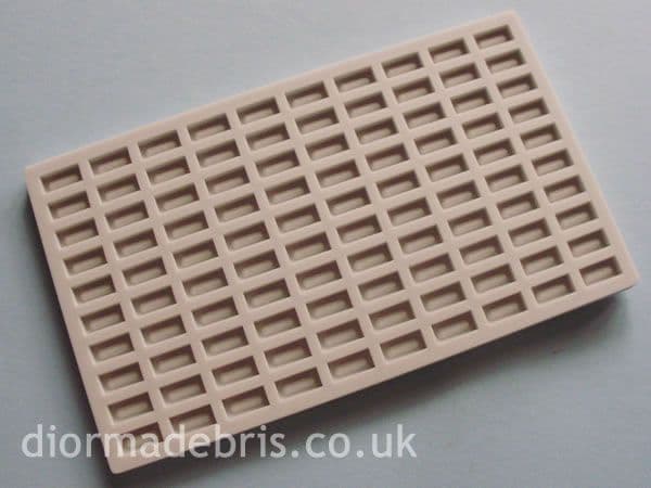

I haven’t used mine yet, but it looks to be quality.
