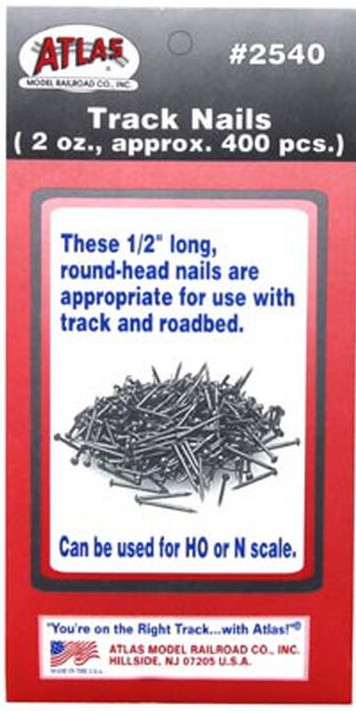

Atlas HO/N track nails at Trainworld $5 for a pack of 500 https://www.trainworld.com/manufacturers/atlas/atlas-2540-track-nails-2oz-unit/

Never thought of using the HO nails. I might have to get some and see how I like them over the sewing pins.
When you need a bolder rivet, bird shot can be glued into the hole …
I have used bird shot before and it looks great but like nails, pins and plastic rivets it requires individual hole or dimples which is quite time consuming, I currently have ordered and received rivet sheets from MIRCE and the are very easy to install, several at a time, the only down side to them is that they are not raised but seem to show up well through paint. As soon as I try some I will post back on the subject, mean while you can take a look at them on youtube and see what you think. Believe there were some raised one sold by WOW planes but they are no longer in business and I was unable to locate where their line went. Her is the youtube video of Mirce ones

Atlas HO/N track nails at trainworld $5 for a pack of 500 https://www.trainworld.com/manufacturers/atlas/atlas-2540-track-nails-2oz-unit/
Thanks for the link Boomer. FWIW, those look a lot like the #20 brass escutcheon pins I bought for other other uses. I just measured one, and it has a dia head of /078, and shank dia of .035.
http://www.woodworkingparts.com/number-20-brass-escutcheon-pins/
Whatever the product, you’ve inspired me to try it myself!
You have to watch, because those nails come from different suppliers (to Atlas) and so they come with different sized heads. The smaller size works great in our scales, but the larger sized ones are at least as big as the molded on rivets on the Bachmann 10 wheeler if not a tad larger. I am using sequin pins on a project I have been fussing with off and on. And yea, drilling out the holes for them is rather time consuming.
