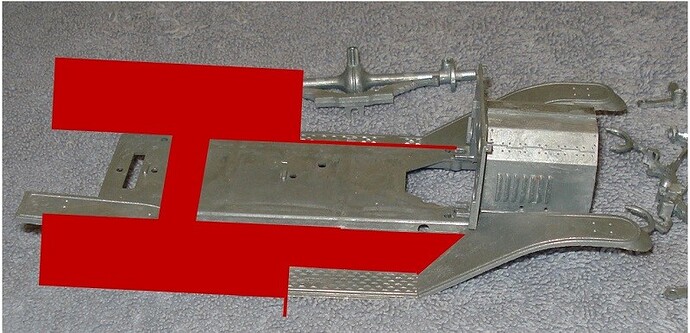

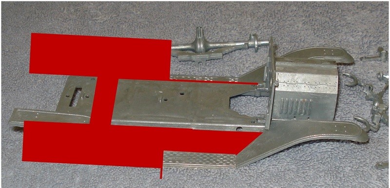

First I shall need the basics. A Hubley Runabout is the donor for this project. Only the frame, axles and front end will be needed. Not a lot of waste as that is most of the model. The bus pictured is a later model TT as evidenced by the round hood. The Hubley models are all flat paneled hoods.
For support I will keep part of the center frame section. Cut in two pieces this will give me firm attachment for the axles and body.
Off to the land of the razor saw!!!

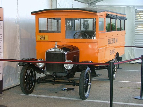

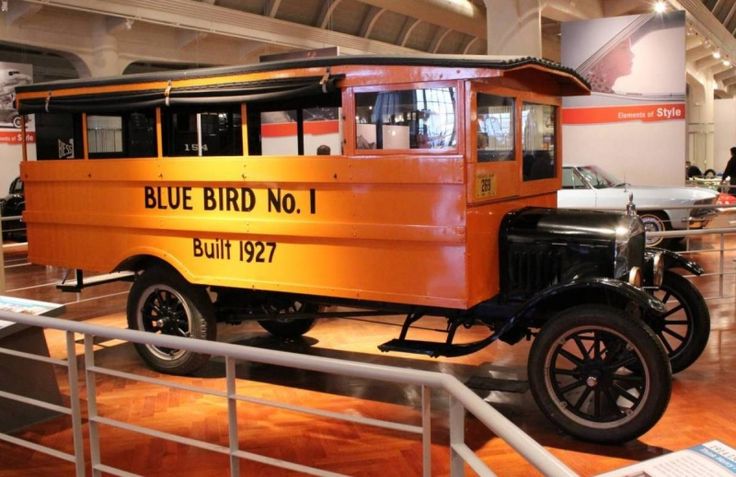

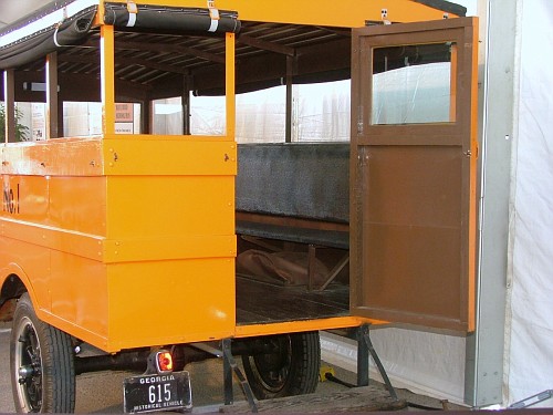

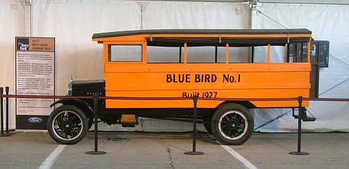

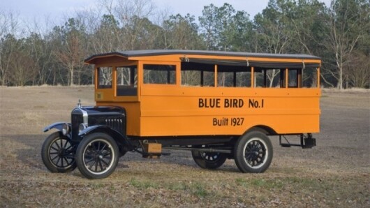

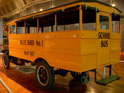

Since Hubley took care of the complex castings all I really have to make is the bus body. I was able to find pictures of the bus from all four sides.
bus 6
bus 7
bus 8
bus 9
Dimensions
Height: 84 in
Width: 67 in
Length: 207 in
So it is all flat panels with just a little arch on the roof. Single door in the rear. Fixed windows in front and tarps for cold weather. Shouldn’t be that hard to build right?..
