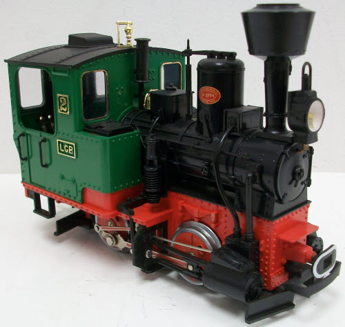

Which is why I didn't suggest a Stainz. Even though they're short, durable, weatherproof...and already red and green :lol:
Going to have to look up what those are.
Forrest Scott Wood said:
Mik said:
Which is why I didn’t suggest a Stainz.
Really?

Ah, that I can understand. I just found it… a bit different… Those things are probably what most folks not in the hobby think of first when people say ‘large scale train’. And why not? They were everywhere for at least 30 years.
Me, I just love the drives - simple, durable, reliable. The German styling I can take or leave… usually leave.
