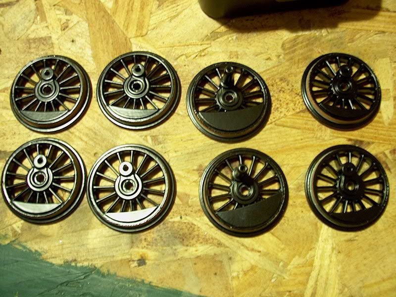

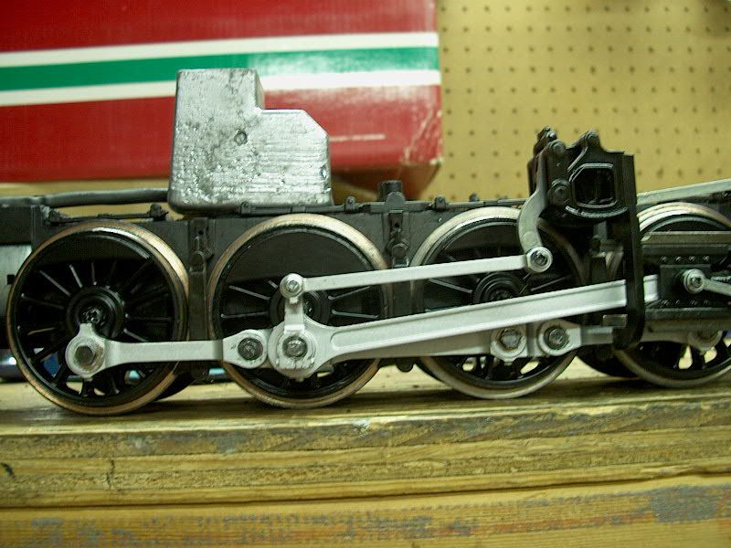

Wendell, I take all my wheels to work and powder coat them
(http://i23.photobucket.com/albums/b385/speedfreak1996/Kitbashes/IM002617.jpg)
(http://i23.photobucket.com/albums/b385/speedfreak1996/Kitbashes/EX000011.jpg)
I also powder coat my drive rods as well I tape off the flanges and tire areas to retain electrical conductivity and put silicon plugs in the screw holes and wheel to axle mating areas as well just another option
