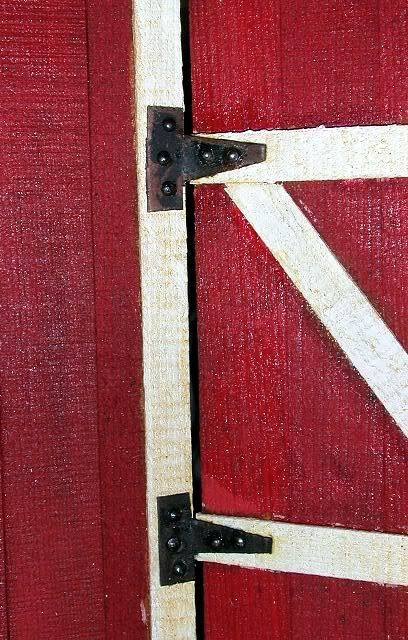

I use it on both brass and white metal but it works better on brass for me. It possibly could be a old stronger formula. These “hinges” made from sheet brass show the results I typically get -
(http://i113.photobucket.com/albums/n214/altterrain/hinge.jpg)
-Brian

Thanks guys. Looks like it used to be a good product. Brian’s hinges look great.
