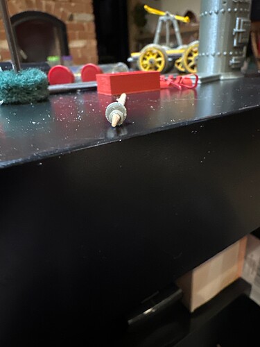

Last night I had to mount this cam on a toothpick to trim the brim away
The crank shaft needed the supports removed and I was worried about filing the shaft flat, so I eventually mounted it on my drill and rotated it as I filed the area for attachment of the cam. That worked quite well.
