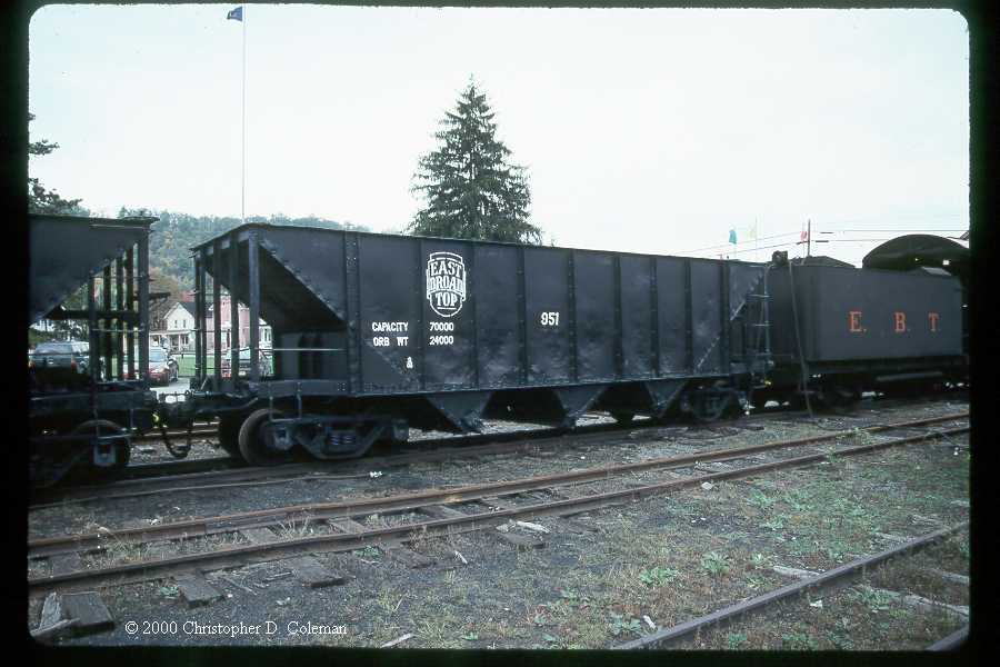

Some B’mann 3 bay hoppers came with a different truck…other than an arch bar…if you can find them they look fine for what you want. Kadee 820’s work well with them, and a string of them will be within a reasonable cost range over the other offerings. I forget the name of the trucks…maybe “Andrews”…they are supposed to resemble the trucks used by the EBT on some of their hoppers…the B’mann trucks on their EBT van are much the same, only with leaf springs.

The LGB hopper cars are models of an EBT 2 bay hopper, and look like an EBT hopper no mater what they are painted up as.

Fred Mills said:
Some B’mann 3 bay hoppers came with a different truck… [i]
Resident EBT Fan Here - They are Vulcan Trucks - A cast side-frame similar to Bettendorf, but not the same shape. From Chris Coleman’s EBT Website http://www.spikesys.com/EBT/
JR
