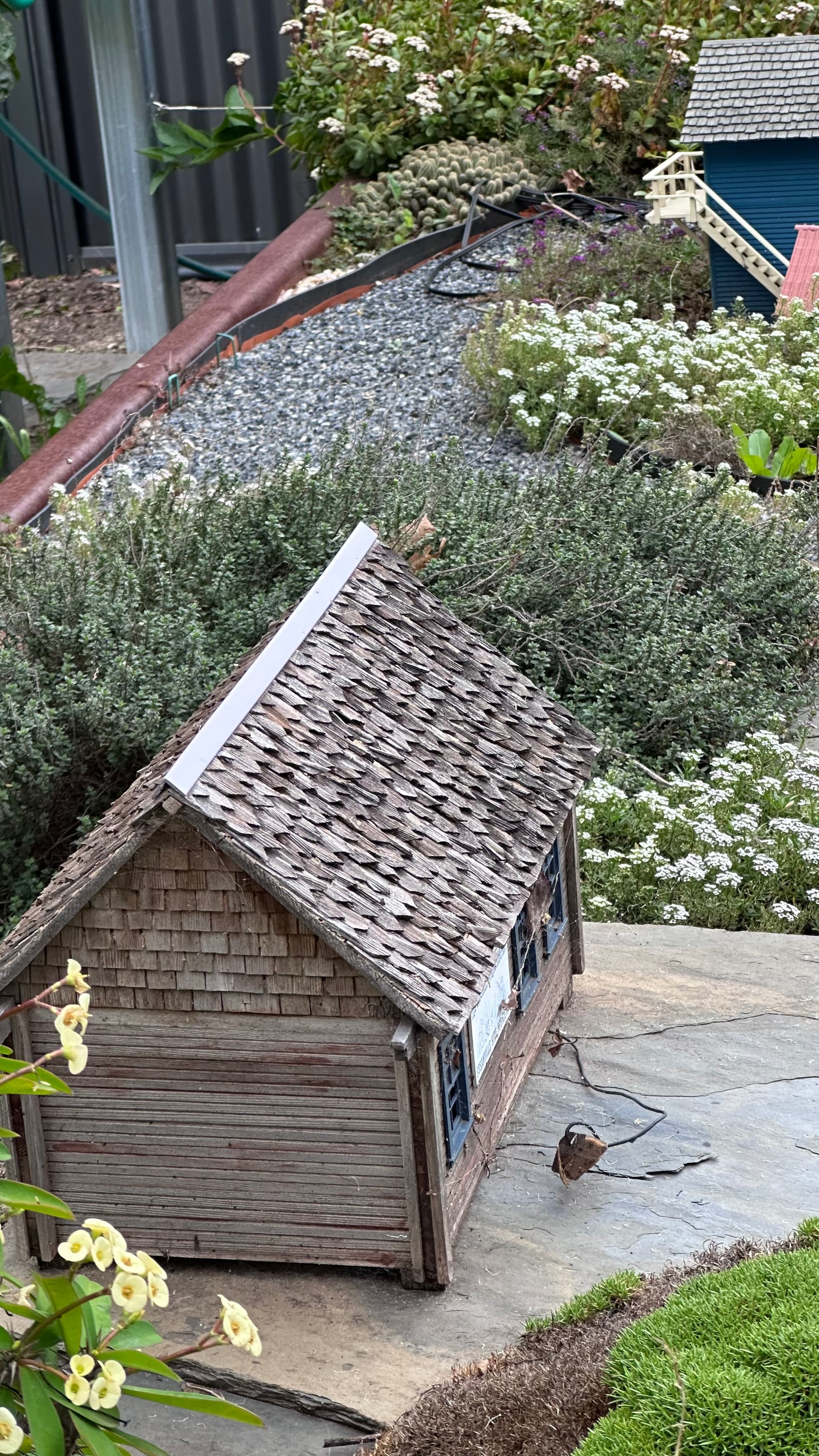

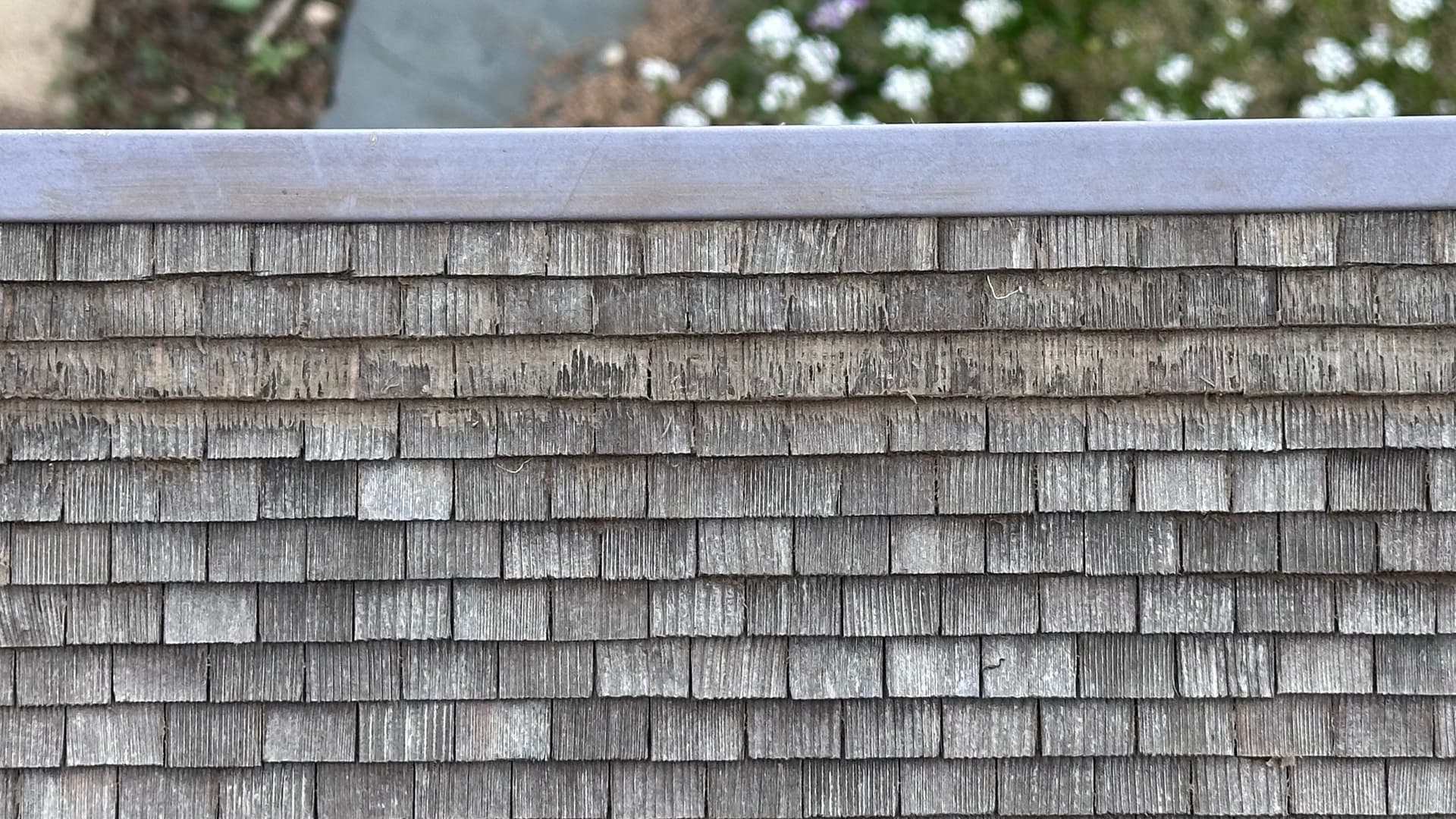

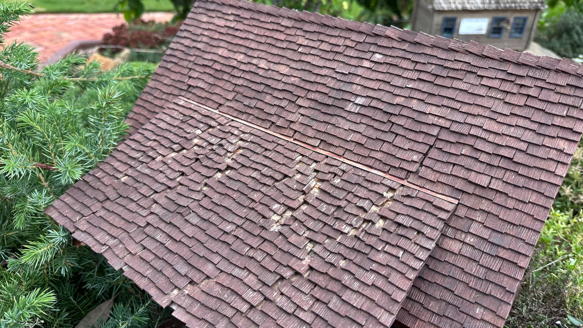

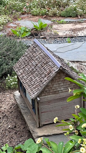

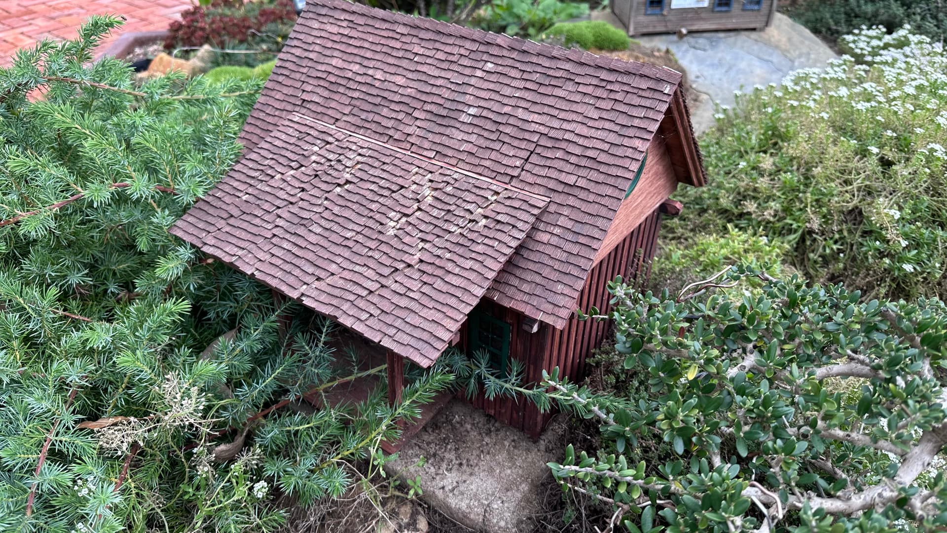

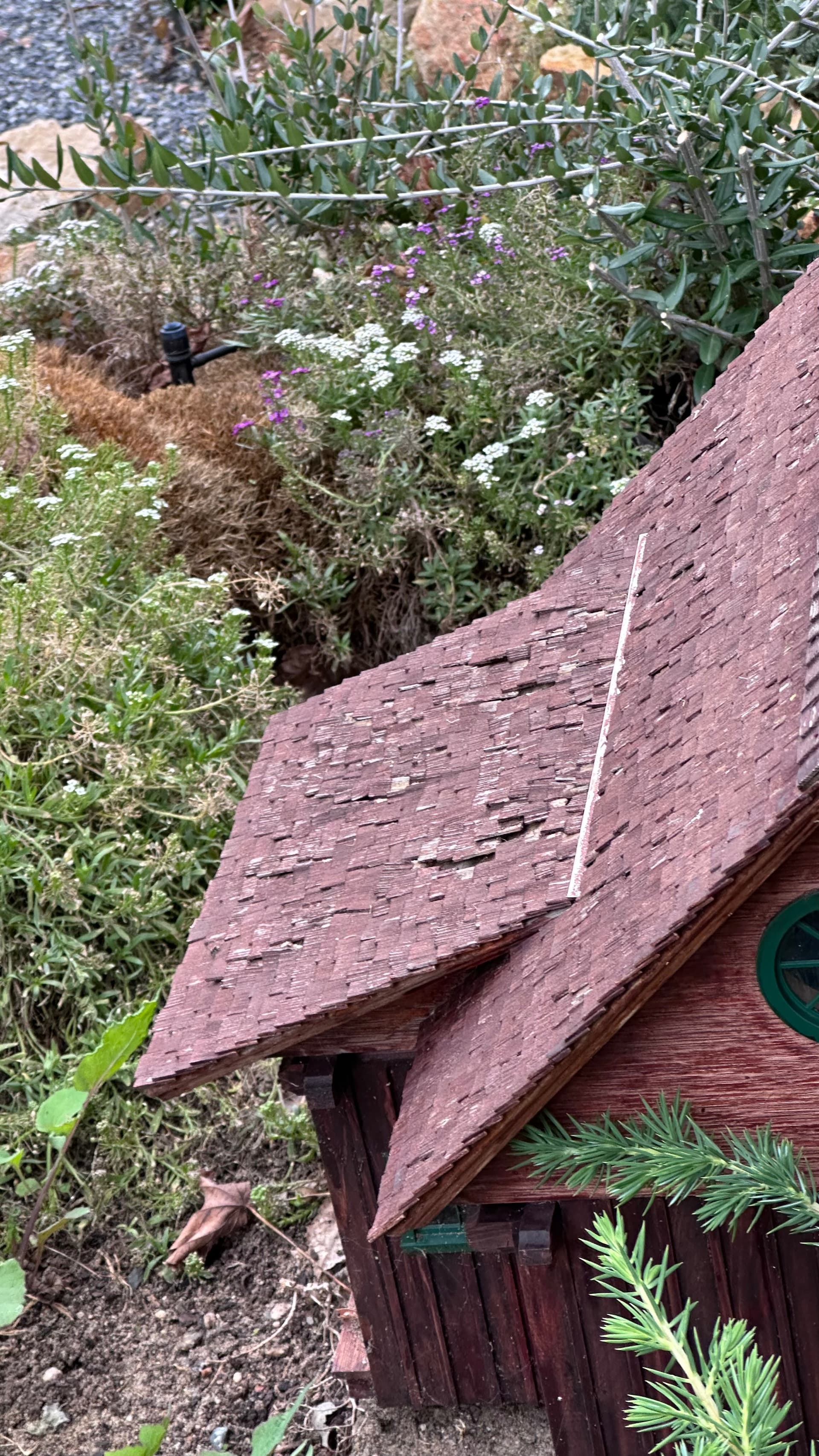

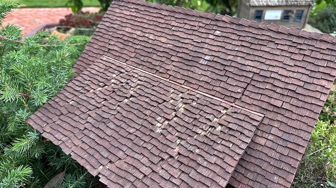

John, I noticed you were discussing cedar shingles about 14 years ago, so I thought this might be a good place to reopen the roofing topic and hear from you and other folk who may have actually had success with cedar shingle roofs outdoors long-term. I’d really like to hear from anyone whose roofs have actually survived outdoors for 5–10+ years, rather than just looked good initially.
I have a small number of large scale buildings with cedar shingle roofs that have progressively failed outside in the weather. The shingles themselves generally start out OK, but shrinkage and adhesion failure have been the ongoing problems.
So far I’ve tried:
  • Liquid Nails
  • PVA glue
  • Titebond III
  • Paint/sealer combinations (including Thompson’s WaterSeal)
  • Silicone
…and I’ve had troubles with most.
Oddly enough, the only thing that seems to survive for me is silicone gutter repair caulk, but it’s slow, messy, and not exactly enjoyable applying one row at a time. Plus that roof has only been outside 2 years.
For context, in South Australia we suffer from pretty harsh UV and dry heat waves, plus occasional light frost lasts less than a morning. In the Autumn & winter we get rain.

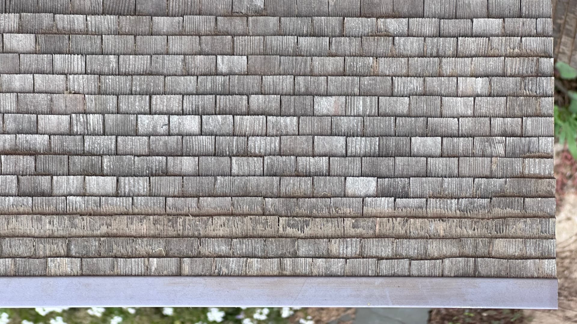

I use titebond III and a small staple for each shingle.
Then I paint a coat of TB III all over the roof to act as a sealer. It dries clear and flat. (as in no shine).
That is how I get my wood tenders to hold the wood pile together as well.
I’ll see if I can find some pics of the roof installation and post them.
