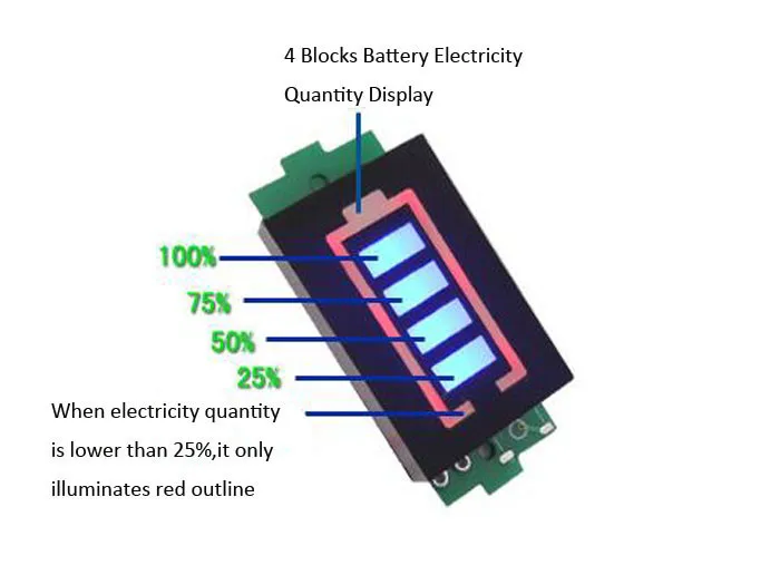

I was poking around my favorite shopping site, Aliexpress.com, when I found this little device:
For $1.59 it comes in a case and is set to show at a glance the voltage of your 4S (4 cell) Li-Ion battery.

Pete,
I am not an electrical engineer by any stretch, but this device is effectively reading the battery level at no load, given how we wire our locos to charging circuit vs. running circuit, which is not a good indicator in my book. need a way to look at battery strength when under load to get a good idea as to remaining life IMHO.
Al P.
While the open circuit voltage tells you a little about the battery, Al is right, although you could measure the voltage while under load with these gadgets.

So what you are suggesting is that I should mount them in the loco and watch them while it is running? They are designed to be circuit-board or panel mounted anyway, and not very large, and that was the original intent. I also bought a bunch of connector strips to make it easier to reconfigure these locos while I play with the batteries, etc. so that will make it simple.

I took the module to Jerry’s SC&MRR and ran it in the roof of my tram loco. This photo was taken as it ran past. You can just see that it is showing 3 bars.
