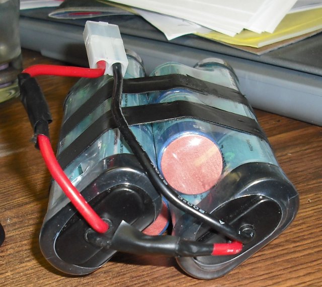

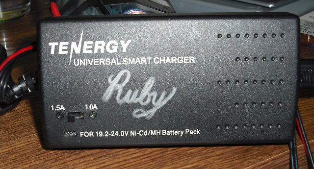

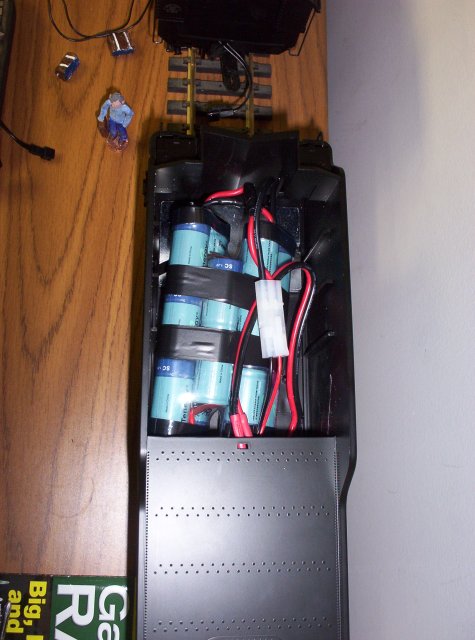

My favorite vendor is all-battery.com, but you’ll find good stuff at allbattery.com and batteryspace.com Pick your battery and get whatever charger matches it. For the NiMH packs I use, all-battery.com has a nice charger for $25. Since I can get to my batteries easily, I have 3 packs and just take them out to charge them.
