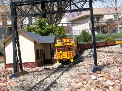

I use 1/4 inch pea gravel works just fine!
(http://www.trainboard.com/railimages/data/507/UPcab11.jpg)
I buy it by the five gallon bucket and run it through a 1/4 x 1/4 screen.

I use 1/4 inch pea gravel works just fine!(http://www.trainboard.com/railimages/data/507/UPcab11.jpg)
Don, Your “pea gravel” appears to have flat surfaces. Around these and many other parts, what is referred to as pea gravel is round. Ralph

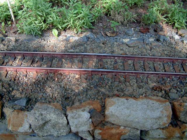

Hi Shelly - Welcome to LSC. There is a Tilcon quarry or stone yard near you in North Branford. The Stone Dust produced by Tilcon is “trap rock”, not decomposed granite, which I think looks better than the granite. They call it Stone Sand locally. It contains pieces from about 1/8" down to dust and works great for ballast. Home Depot used to sell a bagged product called Mr. Granite Step Two, made by Old Castle which was very similar to the stone dust. My Home depot recently changed to a different brand and the “step 2” is now more like sand. In any case, buying it from the stone yard or landscape supply costs much lass than bagged goods. Here’s a close up…
