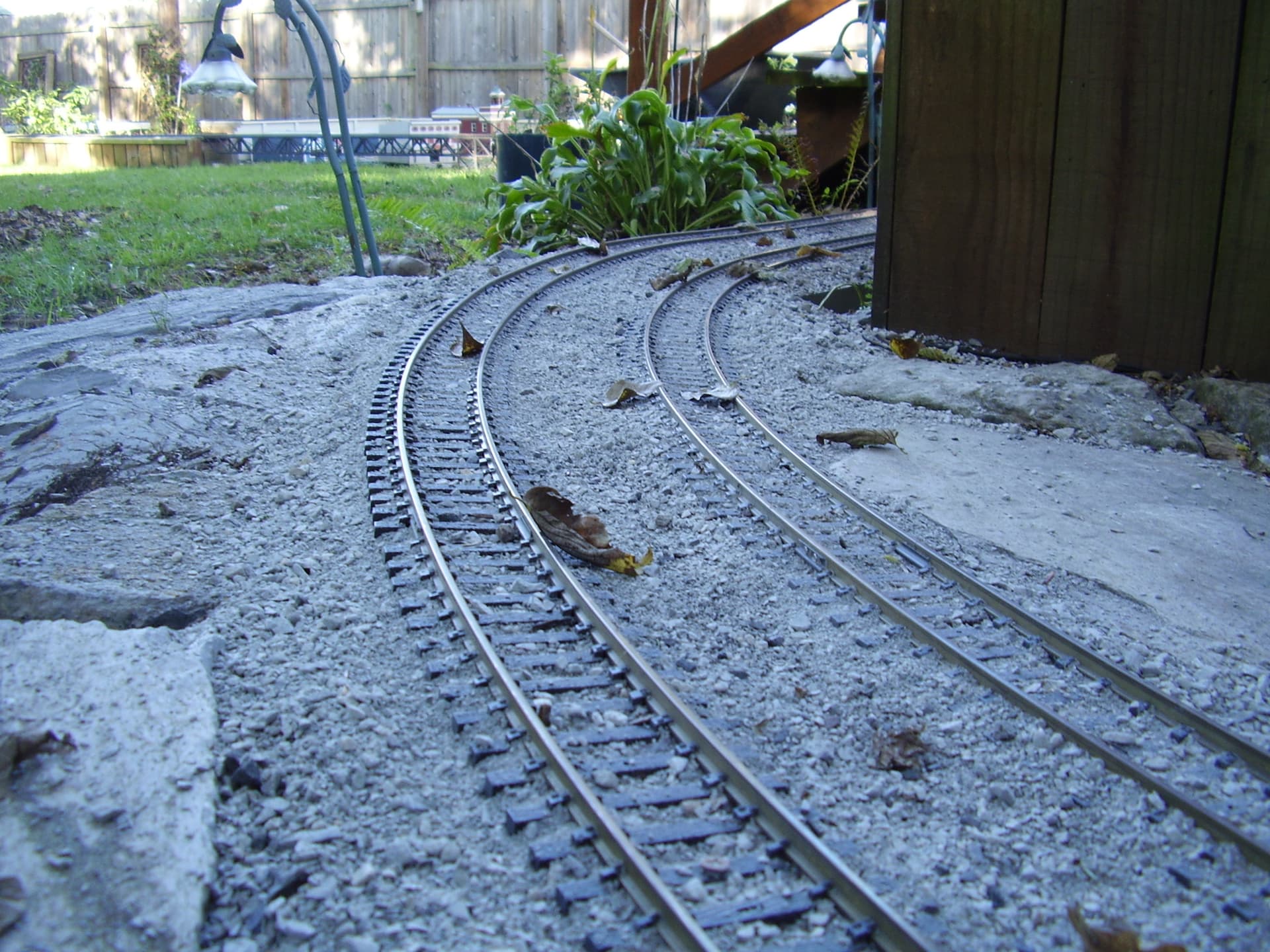

Glued ballast does not work well with four season outdoor layouts.
I tried a section of mine with tite bond III years ago as a test.
In the winter water under the ballast freezes and thaws, therefore raising the glued section into nothing but uneven track. Breaking track clamps. etc. You have to lift the track and bust all the glued ballast out of it.
My floating track on 3/8 minus ballast weathers winters just fine, with a little leveling and ballasting in the spring.
I also tried a section with a mix light mix of mortar and ballast and spread that with the same results as the glued.

John, I am thinking of trying a few sections anyway. on my raised roadbed rain seams to float the track and wash the stones underneath leaving the ties that are fastened down to break off from the rail. if the ballast was a solid mass it would not get underneath IMHO.
Al P.
I had used the mortar glue on the outer edges to form like a dam to hold the ballast in but it was free to move
