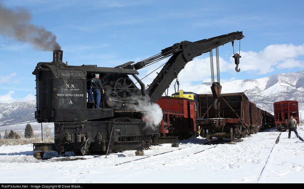

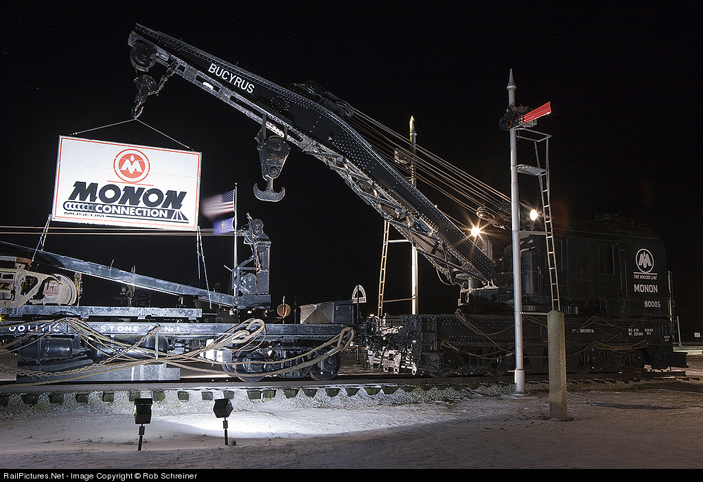

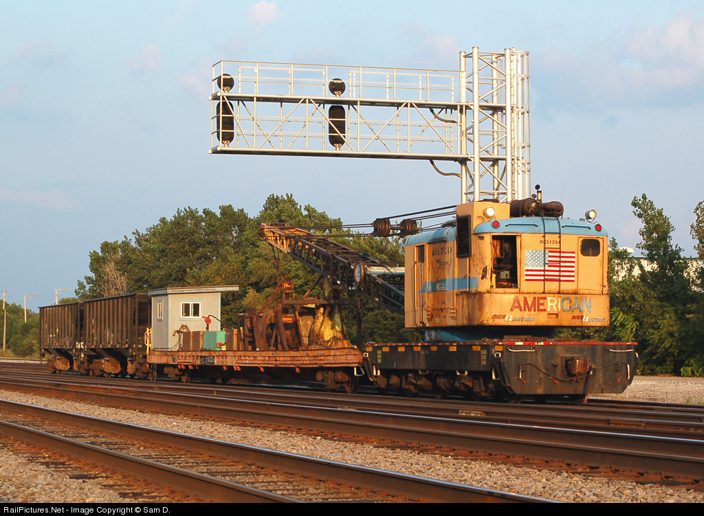

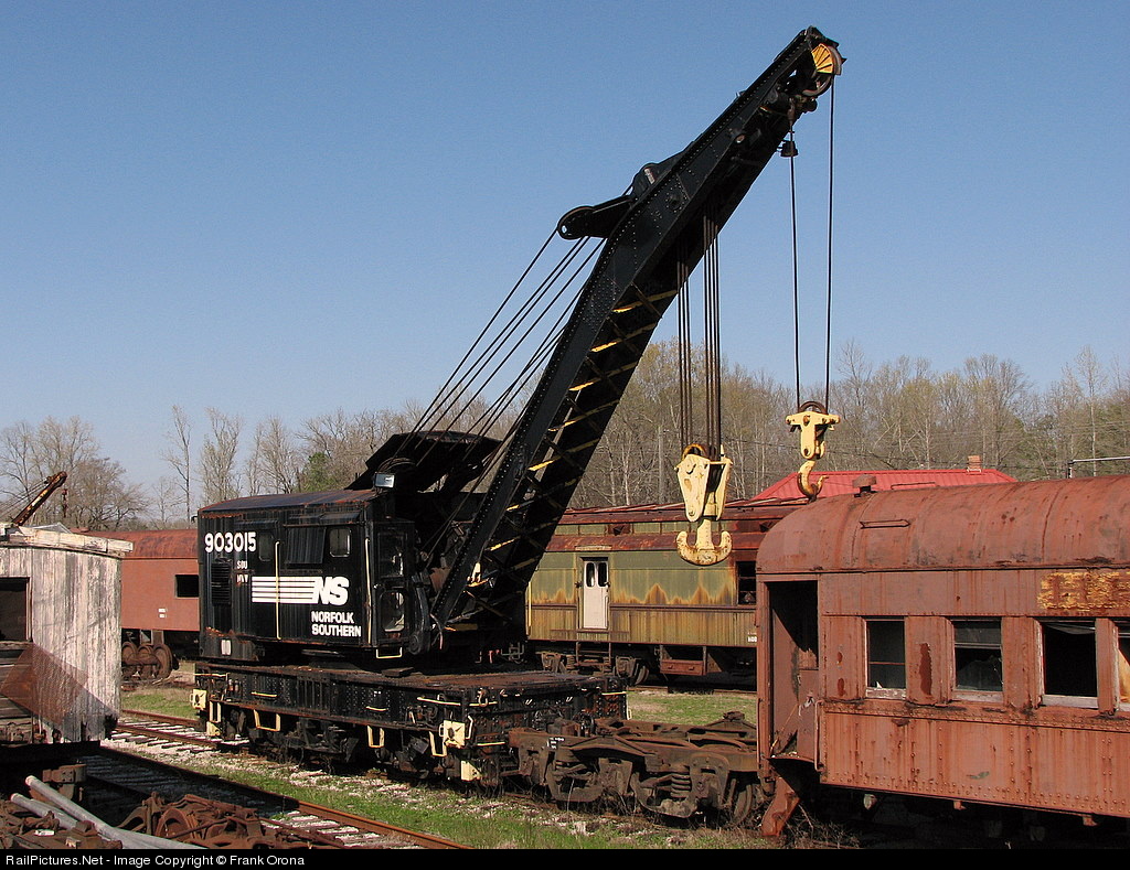

I got the same crane, and for the same reason. I’m going to get rid of that garish orange, paint it a more respectable black, take off the crawler tracks, and mount it on a flat car for duty as a wreck crane.
(http://www.railpictures.net/images/d1/1/7/8/6178.1257218527.jpg)
(http://www.railpictures.net/images/d1/8/9/6/3896.1250825914.jpg)
(http://www.railpictures.net/images/d1/0/7/9/4079.1239658257.jpg)
(http://www.railpictures.net/images/d1/0/4/5/6045.1228889952.jpg)
This will be a fun bash.
