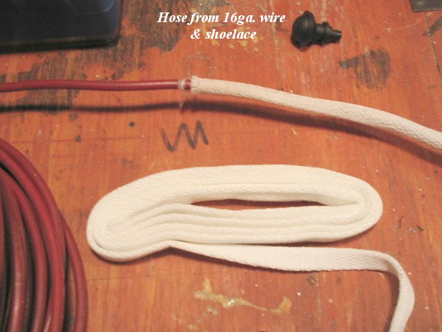

(http://www.trainweb.org/rgs/hose01.jpg)
For the hose I used a heavy gauge wire used for outdoors and covered it with a large shoe lace. As bart said it’s a suction hose not a fire type hose.
Those suction-type hoses are usually heavy rubber wall to withstand collapse from the suction’s negative pressure. They show a spiral pattern on the outside due to being wrapped with a rubberized fabric that protects the surface from abrasion. They are quite stiff, and really don’t look at all like a fire hose, because they aren’t a fire hose. They are typically a ‘light’ shade of black and get more gray as they are used and age.
The hose Bachmann provides is pretty good, both in terms of size and flexibility. I think it mostly needs the spiral covering, and some weathering, but I haven’t tried fixing one yet.
Take a look at the suction hoses on a fire engine. Those are the large diameter, almost rigid, black hoses usually hanging in brackets on the outside of the fire engine’s hose bed. They are better maintained, so tend to be more black than ones on a steam engine, but the stiffness and spiral pattern are similar.
