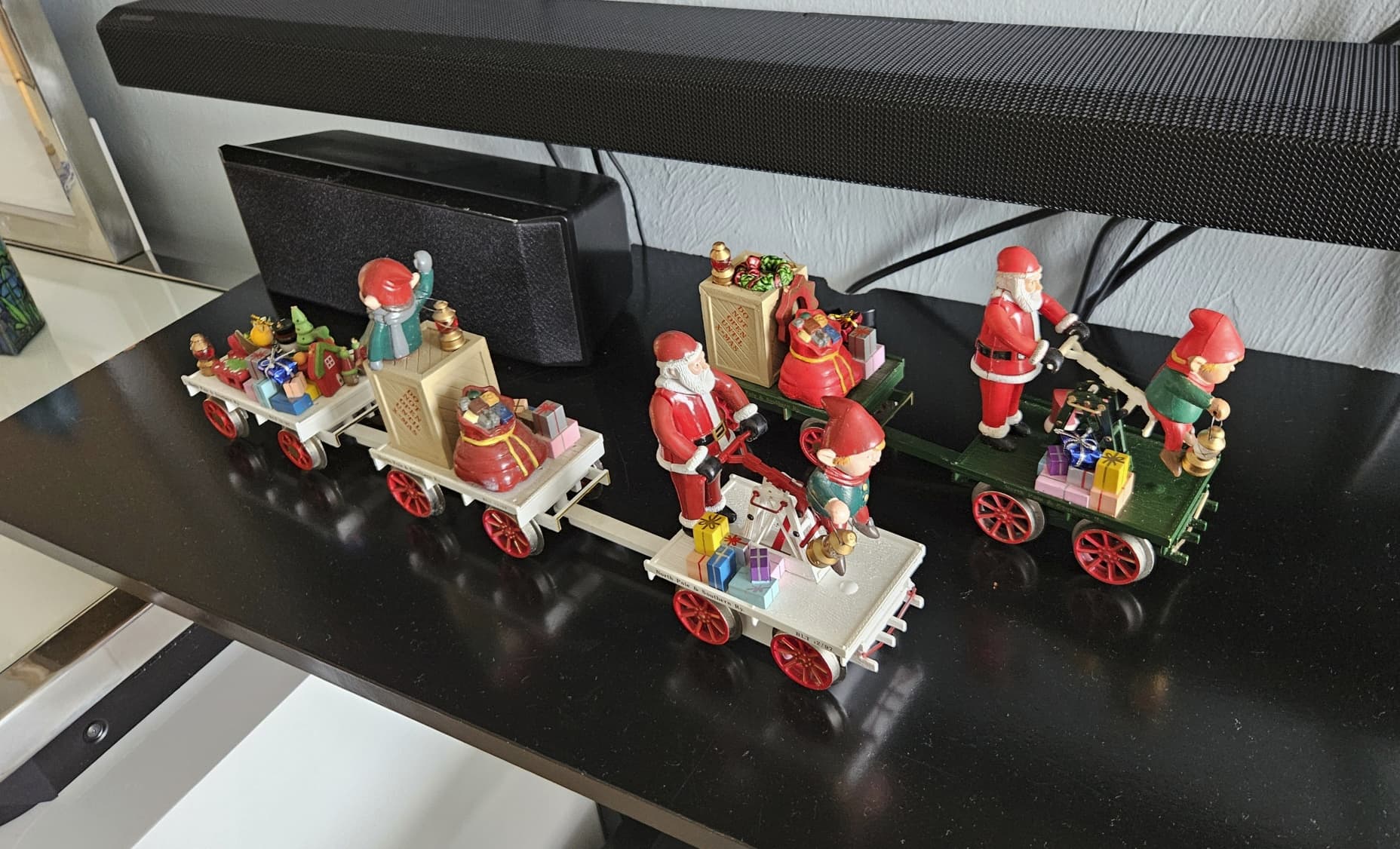

So this Project (#2 in the Florida series) is now over. The handcar works and is taking pride of place in the Christmas decor.

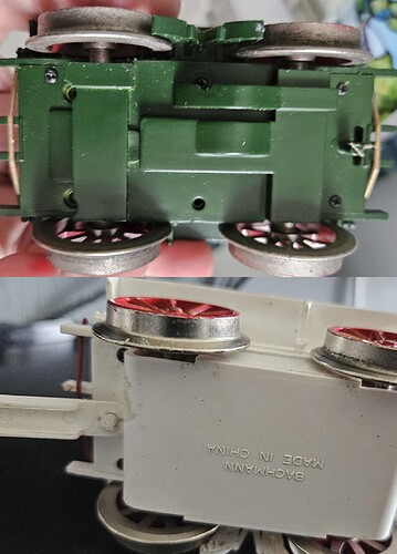

The green one refused to let me open it up. For some reason it has a different drive train. Cracked gears as well, by the feel of it.
I did read an old thread from someone who found a 3rd type of drive!
Note: it only takes pride of place until I find the young ladies who go with my FWRR loco. Rumor has it they were taken back to MD.

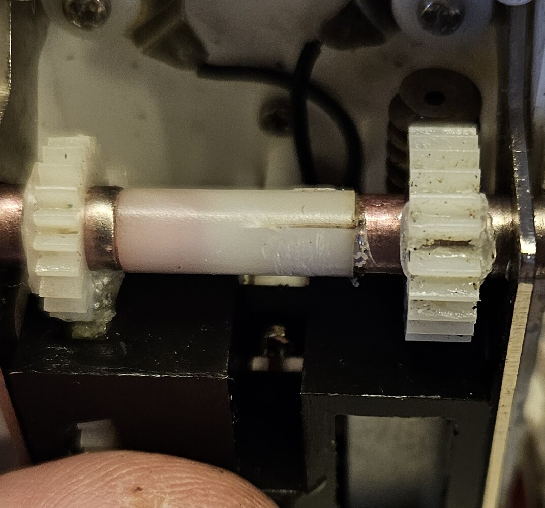

@PeterT Perhaps I missed it but did your fishing line fix work? Or did you end up sending the gears to Jiro?

Yes indeed. It ran that Christmas. I don’t use it very often though!

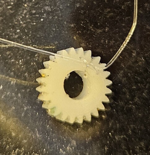

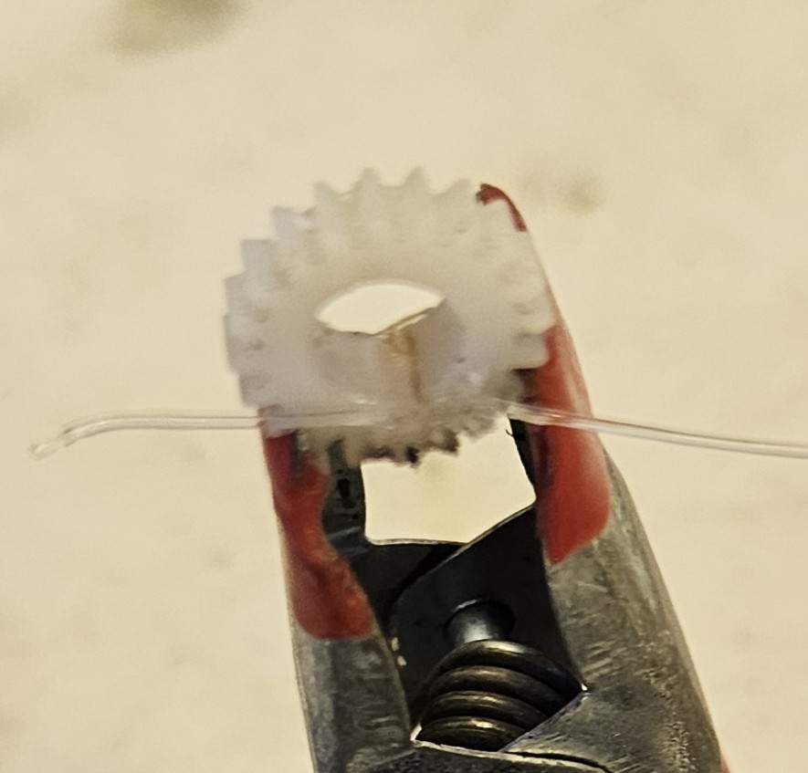

I’m not clear how you applied the fishing line. Can you please elaborate?
with gear in relaxed state, wrap the fishing line around the effected area, applying super glue as you go.
In my case I drilled holes either side of the split, and then tied it tightly with fishing line.
The glue was added once it was tight. I used a small clamp in the teeth to hold it closed while the glue was setting.
