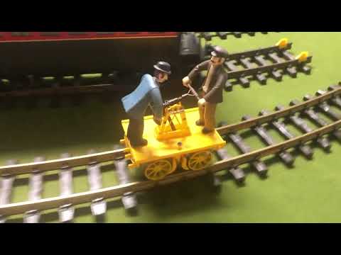

I did buy a parts Hand Car for less than $40 but found it had a ‘pancake’ vertical motor! With the initial rubber belt drive and the box motor, this made at least 3 driveline types. No wonder parts are hard to find!
It was advertised as ‘runs great’ - a disassembly and lube job got it up to ‘good’.
Video

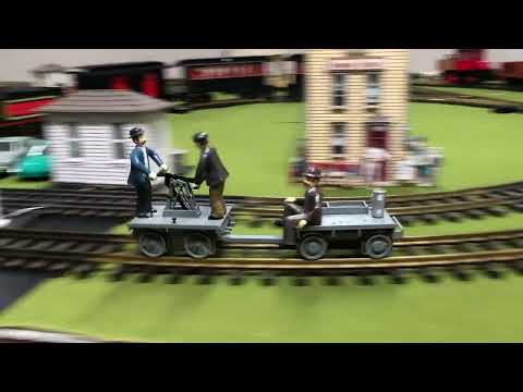

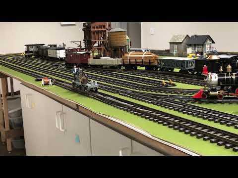

After a lot of looking, I had to search AliExpress and found these motors, apparently rescued from the back of a rusty container. But they were cheap.
12V 1.5mm Diameter Shaft Magnetic Electric Mini DC DIY Worm Motor 13,500rpm
5 Pieces $11.09 shipped AliExpress
The worm gear on the replacement motor had to be removed and the two Bachmann worm gears installed. The new motor fit quite well in the Bachmann motor carrier. I used washers to fit in the bushing recesses.
It runs okay, considering the Rube Goldberg complexity and age.
Electrical contact gets lost on LGB R1 turnout dead spots at slow speeds.
