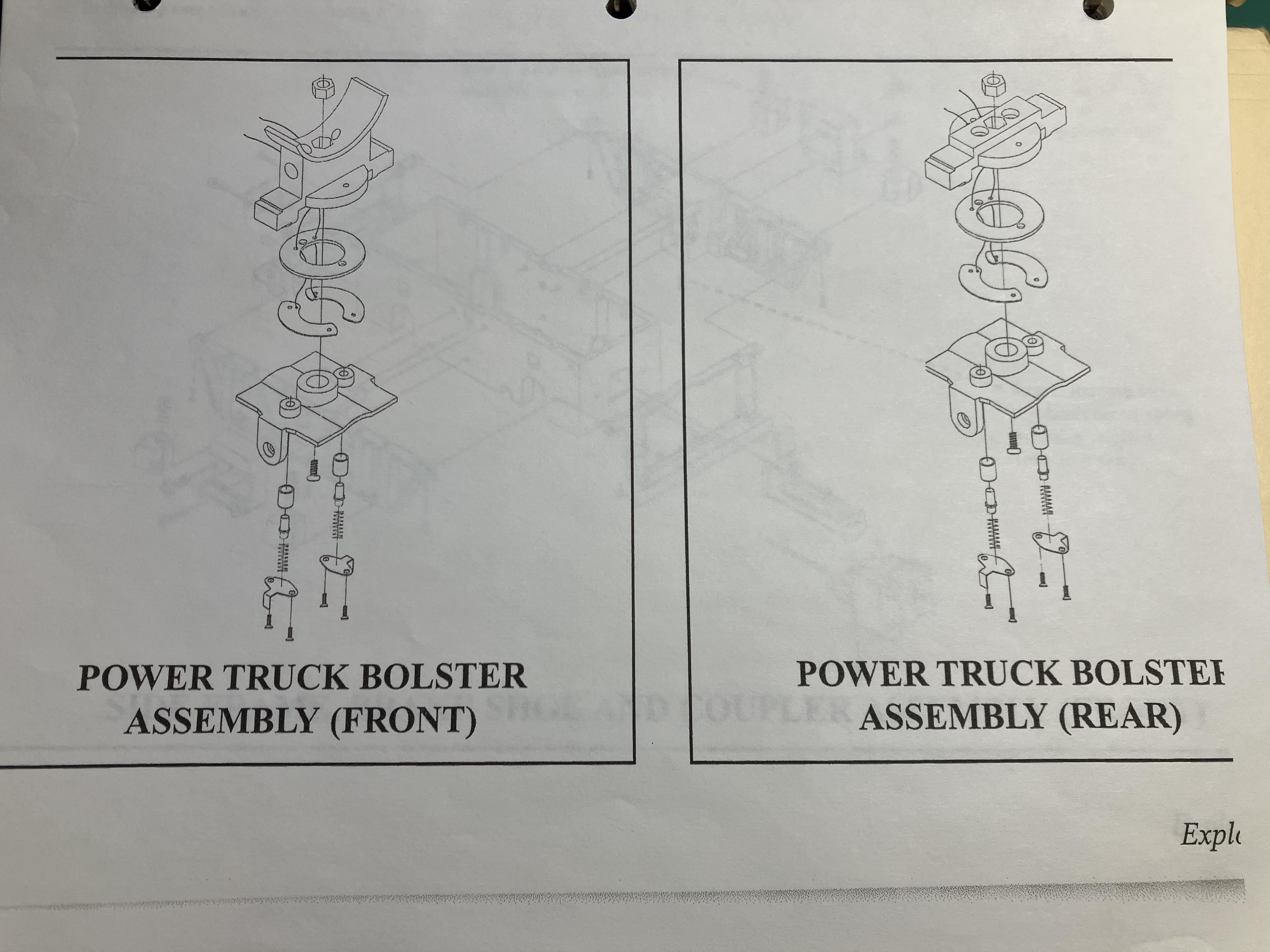

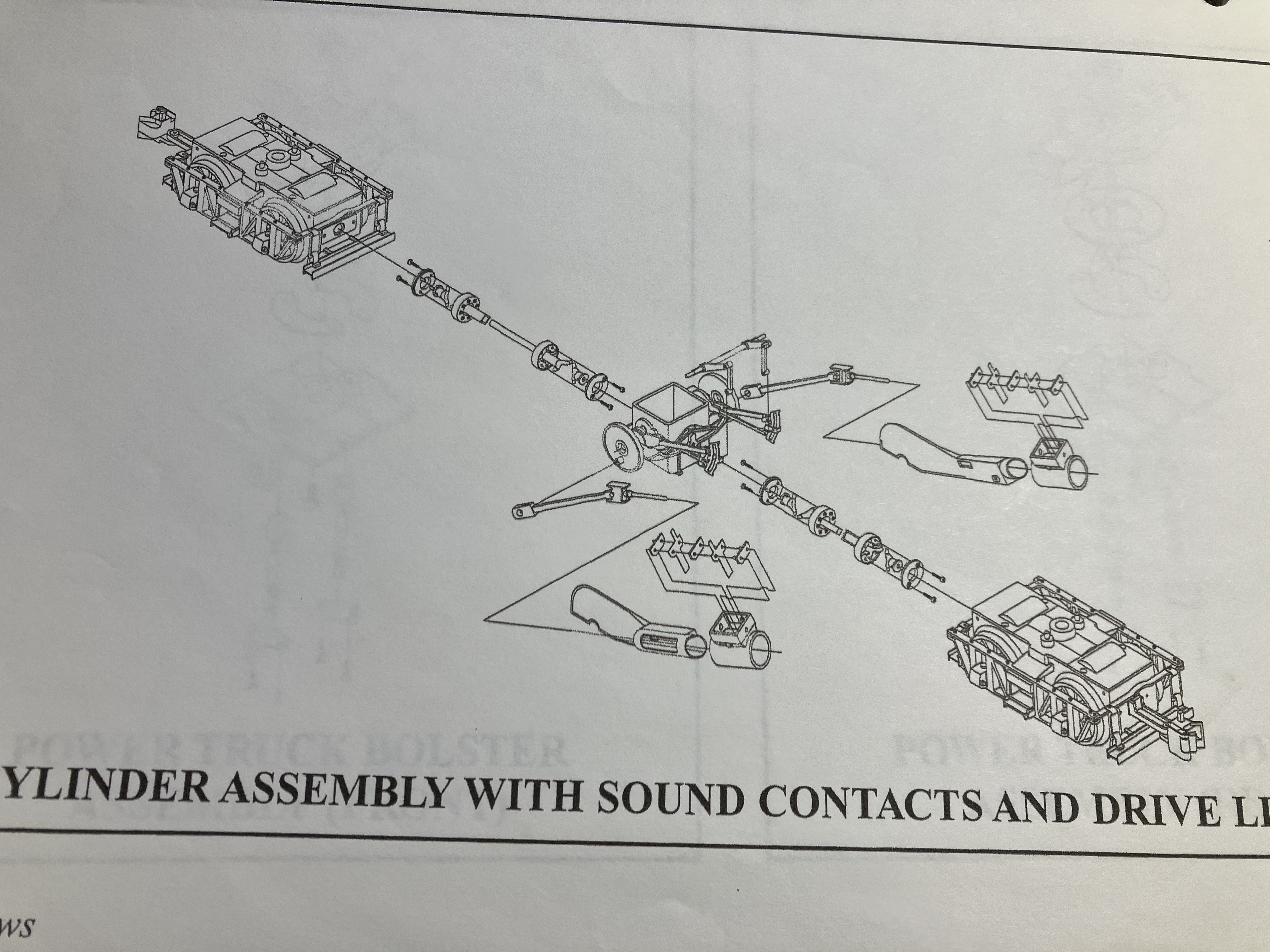

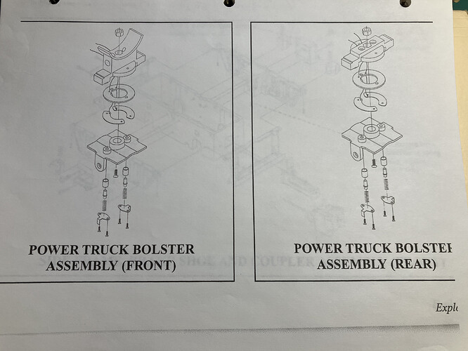

Like John it has been a long time since I worked on my Climax engines but here is some info I have on file regarding truck removal.
From TOC
From Bachman book
May or may not be of help.
