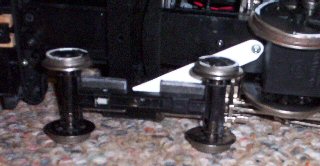

I have a Bachmann 4-6-0 that had an unfortunate accident. The four front wheels jammed in a switch where the front pin that holds them on was broken off.
I have another Bachmann 4-6-0 that I can use for parts. Can I replace that part that has the four front wheels? I looked it over last week and couldn’t find a way to get it apart.

The boiler and the cab have to be removed to get to the screw holding the pilot truck.
Just remangle the thing:
(http://www.outsidetrains.com/mls/AnnieTruck.jpg)
It’ll even track better this way.
Ummm no…just take the bottom plate off, the pilot and all should come off too…

It can be done either way. Bart's way is much easier though. Ralph
