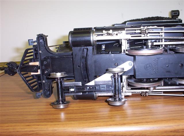

Oh yes… I remember. I took that spring thingy out and put a bar to push the truck along. I have a photo somewheres…
(http://www.outsidetrains.com/mls/100_1776S.jpg)
