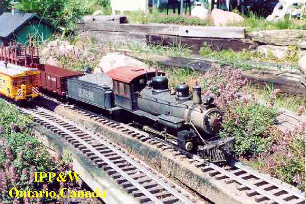

This is a about a 2nd generation Big Hauler, came out after the original that was RC/battery powered. It was a “Prairie Flyer” set.
Bought it in 1988, installed a BBT 460 in 1992 or 3.
