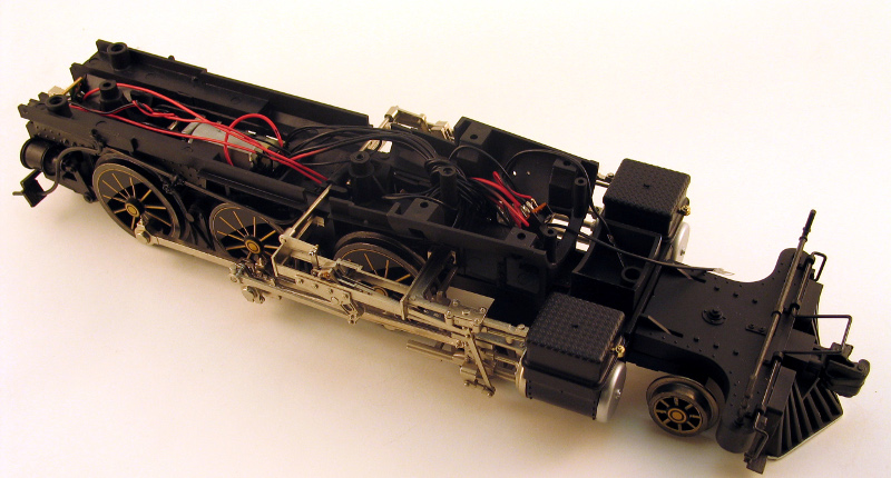

I also have 3 of the 4-6-0s from Bachmann one is a great runner the other two have been set aside for projects due to broken running gear. One of those I had already repainted and done up as a Halloween train and the other is being converted to a camelback. Today much to my delight I found that Bachmann has begun selling “annie” complete drive train with motor and all metal parts on their website. After doing a quick check on the location of mounting screws for the body, I found that I would easily be able to use these drives. At $50 each thats one heck of a deal over replacing everything individually

I received my $50 Annie chassis yesterday and converted one of my generation 2 4-6-0’s to a Gen 5 Annie. Basically it was a direct swap except for the air tanks. I had to shorten them due to interference with the cylinder valve boxes. Also a few screws need to be different lengths and I needed to solder in a head light bulb. It runs great and pulls great too!

Are these the new Annie chassis with metal gears ?
Wow, $50 for em? I may have to get a couple.
I ordered one. If they have the metal gears, I’ll order a couple more
But even if they aren’t the latest Annie drive, it’s a good deal.
They also have a $30 chassis. This looks to be a Big Hauler chassis.
The drivers in that image look odd–they look like flat disks with the spoke painted or printed on:
You’re right Mike. I sure hope not, as that’s the one I ordered
I hope that’s a pre-production photo
There are others that look “normal”.
