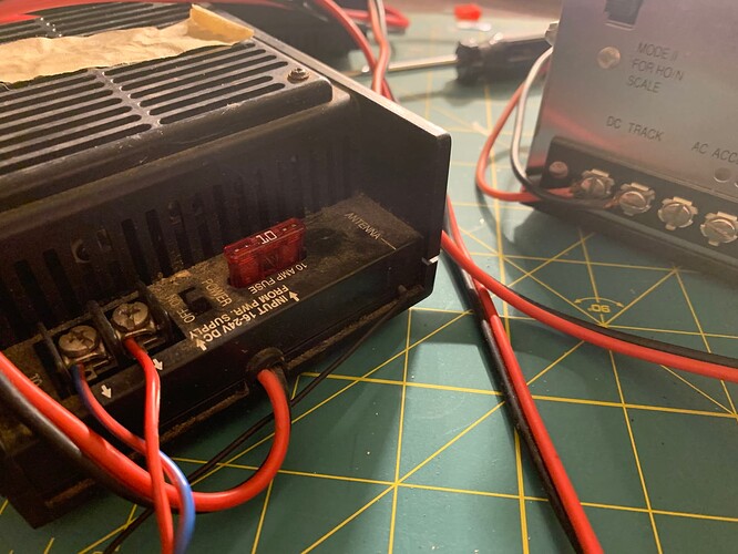

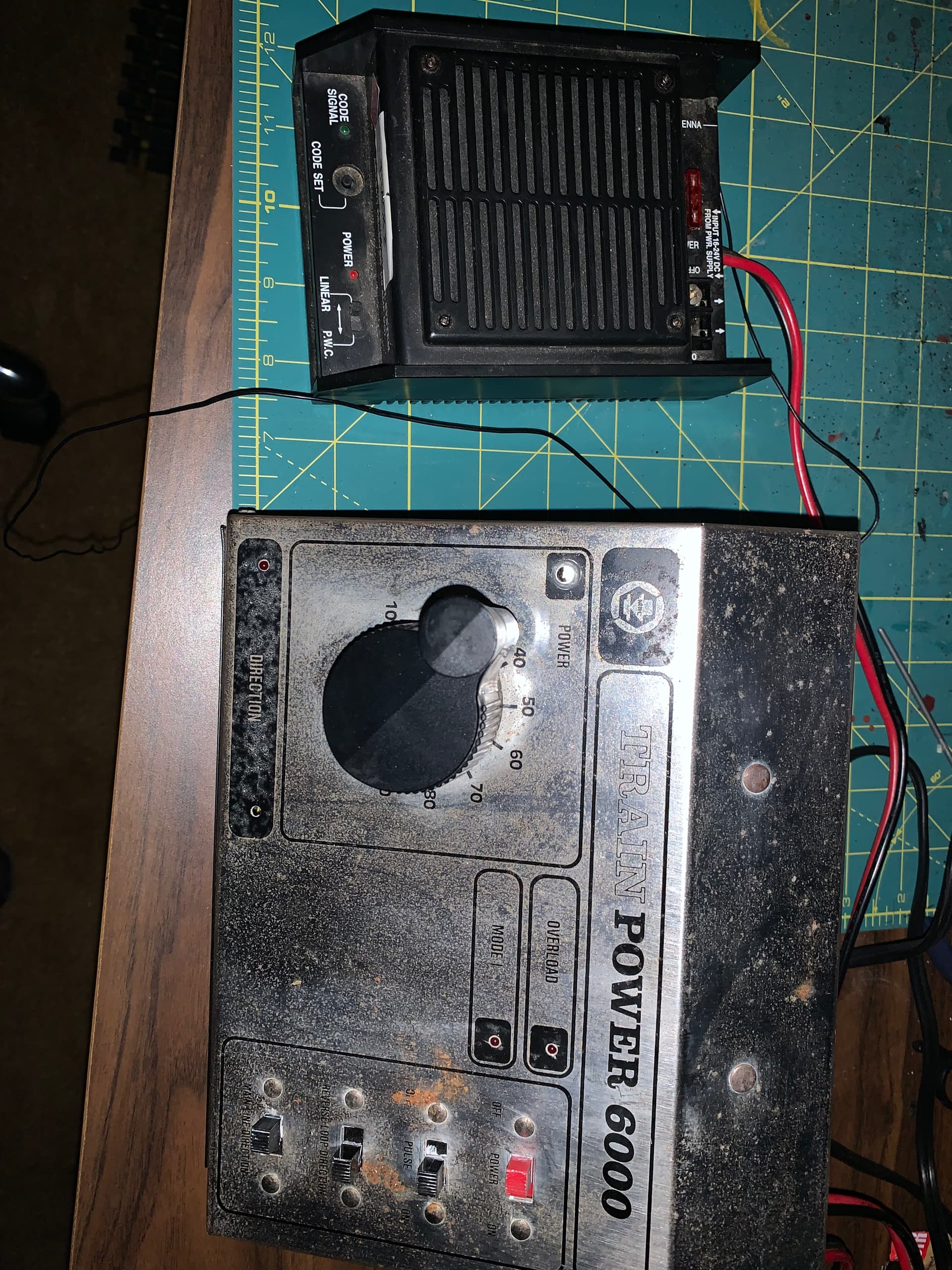

If you could post some pictures of what you are working with it would avoid a lot of confusion.
Basic train engineer ART-5471 receiver
And the last power supply tried train power 6000
Well considering you have used different power packs I’m not sure. However I do see that you have this one switched to “Pulsed Power” which could be the problem. You need PURE FILTERED DC output. Can you show us the wiring connections on both your power pack and TE receiver.

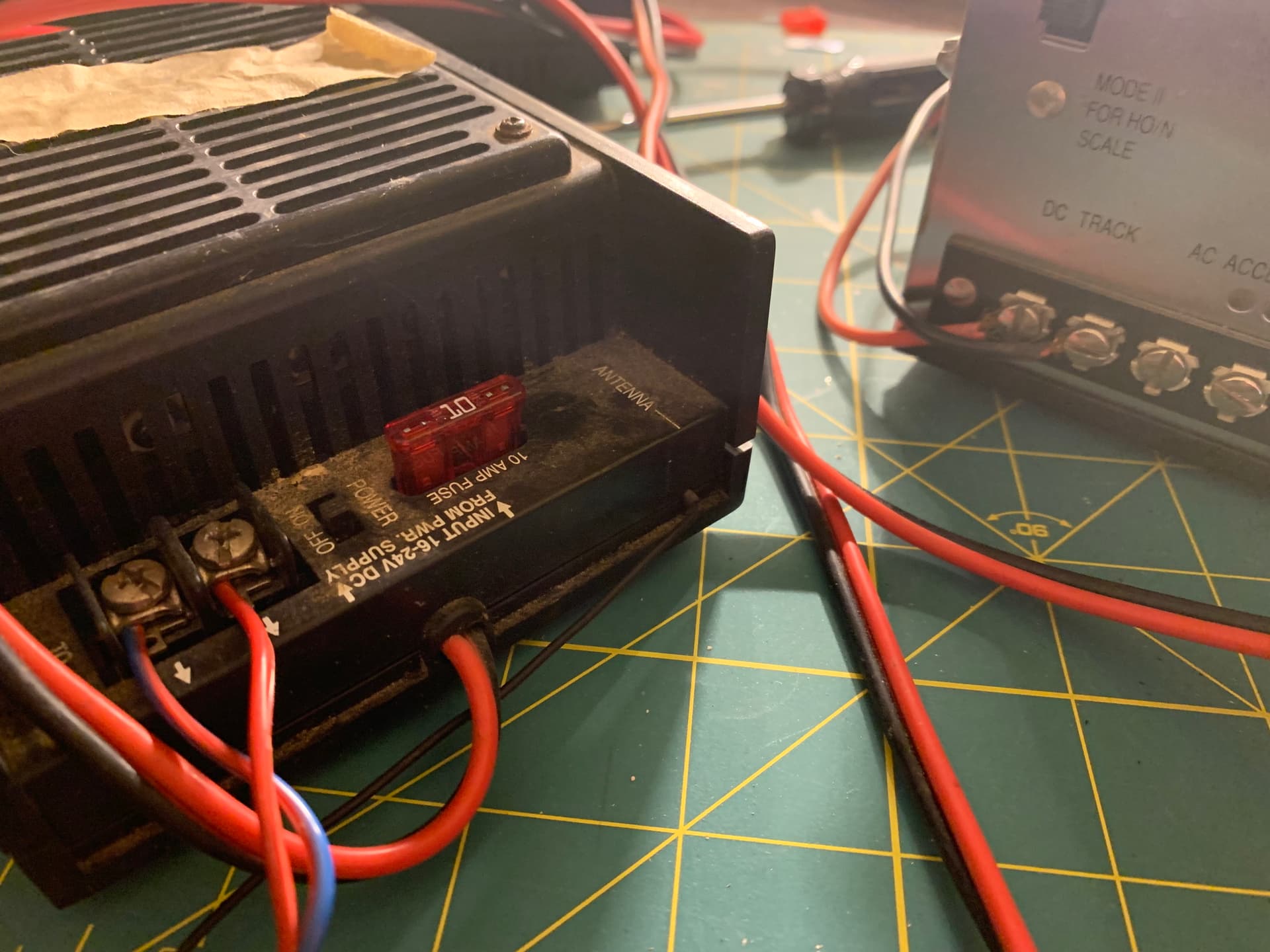

The TE is turned off and the picture really doesn’t show your wiring . I also thought you said that you had no output wires from the TE receiver.
Sorry. I tried it again and then tried with wires to track just in case
No difference when I turned on/off the unit

2…I looked up the MRC 6000 online and noticed there is a straight DC output on the back. Have you tried that?
3…Also the 6000 has a reversing loop feature on it and I don’t know if the switch is turned on or off or if it is even possible?
