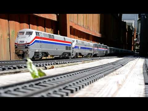

Duplicolor Acrylic Enamel Chrome Aluminum DA1684 is what I used on my F-40. That was as close as I could get to the Platinum Mist. Napa and most automotive parts stores carry it.
The Viewliner baggage was done with Rusteloum chrome.
Me personally considering what you are doing and the look you are after I would go with the Duplicolor but that’s your choice. As for the red nose you will have to decide for yourself on that one. You asked so I told?
