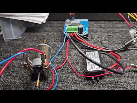

I just finished wiring up the Poor Man’s Throttle. It works great and is very easy to setup! It took me about 15 minutes to wire it up and test. I’m waiting for the battery to arrive today or tomorrow to convert one of my LGB Porters to this sweet item. Check out the video.

You prolly know this, Tim, but don’t forget to remove the brushes ,sliders and and any other things that pick up track power on the loco.
Of course! I’ve converted 5 of my LGB Moguls to Blunami / Battery already.
