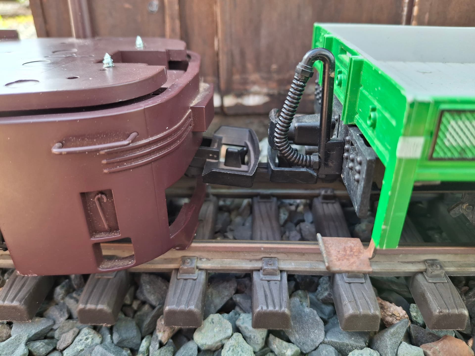

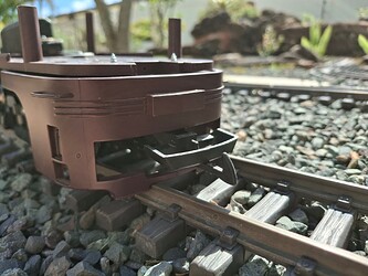

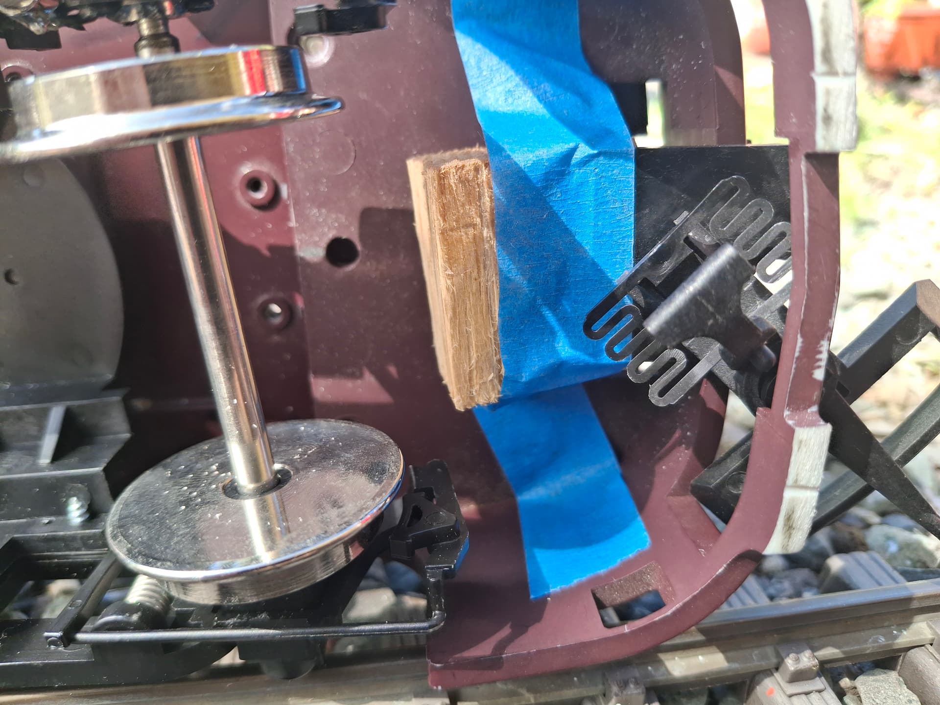

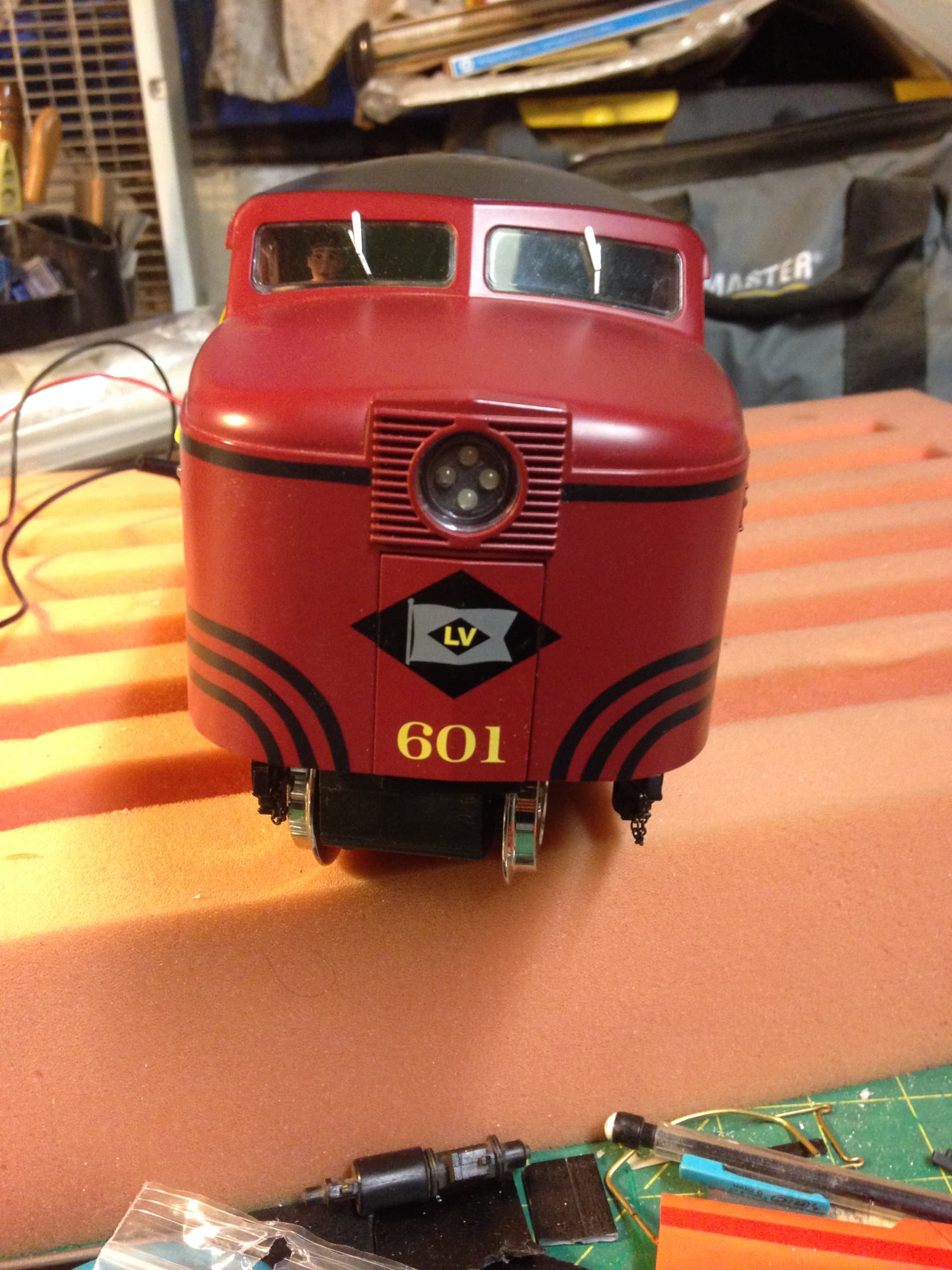

The coupler issue has been a real hold-up for Kid-zilla for about two weeks now. He had carefully crafted a block of wood to serve as a mount…
…only to forget to drill pilot holes and causing the thing to split! Kid-zilla being Hull #4 in the Mueller-class, he benefits from the fact I recognize when it is time to intervene to prevent catastrophic failure. In this case, it was the “failure” of a engineered solution to which he could not see an answer. Long and short, I got him to use some TiteBond III and a clamp to put his mount back together. Then, because moving things show progress more than static things, I had him take the chassis to the rails to test everything.

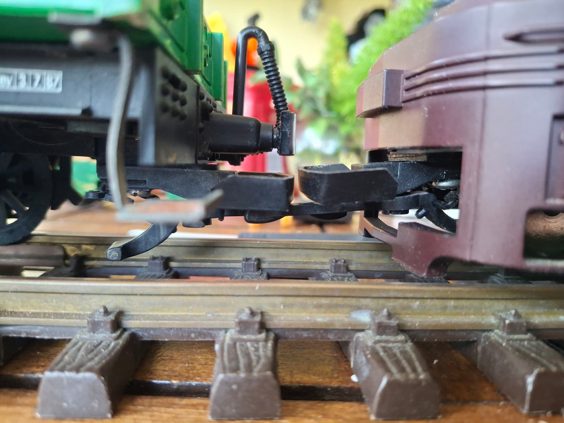

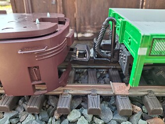

After he reconfirmed the rear coupler work, he 0-5-0’d the test car to the front, but…
…it didn’t align. This provided an opportunity to show him how to work with styrene (Careful, @ctown2 , he’s coming for you :nerd_face:) and liquid plastic glue to slowly build up his shim sheet by sheet. In the end, he got it, drilled the pilot holes, and mounted the forward coupler.
There was some more jiggling of shims and screws, but it’ll pull!

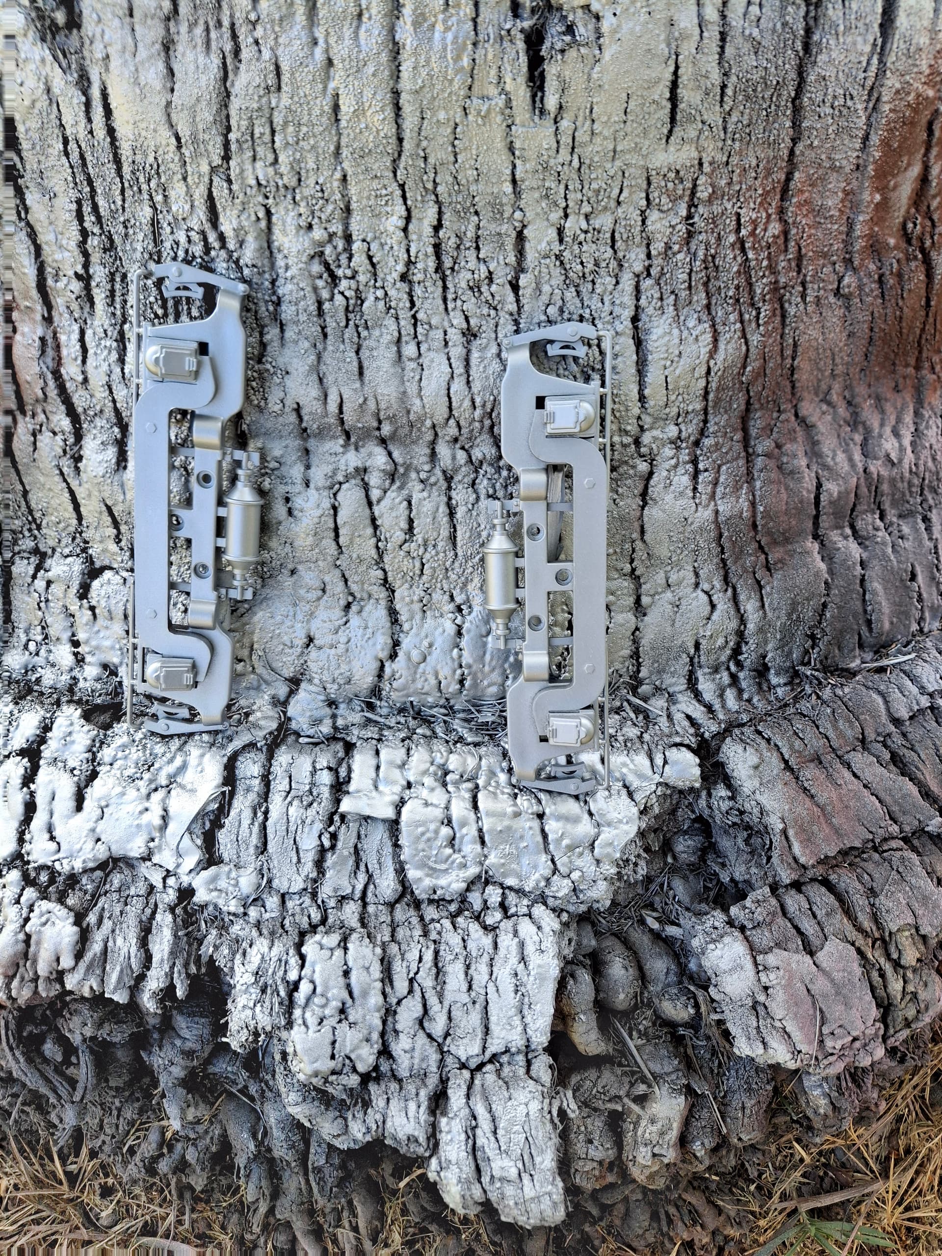

I knew he needed some more small victories, so it was off to the Palm of Spray Painting with the chassis and some of the sideframes.
Some hipster ants got a bit of flare as part of the effort.

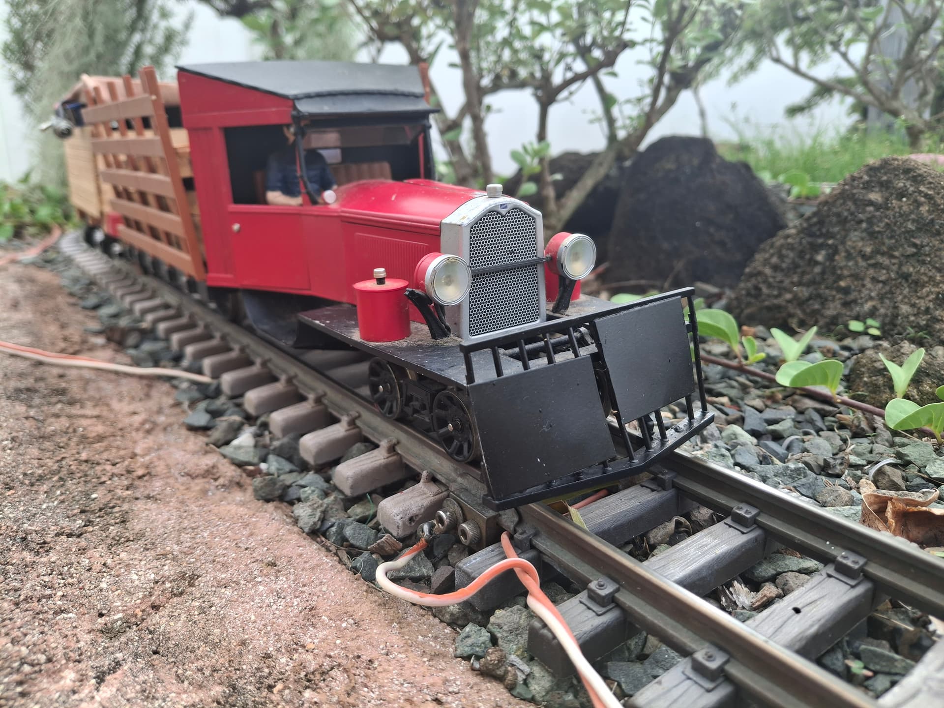

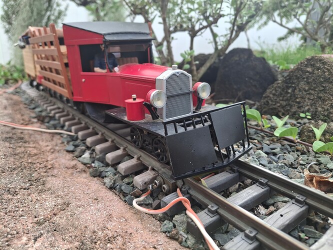

These feathers now in his cap, he was ready to tackle AM-Critter’s (Still working on a name, @Rooster !) body using Rooster’s rough template:
I showed Kid-zilla how to score and snap this stuff, whatever it is, and he soon had it tack to AM-Critter with contact cement.
Again, as rolling things motivate better than static things, power was applied to the rails (video). You’ll note the masking tape and empty window frames. I told him AM-Critter can get his silver paint as soon as the back wall is done.

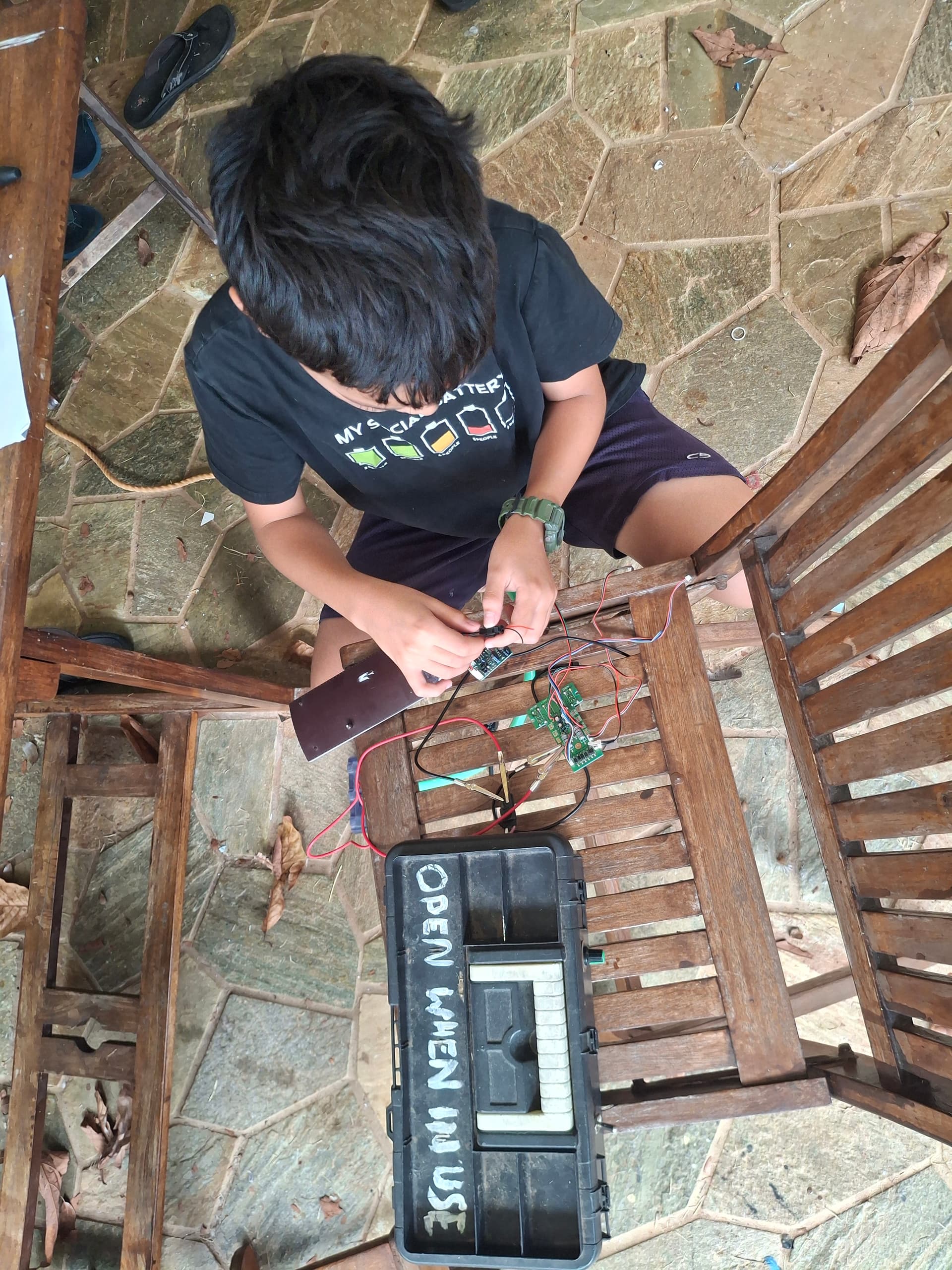

Somewhere over the weekend, we puttered with some electronics. Rooster had provided a smoke generator; I am sorry, but, courtesy of a recent reorganization of the bit-boxes, I do not recall who sent the sundry wires and boards with which we tinkered. Mea culpa, and thank you. My lack of consideration for the generosity of others aside, after I smoked an LED, we figured out how to give AM-critter lights and a smoke generator. As a consequence, Kid-zilla decided to leave off the screws that hold the roof in place. He is busily fashioning a piece of plastic to serve as the exhaust grill. The part caome from a box of “junk” Pete (@PeterT ) had sent along a couple years back. Now to figure out how to mount the smoke generator, lights and circuit boards…

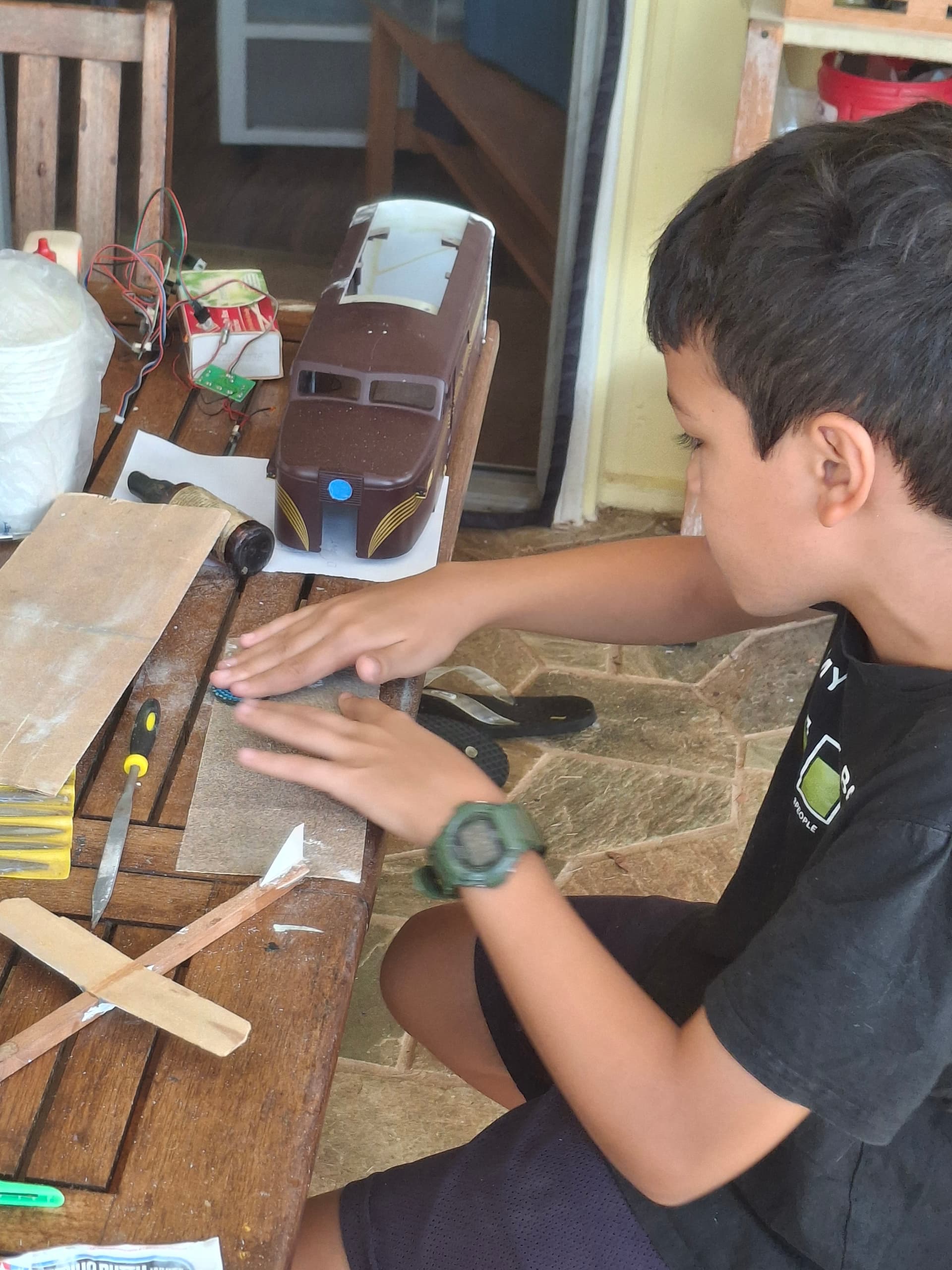

That, though, is in the future. The various small victories got Kid-zilla moving again, as the following candid shot of him smoothing the seem for the after bulkhead shows.
He’s been puttying and filing all day. This may be the last shot of this beast in Pennsy colors…

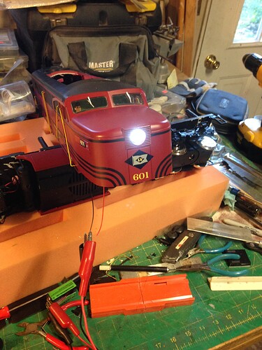

Guess I’m gonna have to dig out my unit so I can play along. There are four 3mm LEDS but I reverted to two 5mm ones. Either way they are just sitting in holes drilled for them out of the white 1/8" pvc board you have.
BTW …once again the material is marked PVC and Styrene. Styrene likes score and snap but PVC not so much.

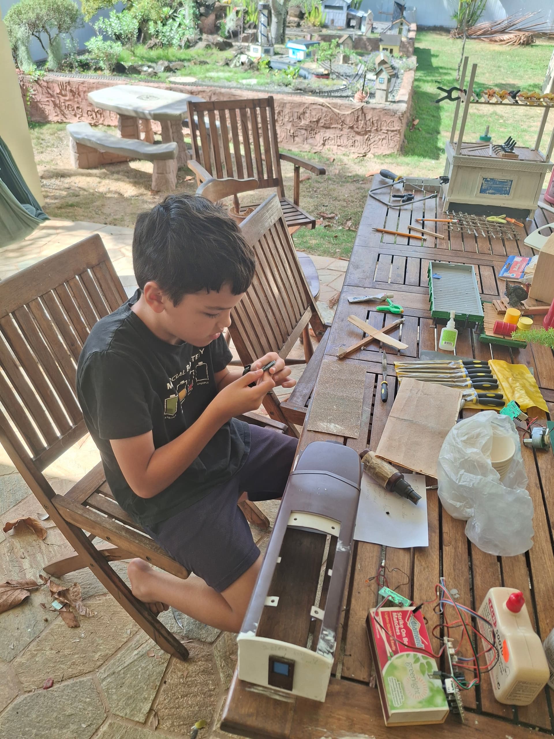

Update:
Progress in fits and starts…He is starting to see the end of the project, and he is learning that it only comes if you budget time to putter away at it. Estimating the time of each sub-step is a lifelong learning process, I imagine!

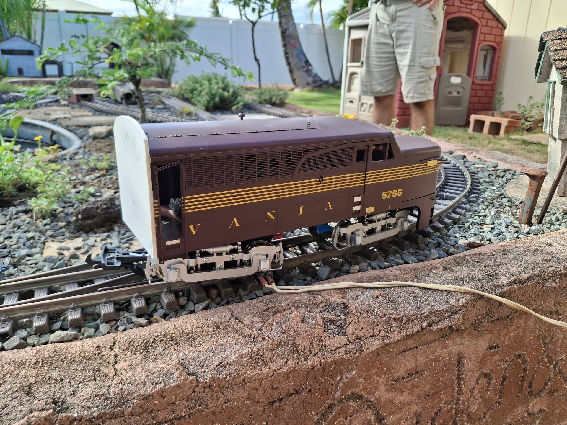

Over the course of last week he filled and sanded the seam between the new after bulkhead and the original locomotive shell. Along the way, he filed down that plastic bit to fit the curve of the roof.

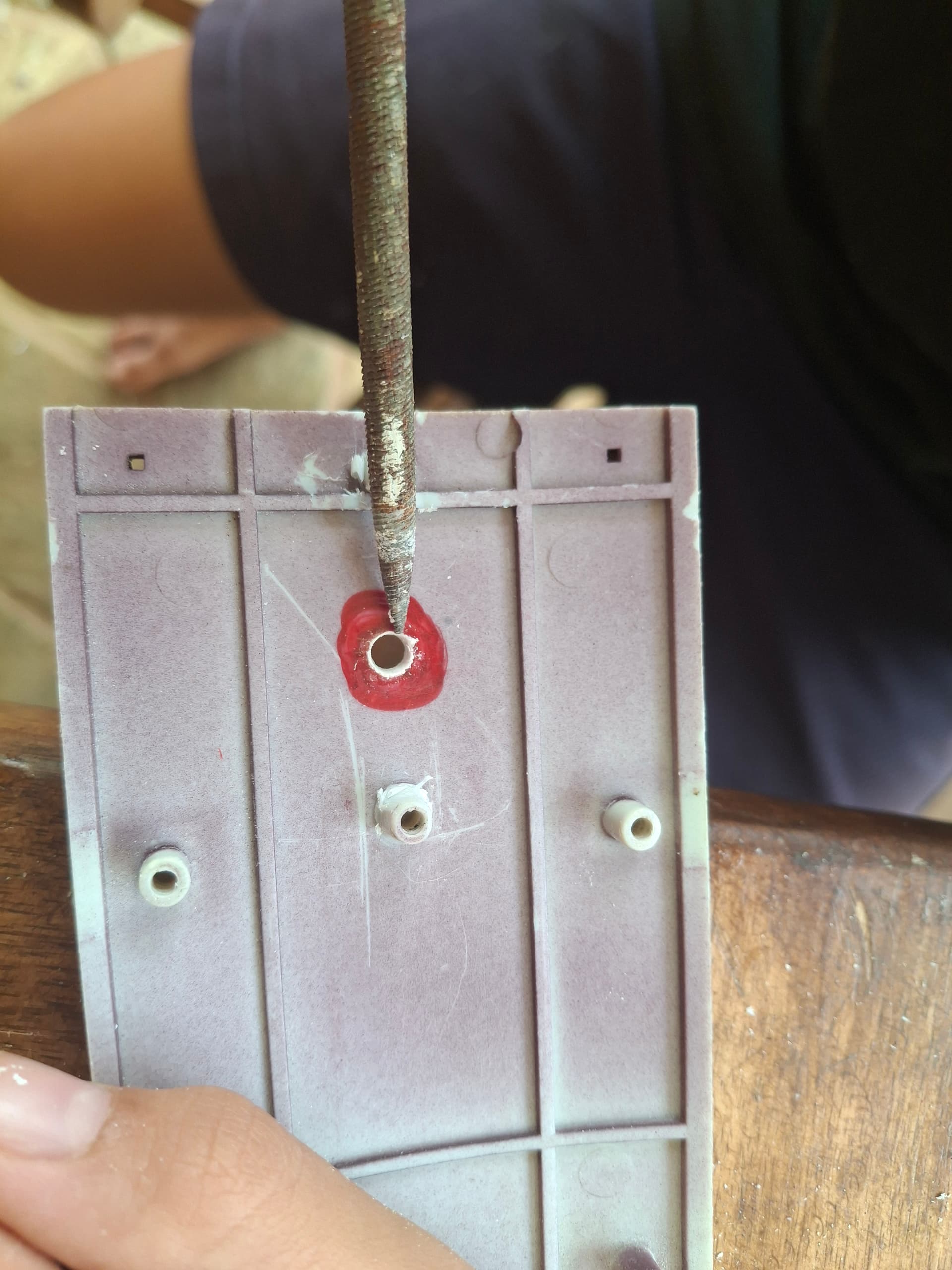

A good bit of the this weekend’s intermittent puttering involved mounting and testing…and retesting…and reretesting…the smoke generator. There were some plastic fittings that were for some long-lost function that served as mounts for the generator following some quick X-acto work by yours truly. These are just above and below the red dot that marks the location of the exhaust port.
The tests were because, well, making smoke is fun! We discussed the rest of the wiring, but there were other things to do this weekend.
I don’t think Kid-zilla sees how close to having AM-critter on the track he is, but I have to keep remining myself, “His project, his pace!”

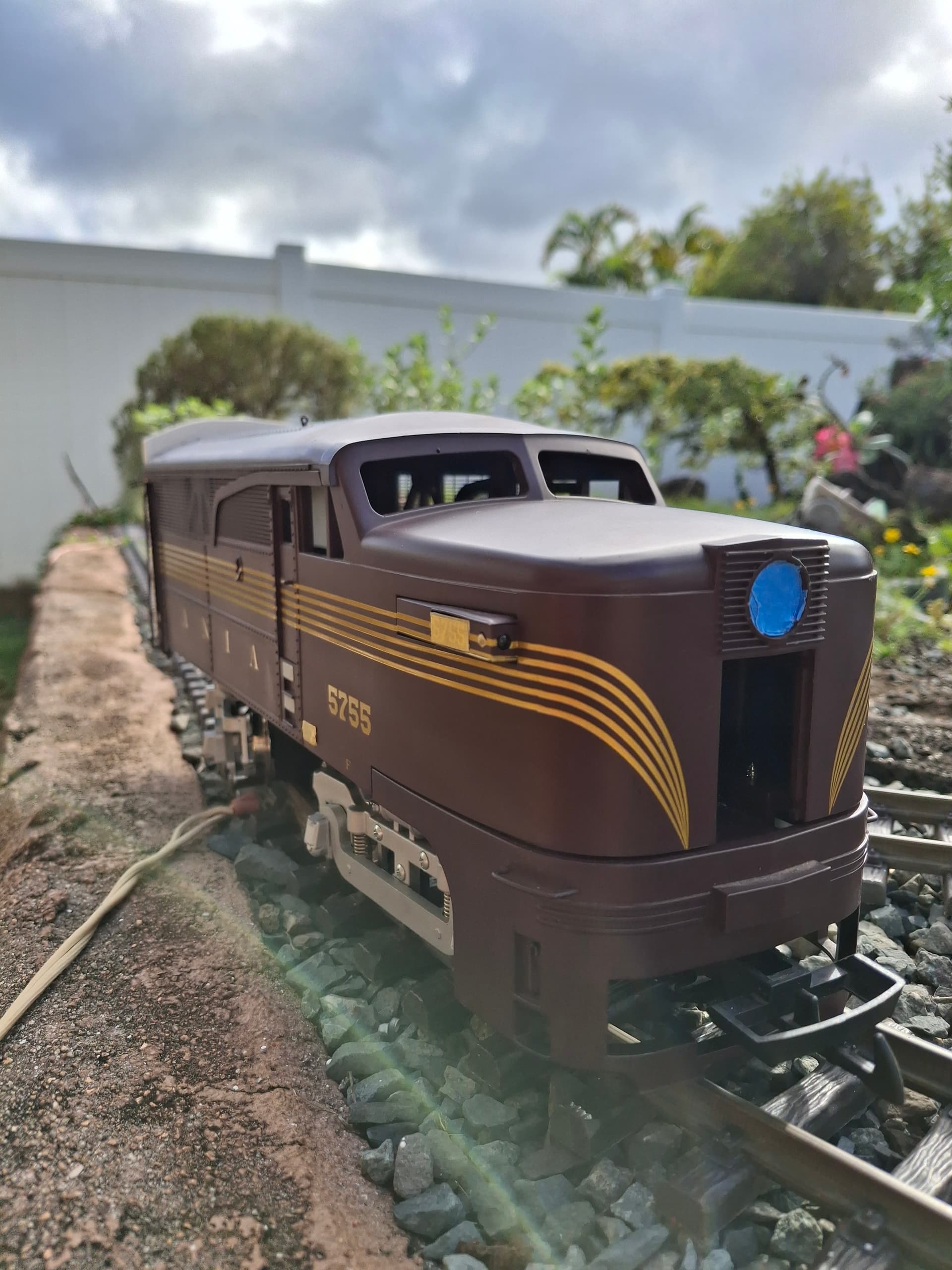

Thanksgiving weekend marks the Triple O’s “end of season.” All projects on the lanai need to be brought to a point that they can remain safely on the lanai despite Thanksgiving, Advent, and Christmas festivities. Each 1:1 modeler is allowed one project that reaches the finishing stages to remain on the lanai. Did AM-critter make the cut? Follow along!
First, in preparation for a diaphragm, Kid-zilla cut a platform and small roof over the after door, basing his work on @Rooster’s recent baggage car project ( Building and Bashing Amtrak Equipment).
He puttered with the lights and wiring, did some final sanding, and it was off to the Palm of Spray Painting.
He was impressed…no runs and no lost details!
And that brings us to the following:
I guess we should have primed this first to better obscure the old markings, but we both like the hidden sings of provenance!
He was shocked how a bit of paint can change what looks like a wreck into a model (something I’ve remarked upon before with my own projects)! He had to do a bit more filing and filling, which nothing like a good coat of paint reveals, but he got AM-Critter over the line. Let’s see what he can do between now and Christmas day!
